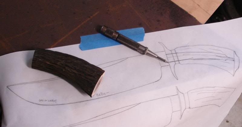

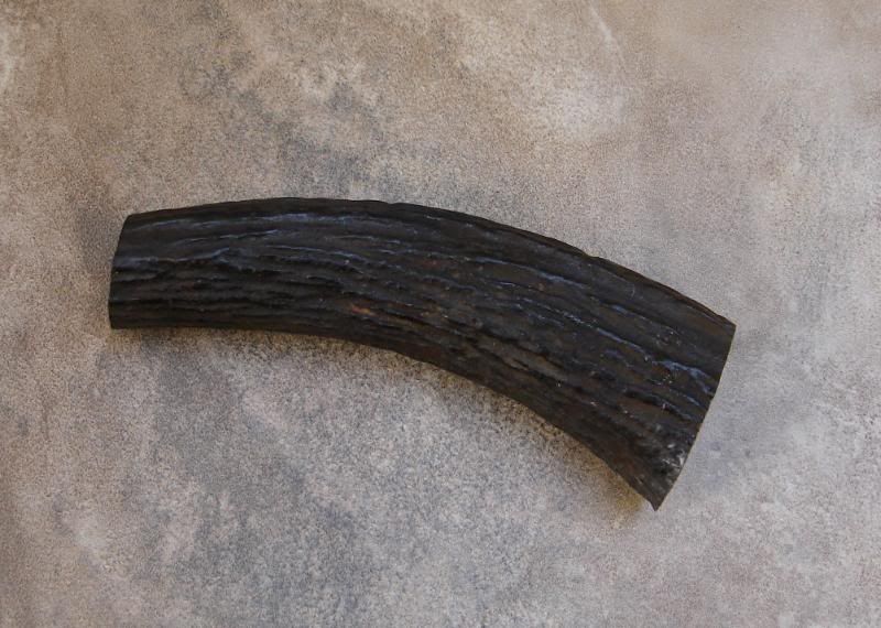

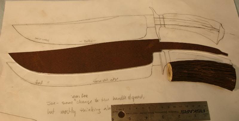

Joe's order date came around, and we talked by phone about what he wanted this time around. He'd thought about a hunter, but couldn't get away from his penchant for big blades." Did I have any stag for a big Bowie or Chopper," he asked?
I sent him this pic.
"That'll do. How about something in the 9 to 10 inch range?"

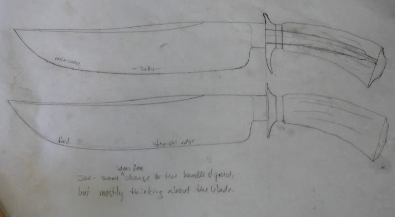

So I sent a drawing of three blades, with the stag as handle.
Joe said he liked the 10 inch chopper shape, but maybe with a little wider blade, and no fineal, so I sent a second drawing.
Joe preferred the version with the "belly", and asked for just maybe a sixteenth inch wider blade.With a little more discussion, we agreed on the main points, and I got started.

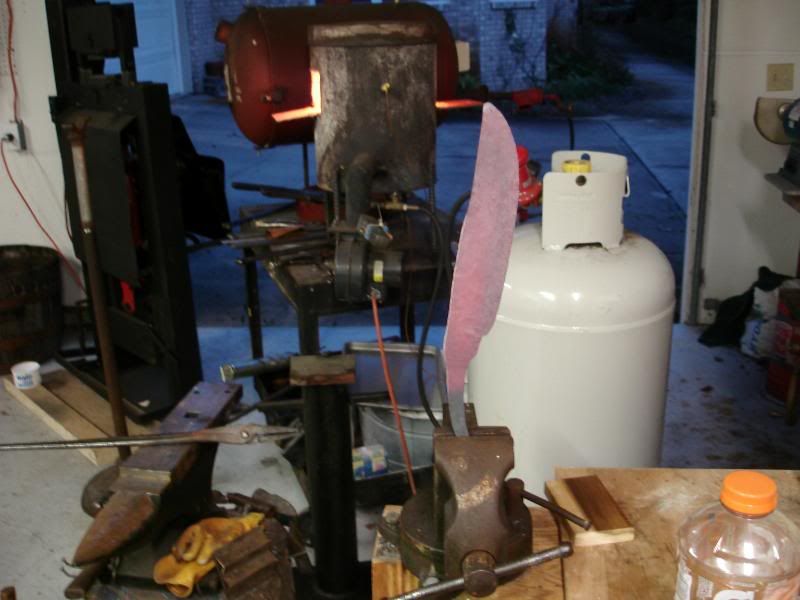

The first thing I do in building a knife is to use my drawing to center-punch the blade and tang shape onto some plate steel to make a forging pattern.
With a pattern to lay against the steel as I forge, the shape I've drawn out is much easier to achieve. It doesn't work to hold that red-hot blade up close to a paper drawing.....
I sent a photo of the pattern and final drawing to Joe.

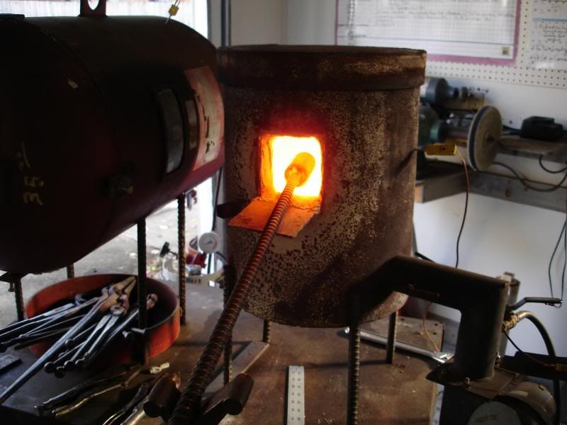

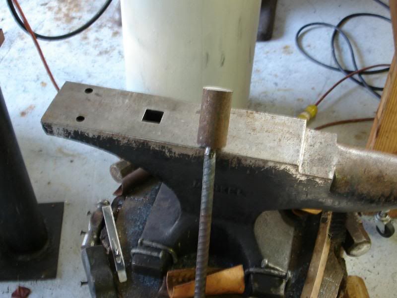

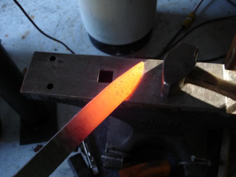

I figured about how much steel I'd need to be sure of getting a blade and tang forged, with maybe enough left over for a hunter, cut off 3 inches of 1 5/8 inch W-2 round bar,and welded it onto a re-bar handle. Better too much than too little, but that round bar takes some forging.
W-2 likes to be forged between 1700 and 1900 F, so I cranked the forge up to 1950 and set the billet inside.

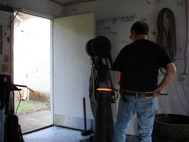

First thing is to flatten and draw the round bar out into a flat bar, about 1 1/2 by a tad over 1/4 inch. That's where my new Uncle Al's press really comes in handy.
Once the bar is drawn out, I begin the blade in the old-fashion way, forging a tip by hand on the anvil. Right here's where I can start to use the pattern, and continue throughout the forging of the blade.
Harvey Dean gave a demonstration ,at Old Washington, of forging with the power-hammer that really changed my work process, and has made it a lot easier on the old body. I work back and forth between the anvil and my little 25 # Meyer.

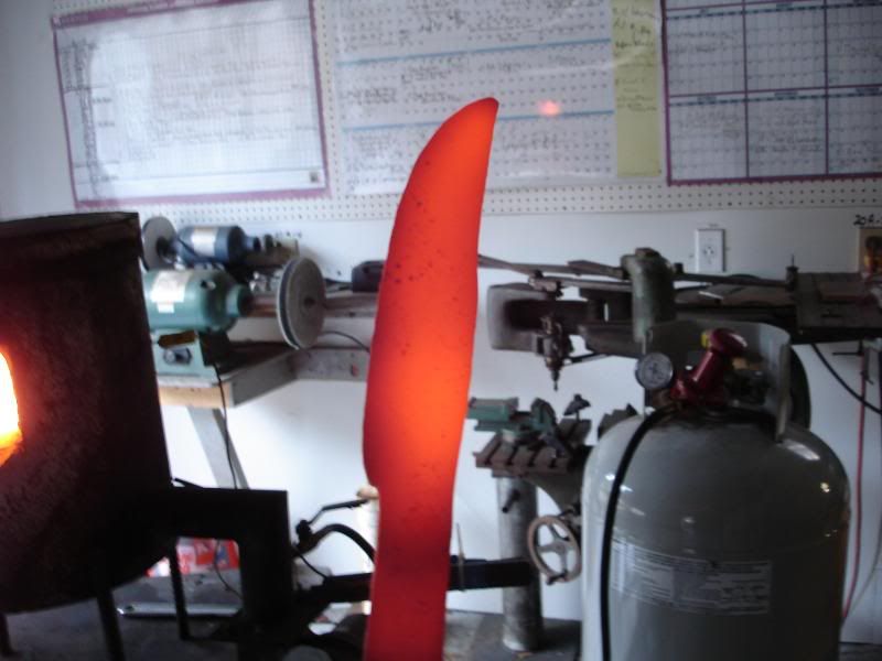

Using the pattern, I can forge the shape of the blade very close to profile, making sure I can re-produce the blade shape I'm after, with about 1/16th extra all around to grind off at profile time. That way, I can get rid of de-carb, and produce the shape Joe wants.
When the blade shape is finished to profile, with the bevels forged in, I hot-cut the bar about 1 1/2 inches behind the ricasso, and forge out the tang. The pattern helps me get the tang where I'll want it to fit the stag, and I'll taper it as well.
The last thing I'll do today is a "forge normalize", by heating the forging to non-magnetic, and letting it air-cool. I don't like to leave all the stresses in the forged blade over-night, but tomorrow I'll use the digital oven to give a more precise normalize/heat cycle/anneal treatment.

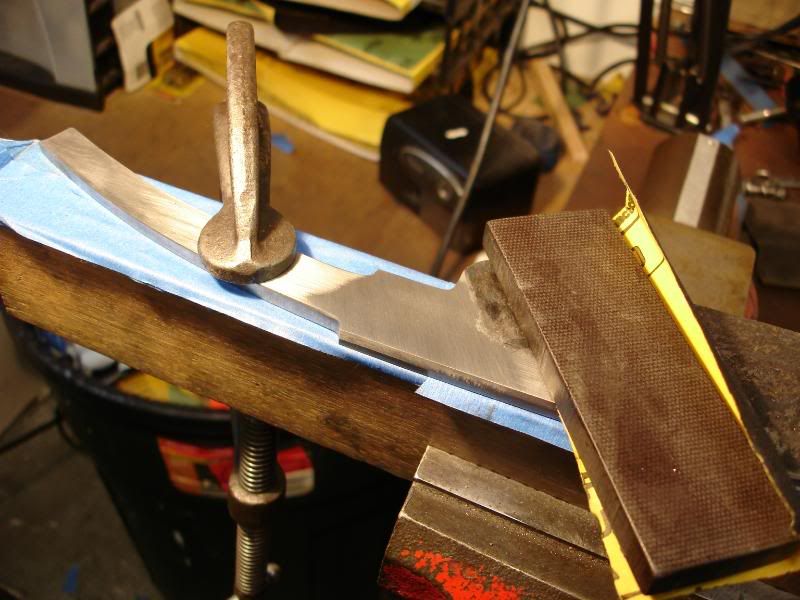

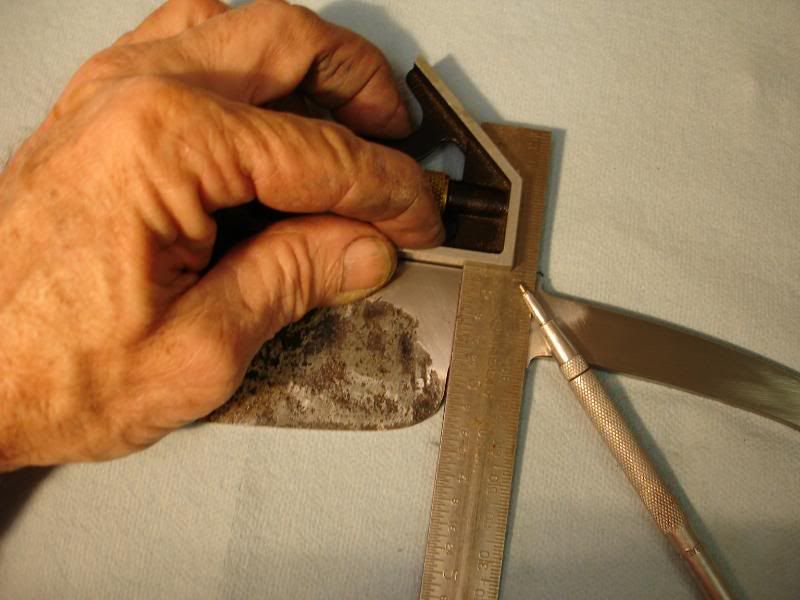

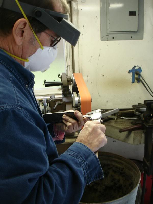

And, on the BMG flat platen, using my dial caliper, grind the ricasso area parallel with a 50 grit belt. I'll also knock off any "bulges" from the distal taper of the blade. Then I'll follow up on the ricasso with 120 and 220 belts.
Now I'll hand sand the ricasso area to 220 grit. You may notice I've roughed in the facets on the spine with the three grits on the flat platen, as well as having sanded the forge-tapered tang.

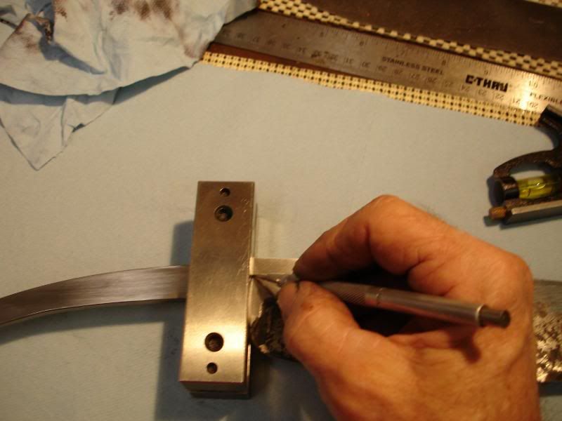

I'll mark a vertical line for my grind line,
and transfer it to both sides with one of John Perry's fine shoulder filing fixtures.

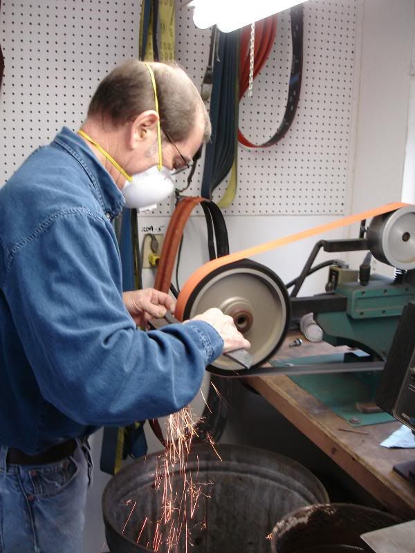

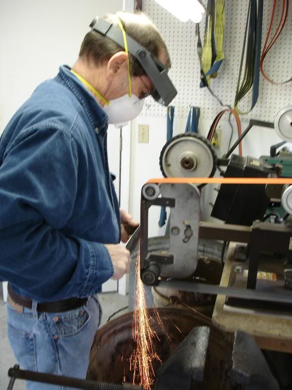

This forging is ready to rough-grind with a new 50 grit Norton ceramic belt.
I'm grinding free-hand, with a push-stick in one hand, edge up, sliding the blade across under the push stick. I'll switch sides and hands, and grind evenly on each side as I go, so as not to set up new stresses in my annealed blade.
Wheew...that's enough for right now.
Grinding's one of the high stress steps. Here's a place you can mess up all your work with one slip.....
