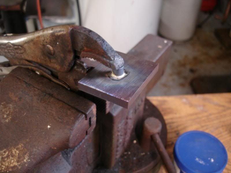

With the blade finished out, and the shoulders cut, its ready for the fittings and handle. If you'll notice on the finished blade pic, I've filed about a five thousandths shoulder across the wide side of the tang. With any other fitting material, I usually file the top and bottom only, and file to a press fit, but stainless tends to squeeze open, so I fit to the filed down tang, and let the shoulder cover all round.
Lets start out with the JW surface grinder and face some metal. (this pic is actually the damascus for the collar, but I'll sand the guard smooth, and polish to 1000 g also)

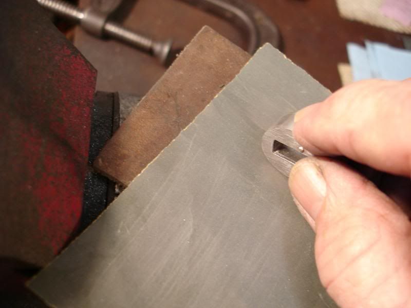

With the face of the 3/8 s/s guard buffed to a mirror finish, I'll mark the slot with a carbide scribe, and mill to within about 3-4 thousandths fitting.

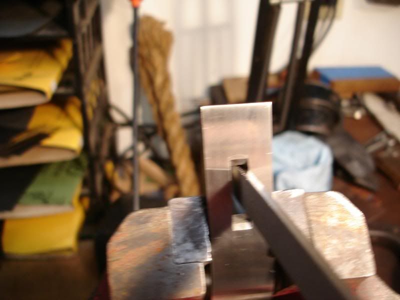

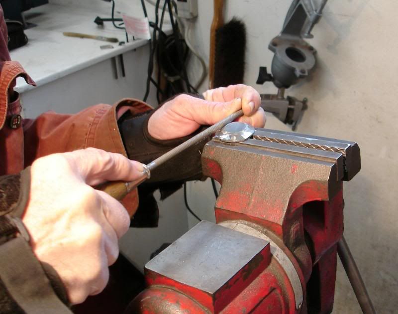

Final fitting to a press fit is with a mill file with one "safed" side. In the mirror, I can see that I'm keeping the file square to the face.

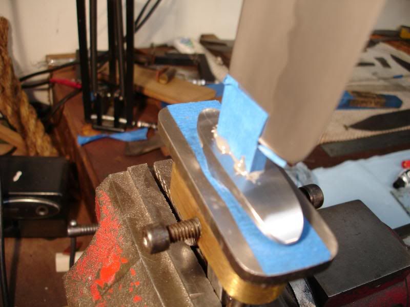

I can grind the bottom curve on the work platen,
and forge a forward curve on top, after relieving the after face.Why didn't I just clamp that thing in the vise, and just heat the tip with a torch? Oh, well....

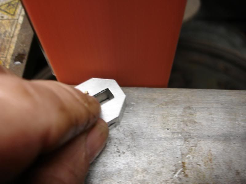

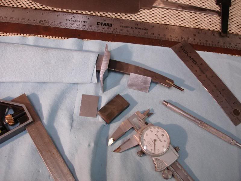

With the roughed out guard fitted, I'll cut a pair of .040 s/s spacers, for later file-work, and a piece of twist damascus for a collar.

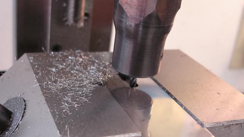

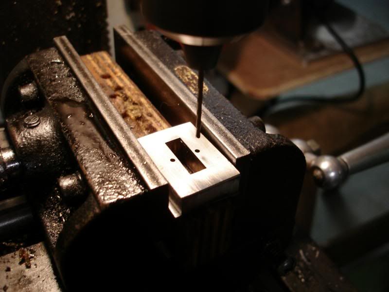

If you'll refer back to the pic of my playing like my platen is a surface grinder,imagine my checking the thickness with the dial caliper, and further imagine another pic of mill-slotting spacers and collar, we'll move to drilling 1/16th" holes for alignment pins through the spacers and collar.
I can mill the slots on spacers and collar a bit loose, drill the collar, then drop the first spacer onto the tang to fit up against the guard, put on drops of superglue, drop on the collar, remove and back drill, and so on. By the time all three are drilled, the assembly will fit tight, and can be shaped as a unit.

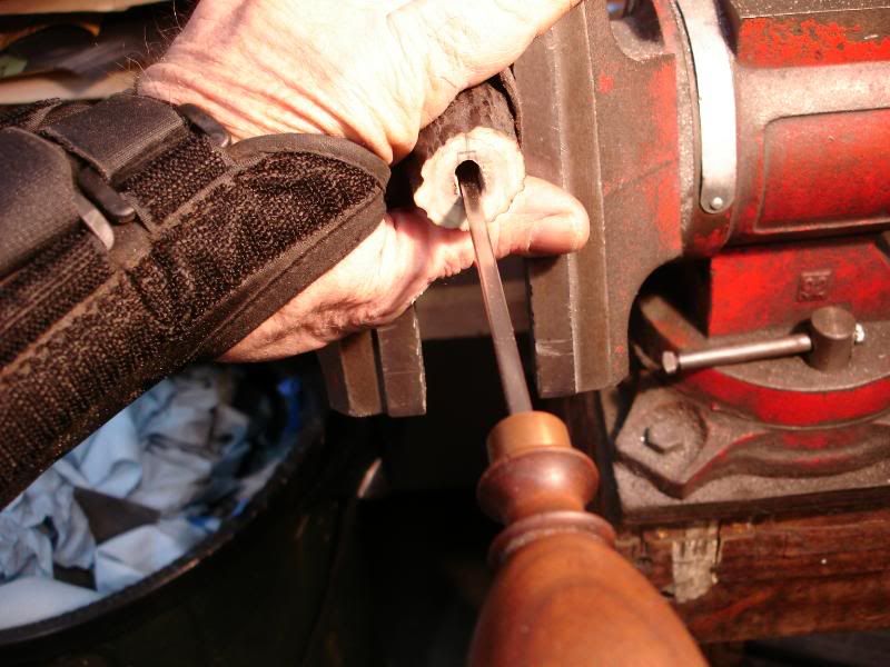

Fitting the stag starts with drilling some 3/16ths" holes and broaching a slot with my wonderful John Perry broach.

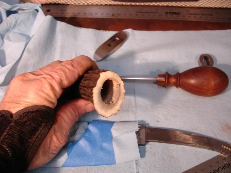

The butt end of the stag handle is cleaned of all the soft pith. This big chopper needs the cavity cleaned out to the hard part, and filled with epoxy and colloidal silica, to withstand heavy impacts. ( same goes for all stag handles, for that matter.)

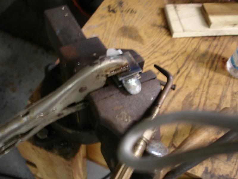

Next, I'll silver-solder a nut to a piece of s/s for the butt-cap.

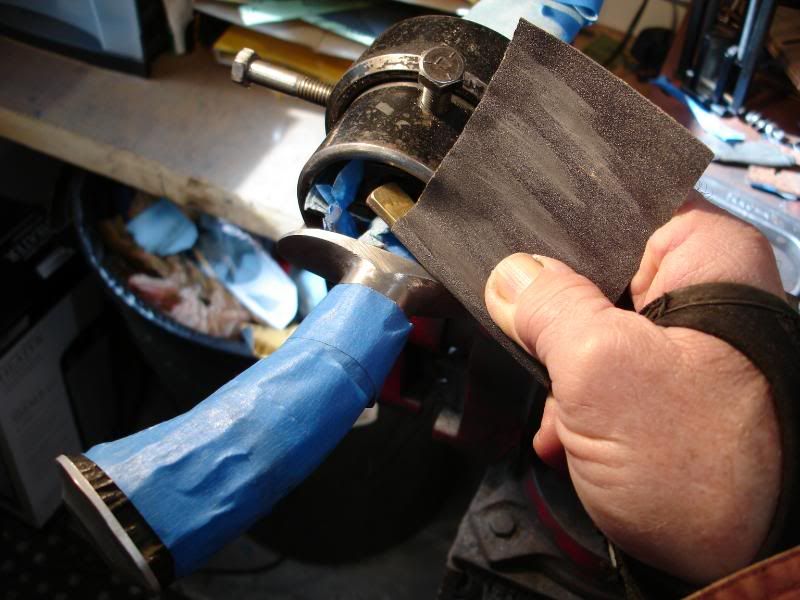

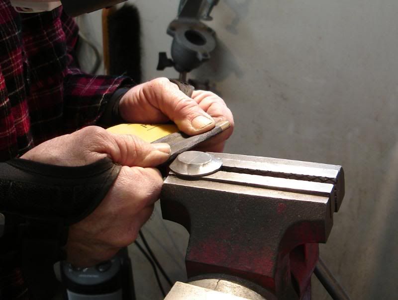

Chain-saw files, mill files, sandpaper wrapped around brass strips, leather pieces, and sandpaper on flat surfaces, its all fair game in finishing.

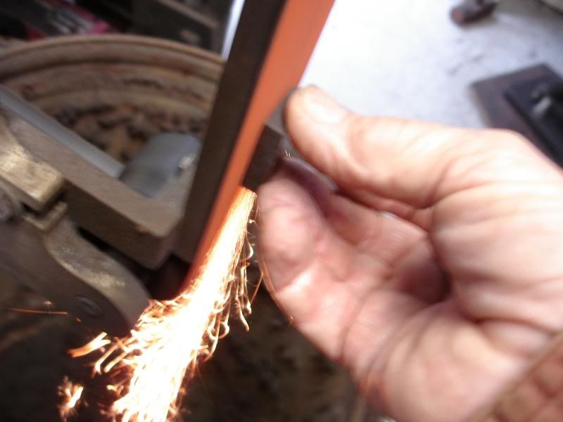

Roughing out the butt-cap starts with knocking off the corner on the grinder, and then comes the hand filing.

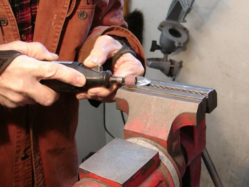

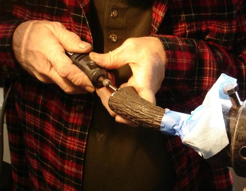

A Dremel tool with a tiny drum helps shape the concave border.
Then its back to the sandpaper, up to 1000 grit.

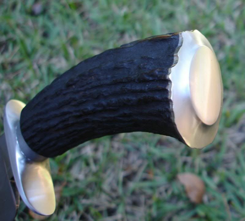

Now comes the most important part....This puppy's off to Paul Long for a magnificent sheath, then to Coop for a family portrait, and then Joe will finally get to go chop down that tree...Wait, its already past Christmas!
