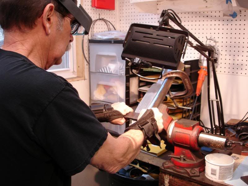

In the last session, I'd rough-ground the profiled blade with a new 50 grit belt. I then went over the rough grind with a new 120 grit belt. When you're grinding a blade, you need to use sharp new belts so they'll cut cleanly, rather than "polish the bumps."
At this point, my edge is normally about .035, and I'd be ready to heat treat. Because this is going to be a clay-hardened, hamon seeking blade, I'll clean up my grind lines, go over the blade with a new 220 grit belt, and hand sand to 220 grit, wet/dry paper. My edge gets down a bit less than .030

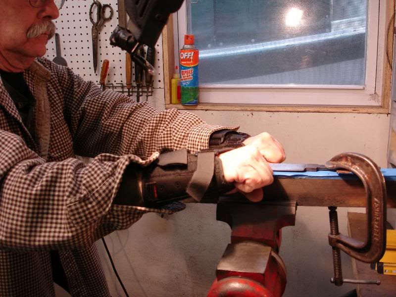

I hand sand with a 3/8x1 1/4x9 inch piece of Micarta, and 3-M Imperial grit paper. With the back-up board at about 45 degrees, I can really lean into the blade. ( Note the two wrist guards for double carpel tunnel syndrome)

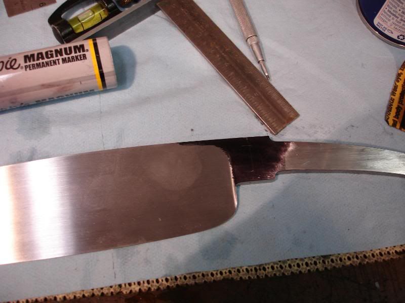

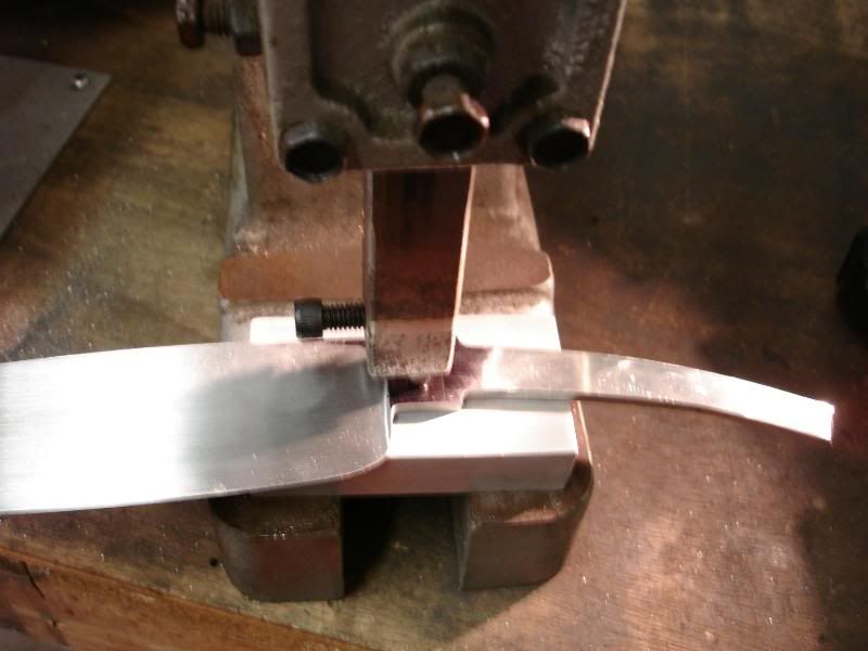

With the blade at 220 grit, I'll use Magic marker to blacken the ricasso, and carefully mark for stamping my name.
Then I'll stamp my name using a hand press to hold the stamp for a couple hard blows.
I'll hand sand the ricasso as before with 220 grit to remove the squeezed up "lips" around my name, and do the same process on the reverse side for the MS stamp. This blade's ready to harden.

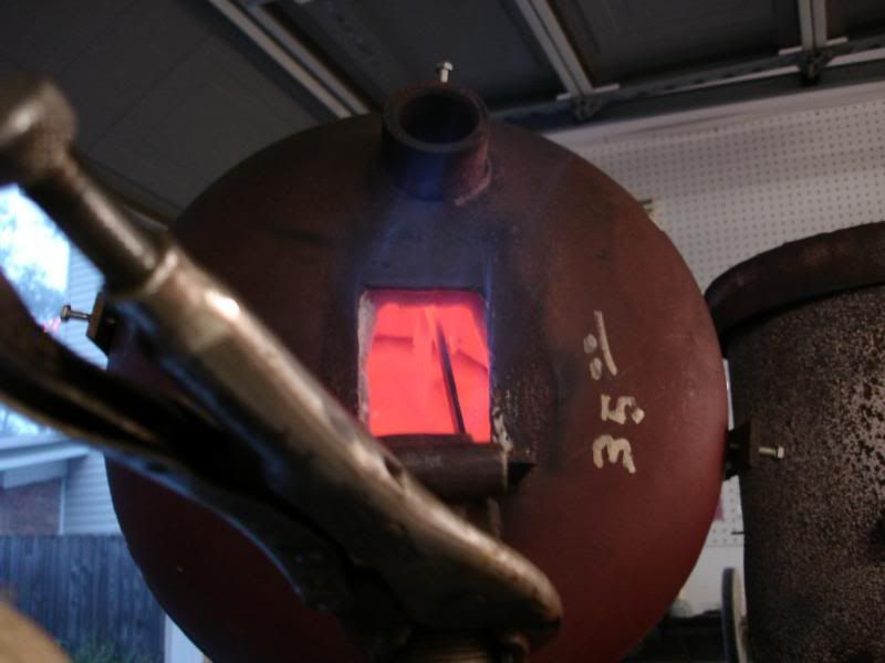

W-2 wants to harden somewhere between 1425 and 1500 F, and this'll need to soak for 5-10 minutes, so I tack -weld the tang to a 1/8 " strip of mild steel, so I can clamp it in my heat-treat forge.

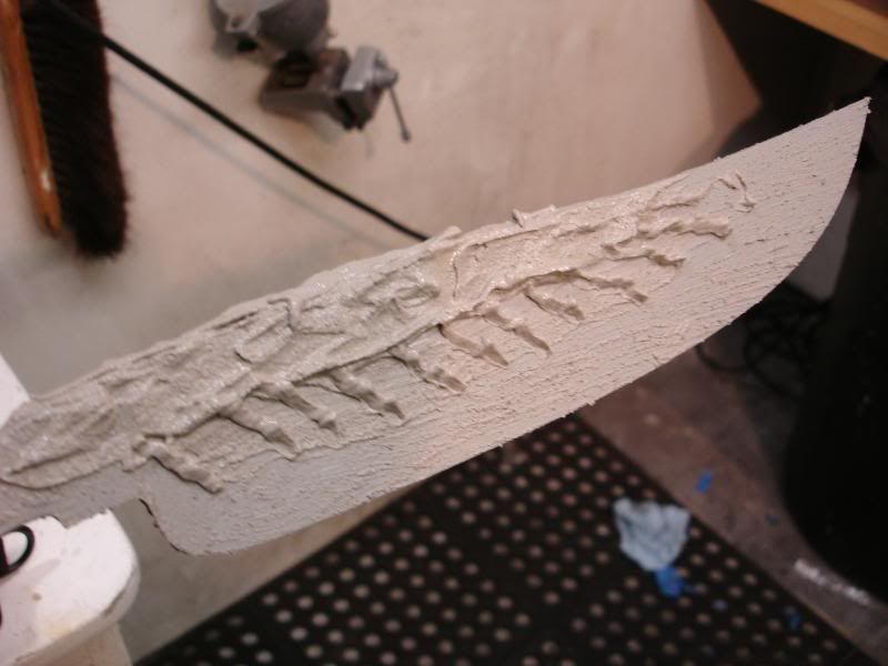

Now comes the fun part. I wash the blade with a thin wash of Satinite with a bit of boric acid mixed in. The boric melts first, and it and the Satinite protect the blade from de-carb and scaling.
The hamon is (hopefully) produced by the thicker Satinite applied in a pattern down the spine, and onto the blade.

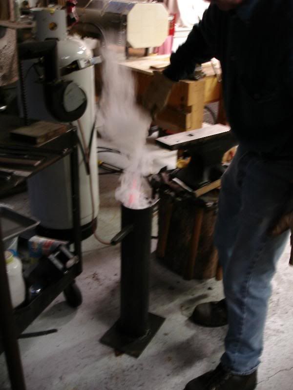

I made a "Don Fogg" type heat treat drum forge, that I can run at constant "low" temps, using one of Darren Ellis' atmospheric burners. I have a thermocouple in the forge, and it controls very well.
If you look closely into the forge, you can see that the ricasso is almost up to the temp of the blade and tang. When the blade is at an even color, and the forge is running at the desired temp, I'll let it soak for about 8 or so minutes.
Here's the pay-off. I plunge the blade tip first into "room temp" Parks 50 heat-treating oil. I move the blade up and down for a three sec count; out of the oil for three sec; then back in to continue cooling, still moving the blade up and down.
What has happened in this sequence is, the cutting edge, and about half the rest of the blade (that's not covered by thicker clay,) drops from hardening temp to around 800 degrees in less than a second. In about three seconds, that part's down to probably 600, but the heavy clay has held heat, and slowed the spine's cooling.
The spine therefore won't harden, won't form martinsite, but the exposed parts, having gotten "below the nose" in less than a second, will fully harden as the temperature gets lower. The three seconds out of the oil slows down the cooling in the edge, to reduce the strains between the two parts, then back in it goes to continue cooling at a reduced rate.
I'll then take the blade out, let cool to about 120 degrees or less in air, and temper in the digital oven at 450 degrees, for two, one hour cycles.

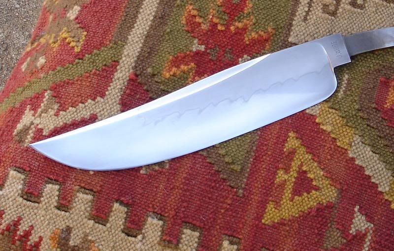

Well, it's Christmas eve, rainy and cool, let's open up the hamon, and see what Santa brought.
The blade has been clay-hardened and tempered. I scrubbed the Satinite off with a brass wire brush before tempering, and it comes pretty clean. Now I'll go over it again with 220 grit, wet sanding with water.

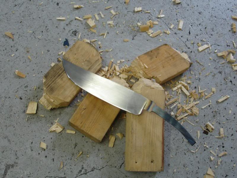

I'm confident of my heat-treatment, using temp controls, and "semi-industrial" methods, but I'll always want to check my edge geometry. Too thin will chip under hard use, and too thick don't cut easy.
Don't chip...
Cuts easy. This is one of the fun parts.
Let me just stick this photo back in. There's about a full day of work in this and the next photo. I'll pick up with wet sanding with 320, 400, 600, 800, and 1000 grit paper. One grit goes vertically, the next at about 30 degrees off, and so on, so I can see that all the scratches from each grit are completely removed. Also, between each grit, I change the water in my cup, and replace the blue tape on my sanding support. Nothing like a big old 320 chunk scratchung up the 800 grit finish.
Here's a posed photo. For some reason I didn't get one of shaping the clip. I do this the hard way, since I want a variable angle clip( for looks??) and can't quite get what I want with a jig. I'll rough it in on the platen, and then draw-file it exactly to scribed lines. Draw-filing, with the handle in your left hand, moves a lot of steel in a hurry. The clip is then sanded to 1000 g .

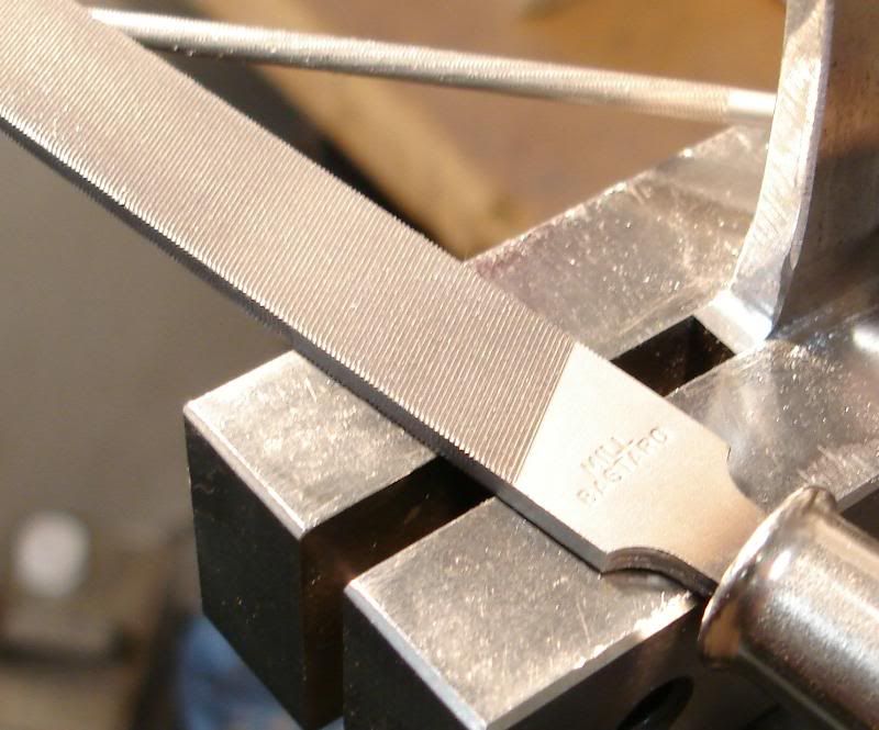

Last thing before etching, I'll file the shoulders with J.P.'s filing jig. I'll file a radius with a 1/8 inch chain-saw file, and the flat with a mill bastard.

Now were're ready to etch this puppy, after all this effort.
I'll clean the blade THOROUGHLY, with original 409, and dry with new Scott towels. Then etch in ferric chloride for about 8 seconds.
Wow, look at that!!... Actually, I'm cheating here, this look develops after several cycles of etching, polishing with semi-chrome, cleaning, re-etching, polishing, etc. Repeat 'till you're satisfied, or too tired to do anymore.
Here's your reward, (or punishment, as may be)
