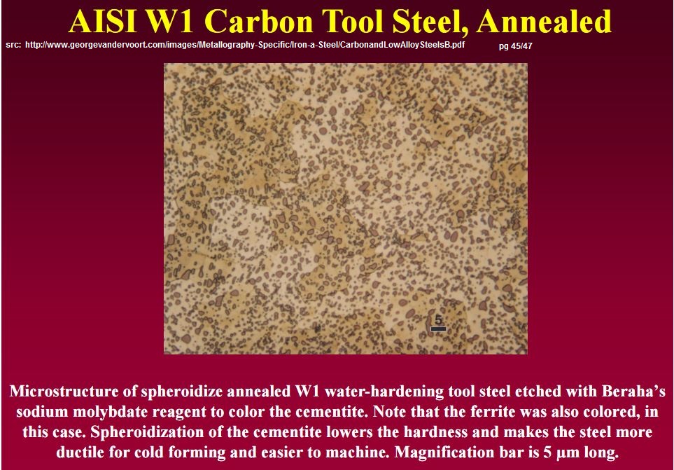

W1 coarse spheroidized
Beautiful image Bluntcut!! Thank you
Looking at the picture it appears clearly that from that condition a simple go at austenitizing temperature without a significant soak it's not gonna move that carbon.
Do you also have a picture of the same steel after a normalization, with the same scale for comparing the carbide condition?

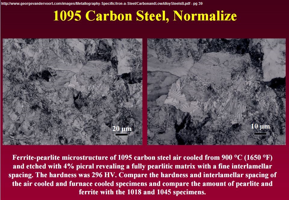

I didn't find micrograph for normalized W1. However normalized W1/W2 looks similar to 1095;52100 normalized, except smaller grain.

Luong, thank you for the link to the image of the W1. I enjoyed reading thru that site yesterday. Interesting to me...comparing the W1 picture of spheroidized cementite to the 1095 pearlite. Note that the W1 image was etched to reveal, primarily, the cementite carbides, but some of the ferrite structure was revealed in that etch as well, a faint brownish color behind the cementite. However compare that image to the 1095 image. The 1095 image apparently was etched to only show the pearlite, but the carbide network is not discernible (as far as I can tell).
