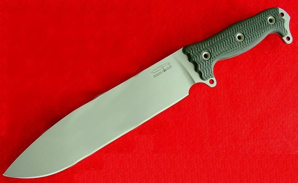

Skunk has been receiving lots of requests for such a knife, so, let's get all Nessmukian here and help design an updated version of the ultimate woodcraft knife. . . .
We don't want drawings as much as we would like to see if there is some consensus on what you guys would like to see in such a knife. . . .
Thickness?. . . . With guard or without guard?. . . Handle material?. . . Blade finish?. . . . etc. . . etc. . . .

If you take the ASH-1 and strech it out to a ~10" blade that would work for me.
You can call is an SHBM.

Thickness?
Slicer. 3/16" at most.
I like a guard, but the handle curve plus the traditional Busse talon hole would be plenty (like the BAIII). I think this is where some woodcraft blades fall a little short. No one needs to be thinking about stitches out in the wilderness.
Handle material?
Micarta! I want it tough enough that I don't have to baby it.
Blade finish?
Double cut or satin.
As for design, I'm up for anything from a Game Warden Extended to a tried-and-true Nessmuk design. 4 to 5 inches max blade length.
Satin at .140 to .150
Smaller ABA! or close. With the straight handle. Not sure if you could make enough of those though...the whole world would want it!!!
Rounded like GW butt also.
3/16" Thick, 4.5" blade, 5.5" handle (includes chisel/scraper shaped pommel/skullcrusher) w/ integral fingerguard/choil. Grooved thumb-ramp. Offered in DC and Satin, and Snakeskin Nukarta as well as all those awesome G-10 mixes need to be available.

That about sums it up, +1 on Guyon's post... Full height grind, something like a short DABA without the Desert coating, maybe with a li'l recurve to the blade? 0h, and snakeskin micarta handles would ROCK.
As above DABA without coating (satin or DC maybe), green linen or snakeskin would seem to suit well.
As mentioned above, something with a slim profile that can be manipulated between the fingers to work with wood rather than a hefty chopper. Almost like a Busse take on the Alan Wood / Ray Mears woodlore knife would be my preference.
Something small enough to be on you all the time in the woods, let large enough to handle some work :)
I would say that the ideal woodcraft knife would be a 0.15 inch thick SHBA. An Anorexic SHBA if you will. Call it the ASHBAT.The thinner stock is necessary. Give it a Birds Beak :thumbup:
For me it would be a flat ground Ratmandu in INFI. I love the design and that handle in G10 rocks.
Cobalt is close. Boss HOG, send me some INFI and I'll test out my new grinder, you never know what might evolve!!!! :eek: I'll make it close to the "SweetHeart" size. It will probably have birds beak bottle opener on the end to help quench the thirst of a hard day of "Woodcrafting".
Something like this:
-THIN blade (anorexic or leaner)
-Small guard if one at all . . . but there has to be a talon hole somewhere, right? I would stay clear of the Nick style guard though . . . I like the blade being close to the handle lines for a bushcraft knife
-Handle: Micarta, g-10, Teak, Cocobola (sp?), or other very durable handle material.
-Finish: DC or Satin. Don't coat it with anything!!!
Blade: would a Scandi grind be possible (depending on the thickness of the blade of course)?
Edit: the blade shouldn't be longer than 5". 4" or so would be ideal. And if it's a bushcraft knife, it really shouldn't be too wide of a blade. 1" or so tops.
