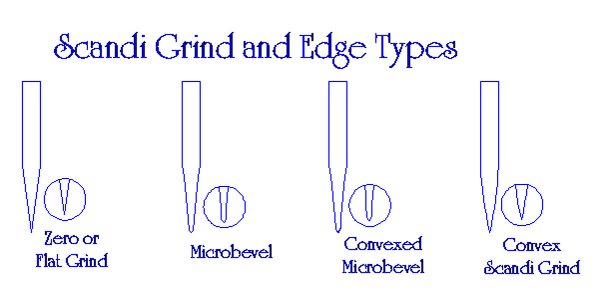

I think the problem is being too thin. Hardness does not seem to be an issue.
In testing, I'm at .010/ 011 edge thickness and 30 degrees inclusive and had no problems with oak this morning (day 3). I've been "sneaking up" on the edge thickness about 3-4 thou per day and experienced chipping on the stock blade and the first two days. We'd like to keep the edge as thin as possible and still be able to carve hard wood. We're also assuming one knows how to carve wood.
Last I read, Yab was at about 7 thou? and cutting ok?
sal
A microbevel will probably take care of this. I've got thinner knives in D2 and they incurred worse damage with similar usage, but a small microbevel took care of it easily.

Yep. I left it at 7 thousands, and 20° included, although I'd have to take that up to 30° or higher for hardwoods. I've used it for all the rough shaping on the same block of basswood that trashed it the first time.

Just so you will know, the factory edge on the Nilakka was about 5° per side for a total of 10° included angle, not 10° per side. My previous experiences as well as this one tell me that is straight razor territory.

It is a beautiful knife, and I really enjoy using it. But when the edge of a $200 knife can't stand up as well as that of a $0.34 single edge razor blade, I think that is a problem that needs to be addressed.
Would a chisel ground blade work better on this knife? I'm serious.
Thanks for all the positive comments. This folder is a great design.
Define "better". Not being a chef, I personally find chisel grinds simply annoying on anything but a wood chisel.
I do appreciate the discussion and this being brought to light. I put a small bevel on mine almost before I cut a thing thanks to this thread. Saving me lots of trouble, so thank you.
I also pulled off the clip and sanded the sharp corners off of the hole under the clip so it would go in and out of the pocket nicely. That sharp corner was hanging up on the way in and out of my pocket.
Are not Scandi grinds chisel grinds and Scandis excel at cutting wood, no?
Not an expert but pretty sure chisel = flat on one side and angled on the other, whereas Scandi = angled on both sides, in which case, no, scandi and chisel do not overlap
