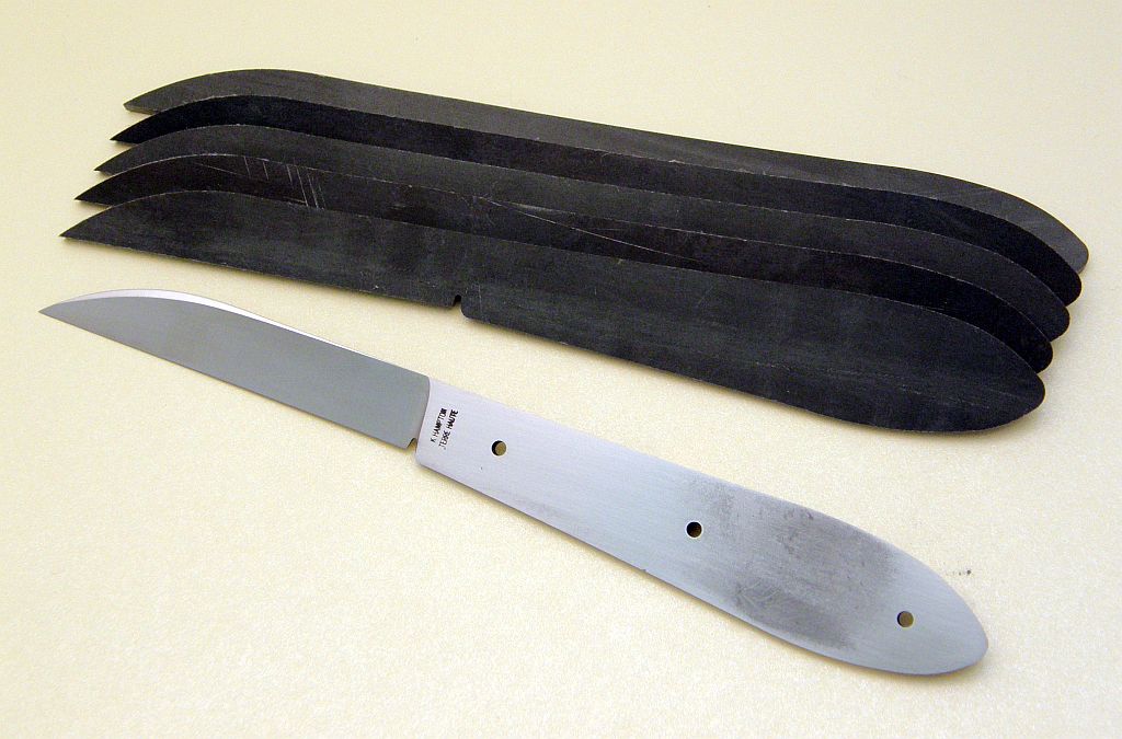

Here is some of David's handy work sitting next to a blade that I finish ground today. This is a Bose teardrop desk/paring knife pattern. David worked up the drawing from a hard pattern that we sent him and cut some out of ATS-34. Saves "grunt work" time at the band saw but the best part is there is very little wasted material.
You should have him include the holes for the pins as well. Get each one uniform. I bet it wouldn't be to hard for the machine at all. and saves more time. you just have to grind the edge and be on with it.
David cut out some folder parts for me and I asked him to spot the holes on those pieces. But for these small fixed blade knives, sometimes you want to play with the hole positions just a bit to allow for differences in odd shaped handle materials, such as stag.
