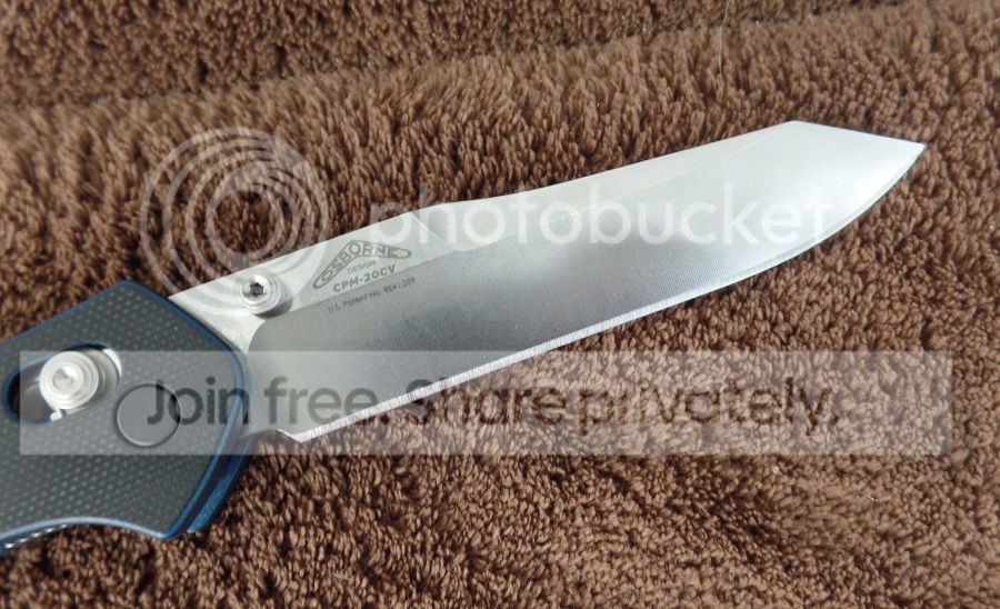

plenty of full productions (not sprints) spydies and BM available in cpm20cv s90v 204p s110v etc..
case in point BM 940-1501
SAM_3237.jpg~original
PM2
BM griptilian M390
