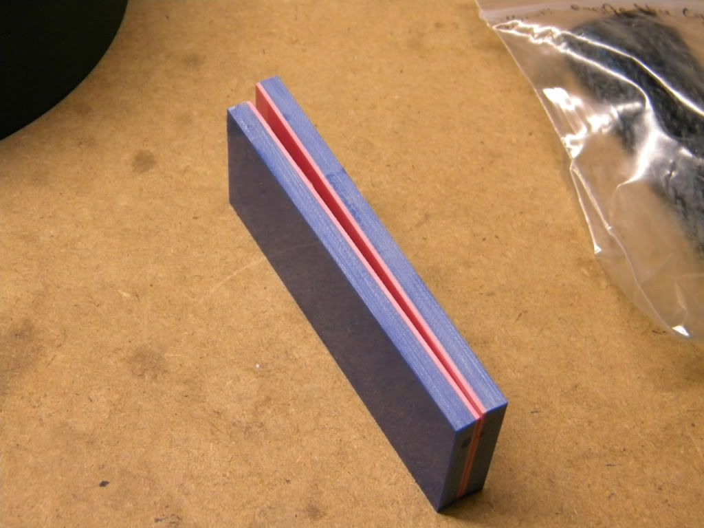

Sorry for the thread drift....but Phil, I've been working on some slabs with that combo just recently. Don't even know why, just decided to glue some up. The two colors really do look good together!

Also, I have some blue and pink g10 I want to laminate to make razor scales for breast cancer month this year.

Those colorful scale slabs do look like fun. You can see the color combo in the restored vise pix. The pink tubs in the background do light up against that blue!
