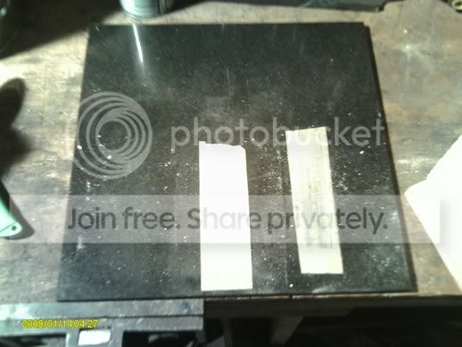

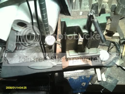

Here's some pictures of my 3 main fixtures and tools used in the shop. Remember all my blades are now made with hammer, anvil, fire, files and the junk pictured below.
This hand sanding fixture is a piece of 2" mild square tubing with mild steel welded as a face and a piece of 1/4" mild that is tapped for 4-40 bolts to secure a blade in the fixture. It's held on my bench in a bench vise, this allows me to change the angle if I need to. There's always tape on the face to prevent scratches. I will use almost a full roll of electrician's tape making a knife. I've found that the HF cheap tape works best for me. I've used other tapes and had issues with adhesives or rusting.
My hand sanding block is also pictured. It's a piece of 1 1/2" x 1/4" mild steel with leather on one side and golf balls for handles. I had shaped wooden handles but I find the golf balls more comfortable. I use spray adhesive to hold sandpaper onto the sanding block.
This is my other hand sanding/filing fixture. It's a piece of angle iron bolted onto a $4 drill press vice. There's leather on the face and a piece of wood is used to help clamp on tangs. Tape is normally on the leather to prevent scratches.
Well, I use this piece of thick marble tile from Lowes as a surface plate until I can buy a "real" plate. I use spray adhesive to secure sandpaper, clean up is with WD40 and rubbing alcohol.
Hope these tools give you an idea of what tools I use, they're not expensive at all and easy to make.
There's 2 blades in the pictures, the big fighter is pretty much out of the forge, just knocking scale off with a sen. The little drop point is cleaned up with a file and had the ricasso flattened and the filing/sanding on the primary flats is about to start.

Hey Will, I like your sanding thingy. :cool: I have a tap handle that looks like its cousin. I couldn't keep it tight on the tap and it was wearing on my hands I love the extra grip it gives me on the tap!
Looking forward to seeing more of this thread! Most of my homemade hand tools are part inspiration from to much aggravation! :D

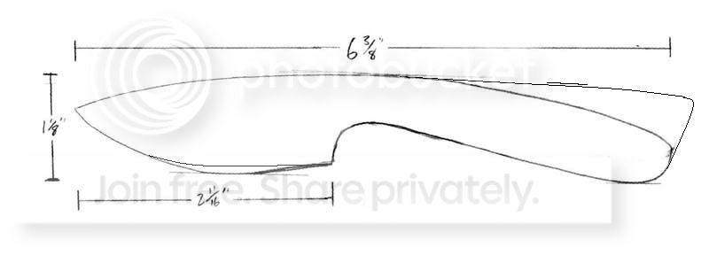

Here's a couple sketches I drew up for this project.
The first one came pretty natural to me, that 2nd design felt kind of forced.

Will, your generousity is incredible and very inspiring. It's funny, I bought the same exact tile from Lowes, it's sitting on my bench right now. :)
Wade of the 2 I think the second looks better. If you didn't want to make is as much of a wharnie you can maybe curve it up a bit more near the top and bring the point up a bit more. The first one seems like it would be more tricky to get a good bevel on. One thing that was told to me is keeping the edge and spine relatively parallel will make life easier on yourself. I would also suggest making the handle a bit longer as well. You're going to want the handle to be somewhere around a half inch or so longer than the width of an average sized hand. I'm not a big guy but a less that 4" handle would even feel small for me.

I'm assuming you're using a 1x1/4 bar of 1084? Great steel, just not the best size for a stock removal blade :p
The main issue with this size of bar stock is the limitations it places on the handle. Wade, if you have any playdough or clay make a cardboard cutout of the baldes with a little hidden tang and cover the tang with clay. Then hold the clay handle as you would a knife and go through knife using motions for a bit. When you remove your hand from the handle see the shape? It'll be more curvy and less of the straight cylinder look.
I like the complete curve across the spine and into the handle. Since you're somewhat limited on stock size try moving the top of the butt to about a 1/8" drop from the top of the bar stock then redraw that curve. That'll (in my design philosophy) make the handle more comfortable.
I don't like the curve at the finger choil on blade one.... it'll allow the finger to slide forward easier, the choil on 2 is done very well I think.
Overall I like the ideas behind your sketches but we'll need to tweak the handle a bit.
I really don't know how I'd get a lot done without that piece of tile. It's a very versatile tool that's chunk of rock simple :p
Maybe more like this?
Modified version of the 1st one:

I think that looks better.... less of a "Pregnant goldfish" look than the original :p I think you can even extend what is going to be the finger guard down more to it meets the line you drew in at the bottom and kind of square it off a bit with the edge like in your second pic. But again it's my opinion, I'm still very new at this and it's your knife anyway I just think the first pic seemed a bit awkward looking.

Some of this is hard to explain via words.... so I modified your drawing. When you get some clay try this handle style. Try your handle design..... just glob some clay on there and see what fits right. Now please don't include the finger grooves and stuff when you see what's comfortable. Mentally remove them from the design.
Edited to add: If you mock up your design in cardboard or something you'll see that the point of the blade indexes very high and in a less "intuitive" position in relation to your hand (at least to my way of thinking.) I kind of like to keep the blade point near the middle of my hand unless it's a wharnie or semi-wharnie. I'm not saying you have to design it like this, I'm just asking you the thoughts behind the design. You work with lawyers :p you should be familiar with the Socratic method :D
