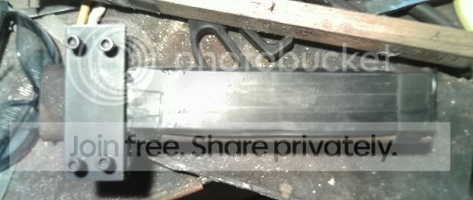

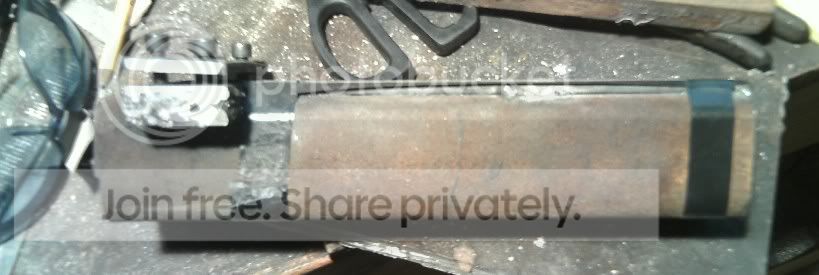

Double post to add different pictures of the sanding/filing fixtures I use:
End and Side view of the drill press vise. Nothing complicated, remove the fixed jaw, drill the angle iron to fit the bolt patterns and bolt it up. I add leather to pad the face to help hold a blade better and to help prevent scratching.
Top and side view of the square tubing filing/sanding fixture.... simple again, 2" square tubing with a piece of mild welded to the top as a face and a piece of mild that's drilled and tapped for 4-40 allen bolts. Fpr the clamping face there's a piece that is welded like the "top of the tee" butted up against the working face, there's some extra pieces of mild welded on the bottom of the fixed hold down that are tapped to give extra holding power.
