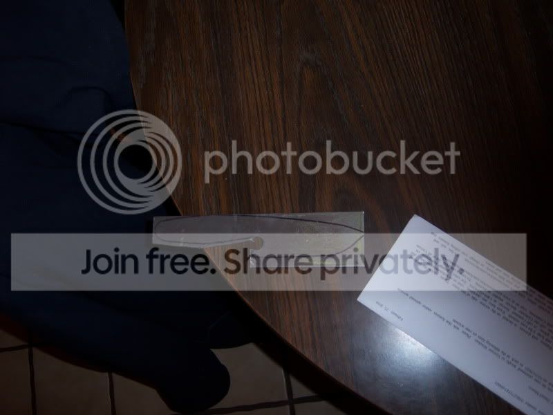

Here's an updated pic of mine.
Going to do some final profile tweaks, smooth down the sides and get ready to bevel.
I like that design,and it's not to late too move those pin holes.I would.
God bless,Keith

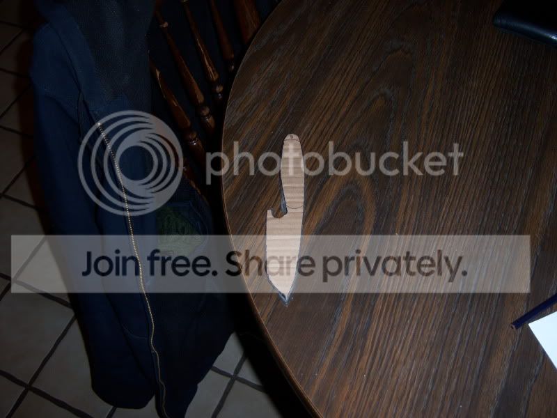

Did some more grinding today. I think it is pretty close to being what I want--slimmed it down some and it is much closer to my sketch. Balance is right at the finger notch and it feels lively, even with the weight (it's .25", remember). I don't think I'm up to trying a tapered tang so I plan to drill some big holes to off-set the weight of the scales.
Please, give me any opinions/suggestions, good or bad.
Oh, and what's the next step? Thanks!
I put in a couple new pin holes today and flat sanded the sides to 220 grit.
Should I flat sand to higher grit now, or should I start on my bevel and leave the finer sanding until after?

When you lay out and drill your pin holds, remember your outside contour of your handle,or you will grind most of your pins away.I put mine at least 1/4" or more in from the edge.Something to think about.
Jerry

Jerry--that's a great tip--that would have been an unpleasant surprise for sure. Thanks!

Good news on the pin holes--more centered, I take it? I would think it makes sense to get get the bevel done first, but take that with a big grain of salt. How far are you going to go before heat treat, anyway? 400?

Mr Bad, Same thing goes for the tong tube and the pins back from the forward end [if you plan on a radius or bevel on the forward end of the scales] Jerry

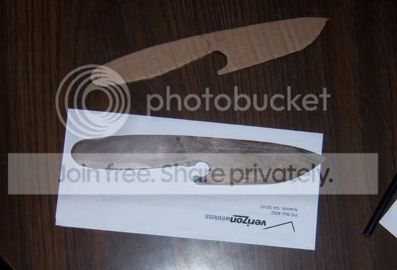

Just an update on my progress.
The profile all cut out with the hacksaw.

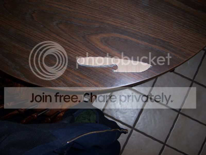

And after I finished with the pedestal grinder. You'll note there about 1/32" or more around the blade to work with. All in all im pleased with the grinder work and its pretty smooth and uniform lines as far as a grinder goes. I did change one area though. I wasnt happy with as fat and flat the front of the blade was, so I started a steeper angle upward to flatten it down some. It just didnt look right after I fattened it up in the second version. This should tone it down a bit upfront and give it a bit better lines there. So far so good here. Im thinking of using the redwood that burl source gave me on this one. And a bit of stain to redden it up some to what we call a "russian red" in the SKS world.
The ONLY thing I think i should've done before the grinding is drilling for pin holes. No biggie regardless, at this point as I can just vice it on the drill press. Thats the next step, then on to finish up the little bit thats not profiled in yet. Namely the finger guard area. The rest should some out with the edge or me filing out the grind marks.
Any input is, of course, appreciated.

Looks good so far--I like the design. Is it for kitchen use? Is it OK to heat the blade as long as it is prior to HT? It looks like it got pretty hot in a couple areas.

Its an EDC more along wills lines. If it was up to me id have extended the blade out more say 2". I just didnt want to get too far over my head here, and im guest in this thread to boot as I entered late. The last couple I did were on a grinder and all just general choppers and machetes. Nothing special. Grind it, put a semi edge on it, and HT it. Finish up after with the grinder again and go out and hack down weeds. So nothing special in the knife world. This thread was a chance to see how you guys do your thing, while I can do mine here and learn. I was planning on making a set of kitchen knives in the future along much straighter simpler lines than these. Just thinner and straighter. I figure if I can make this pry bar I'll upgrade into a small kitchen knife then a bigger one after that, then a bigger one... Repeat until set is done.
To my knowledge the 10xx series of steels are forgiving on HT. Letting you try again if you've failed the first time. So grinding shouldnt be a problem to them in that regard. THat and grinding should only effect the surface of the metal. Most of my work has been done in 4140 ord grade steel. Ak-47 receivers, FN FALs, gun barrels and trigger internals. This is all kinda new to me. I can HT a receiver in 4140 according to specs for a build, but knives seem to be more of a science in that regard.
