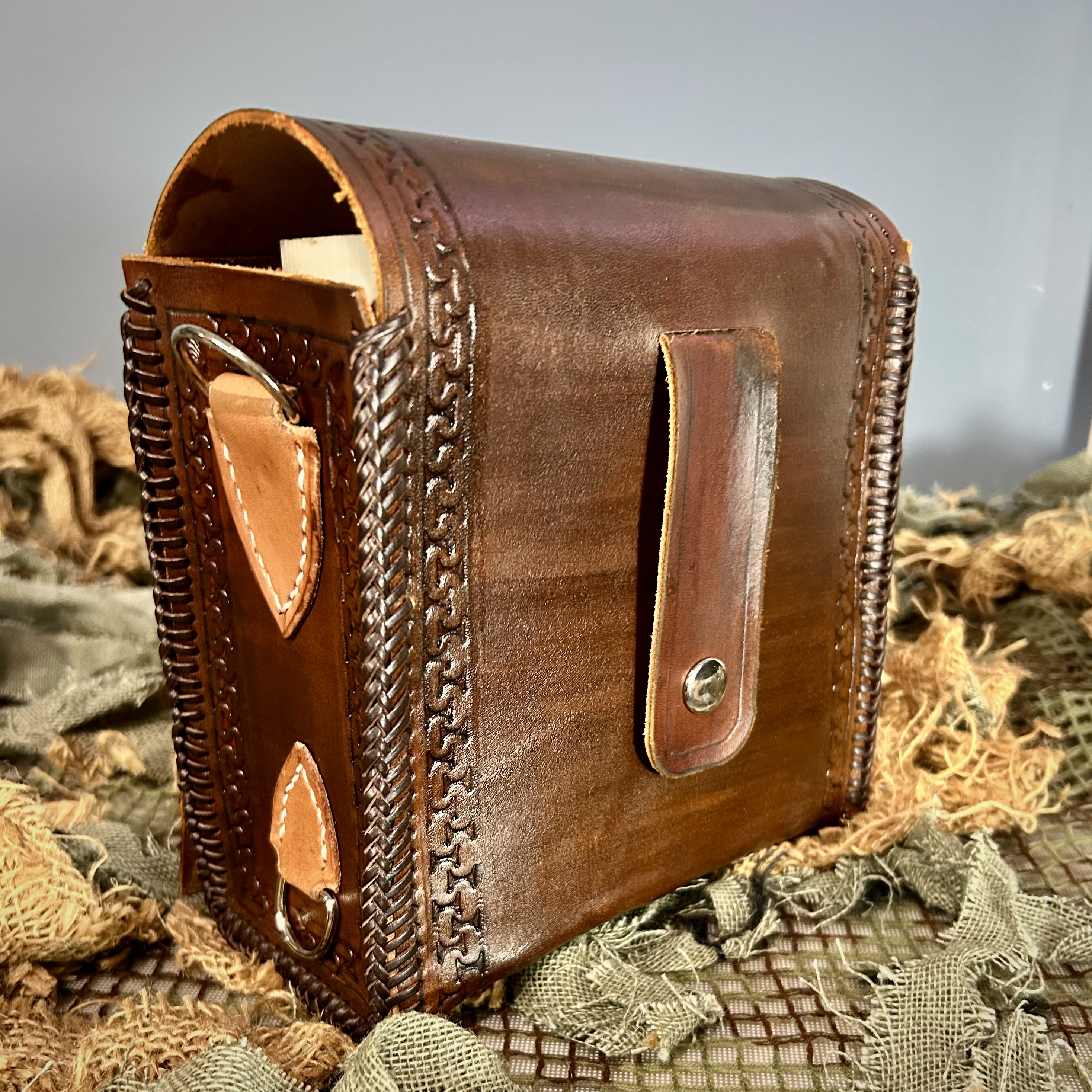

I needed a new shoulder bag so I've spent the last while developing this one. I saw a bag I liked and worked up a pattern using a photo of the other bag for ideas and figured out how to make it.
I used a scrap of about 10 oz. veg tan belly leather for the back and some firm chrome tan for the front and the top. All were dyed, heavily oiled and treated with a bees wax finish. All straps are water buffalo.
