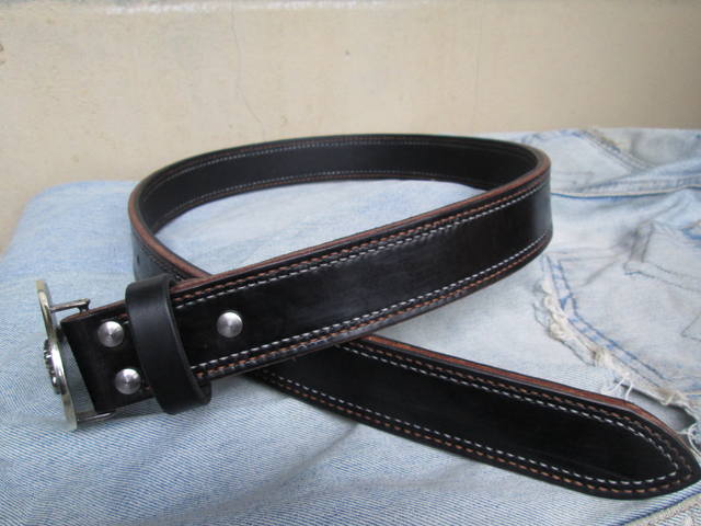

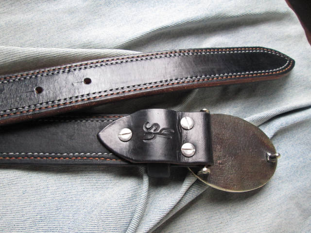

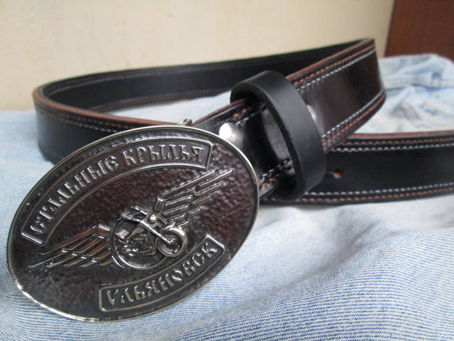

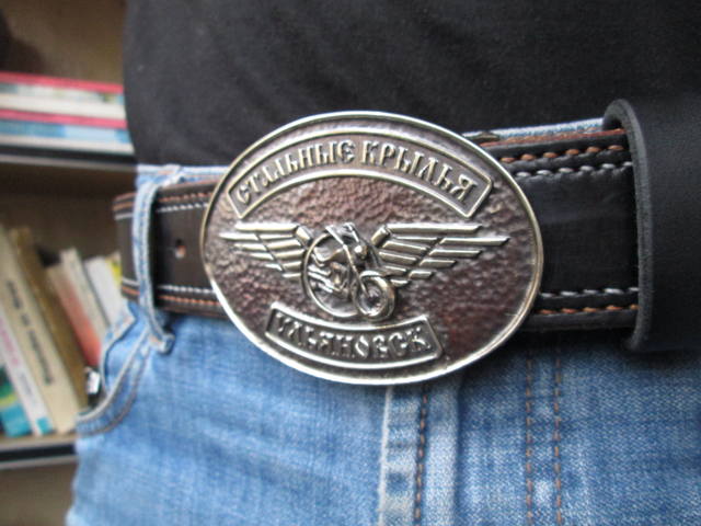

Thanks! Yep, a little been busy, besides i'm more reading than posting something. Glad to be here. One of my last works is a belt again. For my good friend, he's from local motorcycle club "Steel Wings" So that's the theme of the belt. Two laers of leather veg tanned for the face and chrom for the back, double stitching, stainless steel screws and nickel silver buckle. 40 mm width, about 7 mm of thikness.

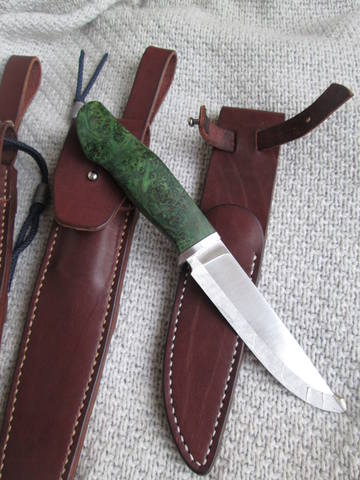

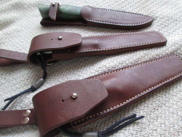

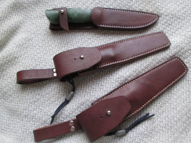

Just completed and gave away three of sheath. This is chrom tanned 8-9 oz leather, oil and bee wax mix finish.
Wow buddy! Just beautiful work and beautiful leather too! Comes that way right, not dyed by you?
