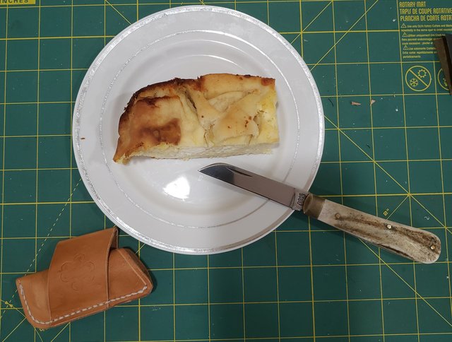

My latest attempt at a horizontal sheath modeled after the Case sheath.
Hows the retention on that and does the loop slide on the belt?
Retention is pretty good and yes, the loop slides on the belt. I was considering a wider strap for the loop, one with two parallel slits so that you can "weave" your belt thru. That will be my next iteration when I get a little time, I will keep you posted. If you have any suggestions I would love to give them a try.
I would like to see how that works out with the slits. Thats a good idea. One of the problems I've always seen with that loop design both on sheaths for folders and fixed blades is a lot more loop than belt so there is a lot of sliding and flopping. Really like to see how your fix works.
