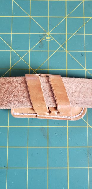

Here we go @Horsewright, I will refine it as I go along (when time permits)
So this is a quick "proof of concept " I did with the sheath I made last week. I know it is rough, but I literally don't have the time to make another.
And this is how it goes on the belt. In the few minutes I tried it, it doesn't seem to slide on the belt. I noticed a little forward sliding when taking out the knife.
Now I will try looping it down trapping the pant's belt loop in the middle.
All done
Now it is staying put. Additionally, easy and unhindered access to the pocket. The sheath has a slight upward angle which is what i wanted. In it's previous iteration it could be used on either right or left side. With the slits cut in the loop, it becomes either a right side only, or left side only sheath. That's it from me for now, I need some shut eye after a 36 hours stretch.

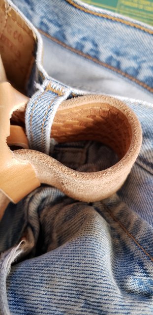

All done
Very cool looks like it'll work! Yeah I always carry a holster like that. I've heard it called splitting a belt loop. Seems to help support the weight better and eliminates travel on the belt.

LOL! And I thought I had a brilliant idea!:confused: It definitely works well, it seems for some reason that it doesn't sag on the belt (especially on a narrower belt) and it doesn't travel at all.

It seems I spoke much too soon about the holding capabilities my horizontal sheath has. It works well for something like a Case sowbelly but the knife I have pictured with the sheath decided it wanted to fall just about every time I bent to pick something up. Back to the drawing board, maybe something with a flap and button stud would work.
Yep I've heard lots of horror stories about those sheaths. Much of our clientele are working cowboys and I hear all the time about them long trotting across some pasture and losing their knife out of a similar sheath. We went the opposite direction with these:

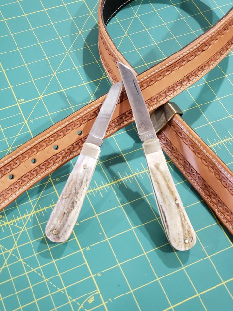

Hand sewn and a double Carlos border. You are an ambitious man! Nice work.
Randy
Thank you, Sir. Either ambitious or too new to know what I was in for. I have some nice buffalo leather and intend to make a belt (or three) from it but I wanted to practice first. Now I know, once I get a little time I'll be making the buffalo one.
