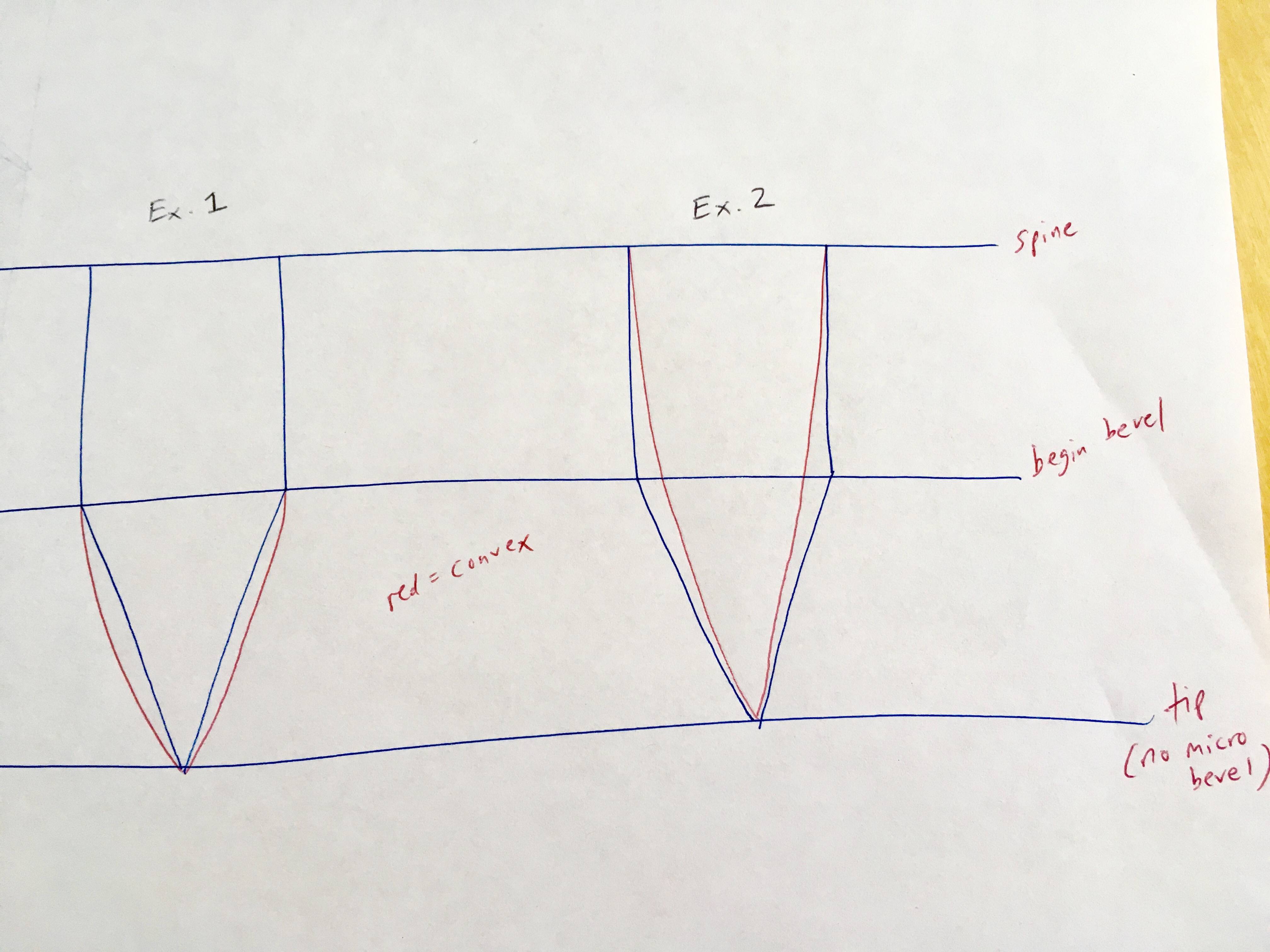

Here's a low quality diagram I made to illustrate the difference you're talking about:
Ex. 1 shows bevels with the same distance to the tip. In this case the convex is thicker. Ex. 2 shows the convex "bevel" starting twice as far back as the v-grind bevel, in which case the v-grind ends up thicker.
My apologies to everyone if this is a poor explanation!
Not a poor explanation, and yes i agree, if you pull back the convex bevel to match the angle of the V then it naturally becomes thinner, as the nature of the convex is to have that thicker curve. Achieving the zero grind like in the picture on the right is a much more difficult task for people to do by hand, many knife makers do these by design with the intention from the start to achieve a purpose made convex blade. I think the lay person will be more inclined to use some kind of belt system to achieve and edge similar to the one on the left. For instance the way CRK Sebenzas come from the factory, with a standard convex that quite honestly is a little too broad for my taste. Great for those who like to sharpen by hand on stones tho.

This is a very good pic which also reinforces what i said as well as your point also. As i said numerous times, at the very edge if you continued on a straight line the V grind will always be thicker. But, if you treat each of those left and right corners as knife edges, which one is actually realistic? One is a usable convex, and the other is basically a sharpened cube 90 degree angle for a knife edge. Now i've edited your picture to show what im talking about, and basically the only point i have been trying to make - If a normal, usable convex was put on a knife with a normal hollow grind or saber ground blade geometry (not a zero grind convex from the spine) then the convex will always contain more steel behind the edge, even tho it would be a chunky edge. I'm talking shoulder to apex being an even distance for the entire primary edge bevel. The mathematical formula has always been correct, but it hasn't been the focus of the example i have been trying to explain. Either way guys, i'ts been a good discussion, no chips on any shoulders, i enjoy this kind of thing, we're both correct, we're just making different points.
