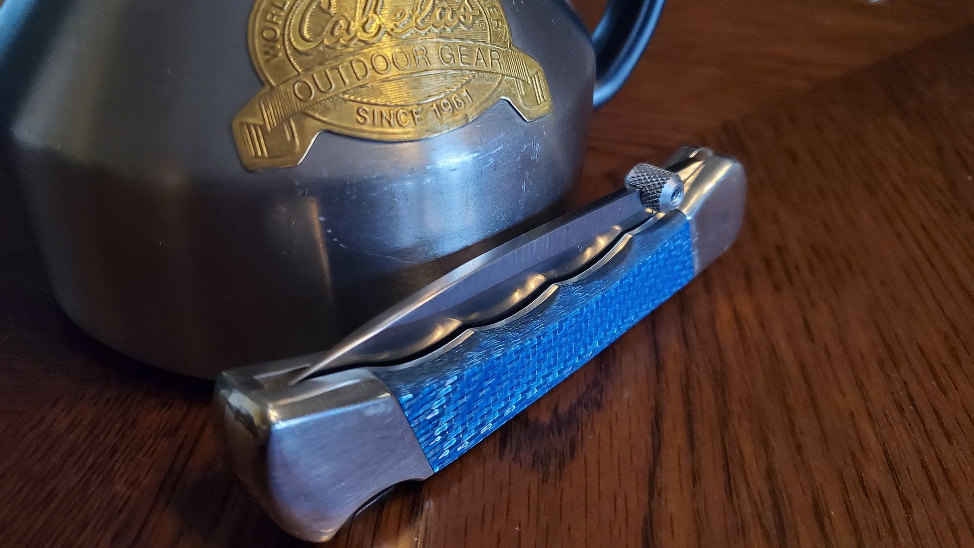

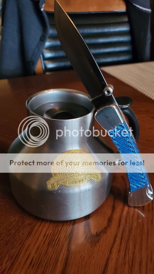

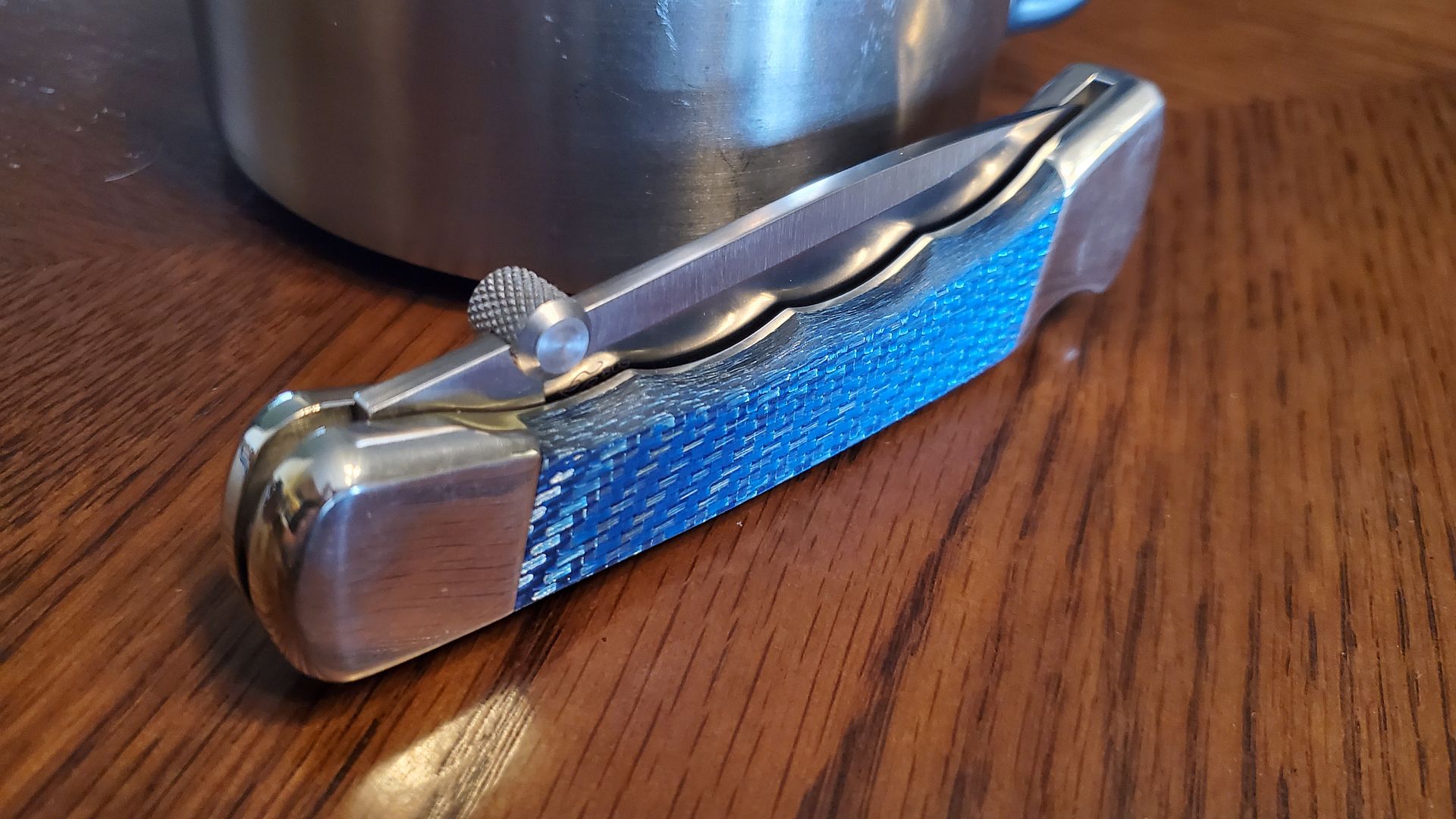

SWMBO is out of town with her mobile phone! The pics I take with my flip phone look like a bowl of oatmeal hidden by a cloud of fog in the dark!
Here's an old pic of the same k-nife. You can't see most of the scratches on the blade, but you can see some on the front bolster.

Does anyone else like to reprofile the edge bevel on their 110 so that it's as thin as it can get? It's obvious on my photo!
most of the edge2000 knives come with very steep or thin primary edges. 15 or so degrees per side. Jeff's commented in the past on the actual angle I can't remember exactly but it's close to that maybe 16 degree or 17 degrees. less than 20 per side though.
I try to not go below 15 per side or 30 inclusive unless blade is a steel that can handle that thin an angle.
I usually go as thin as I can (I don't measure the angle). CPM154, S30V and S35VN have pretty good edge stability, so I haven't had any problems like I did when I tried the same with older 440C blades. The recent 420HC blades I have were already sharpened the way I like them!

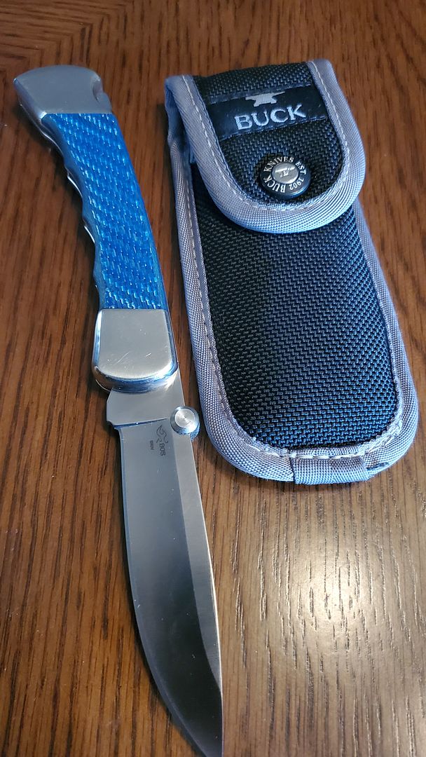

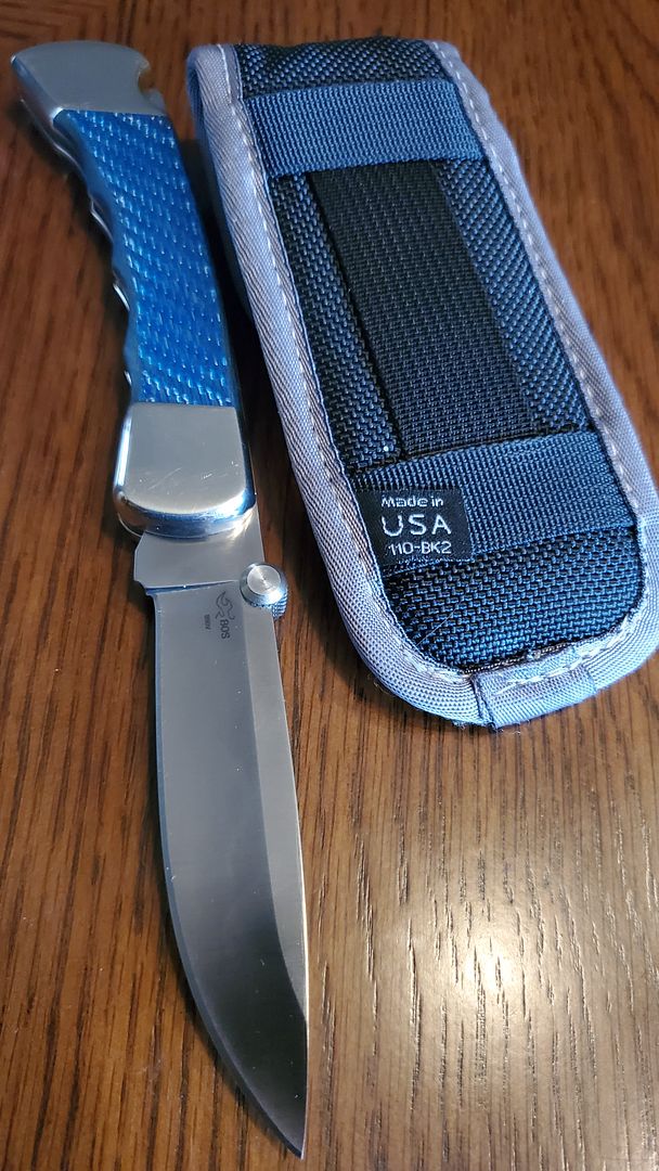

Had the same Buck 110 in my hoodie pocket this morning when a new freezer got delivered. I used it to cut the plastic straps, but then the top of the shipping carton would not lift off as it was designed to do. At some point in shipping, a big hole got kicked near the bottom and prevent the top from coming free. I used the Buck 110 to slice down one corner of the carton top and then wrestled it off. Then I used it again to cut the carton top into manageable pieces for hauling to recycling. It's a very good slicer of corrugated paper board!
