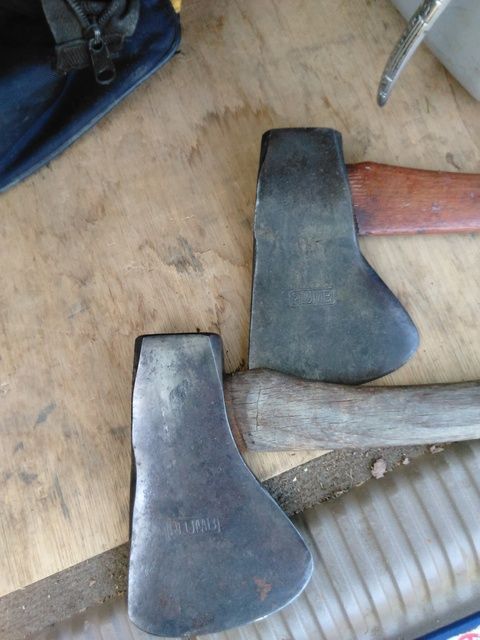

Is this considered the national pattern too? These are similar, but have a more narrow, tapering poll. BTW, good looking hangs guys!
Yes, those are Plumb Nationals. They are sometimes mistaken for Plumb cedar axes.
A couple photos found online, which illustrate some differences between Plumb's Cedar Axe and Plumb's National Pattern:
National Pattern:
Cedar Axe:
The Cedar Axe has a curve between the eye and the heel (similar to a Rockaway pattern), and a noticeably flared toe (not a straight line across the top of the head between poll and toe). The National pattern has fairly straight lines at these places.
