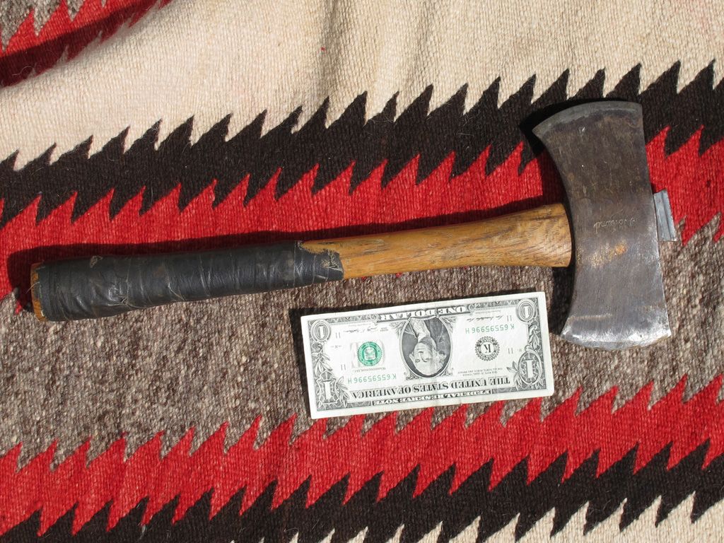

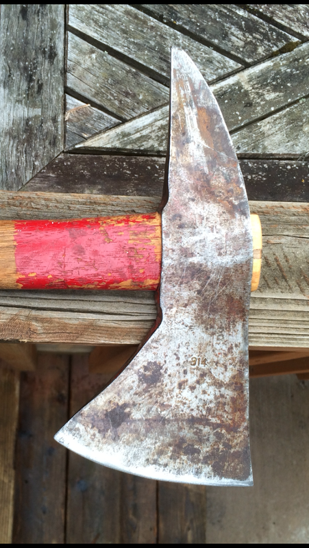

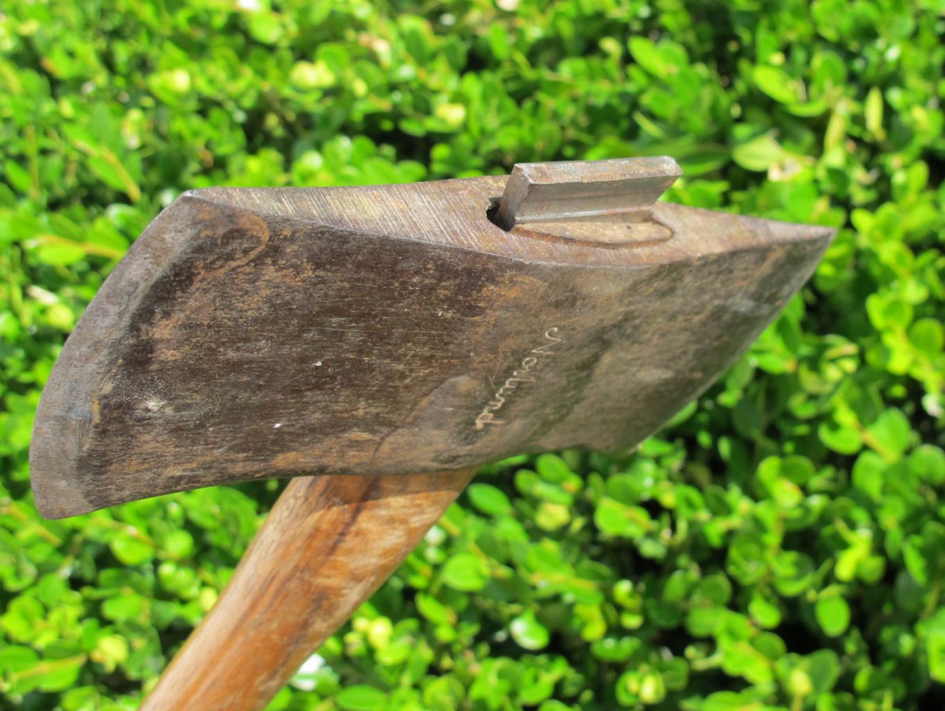

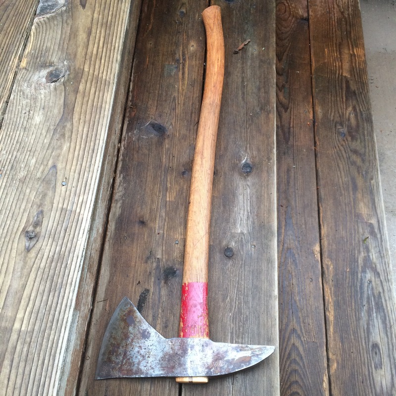

This one is 27” long. The head is something I picked up locally and is likely German or Chinese in origin. The handle is the intact portion of a vintage handle that had a split up fawn’s foot and overstrike damage about halfway through, just below the tongue. I think it was the handle to an older Mann axe I found at a barn sale. The head is sharp now though. Didn’t do anything to mitigate the wear on the spike end.
I was left to my own devices in my shop area and a little Knob Creek. It was a nice evening to be honest.

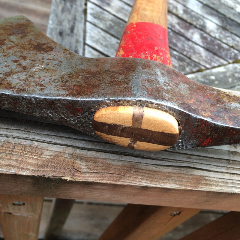

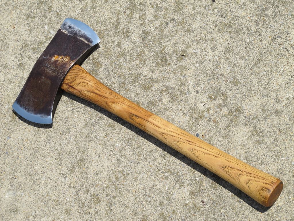

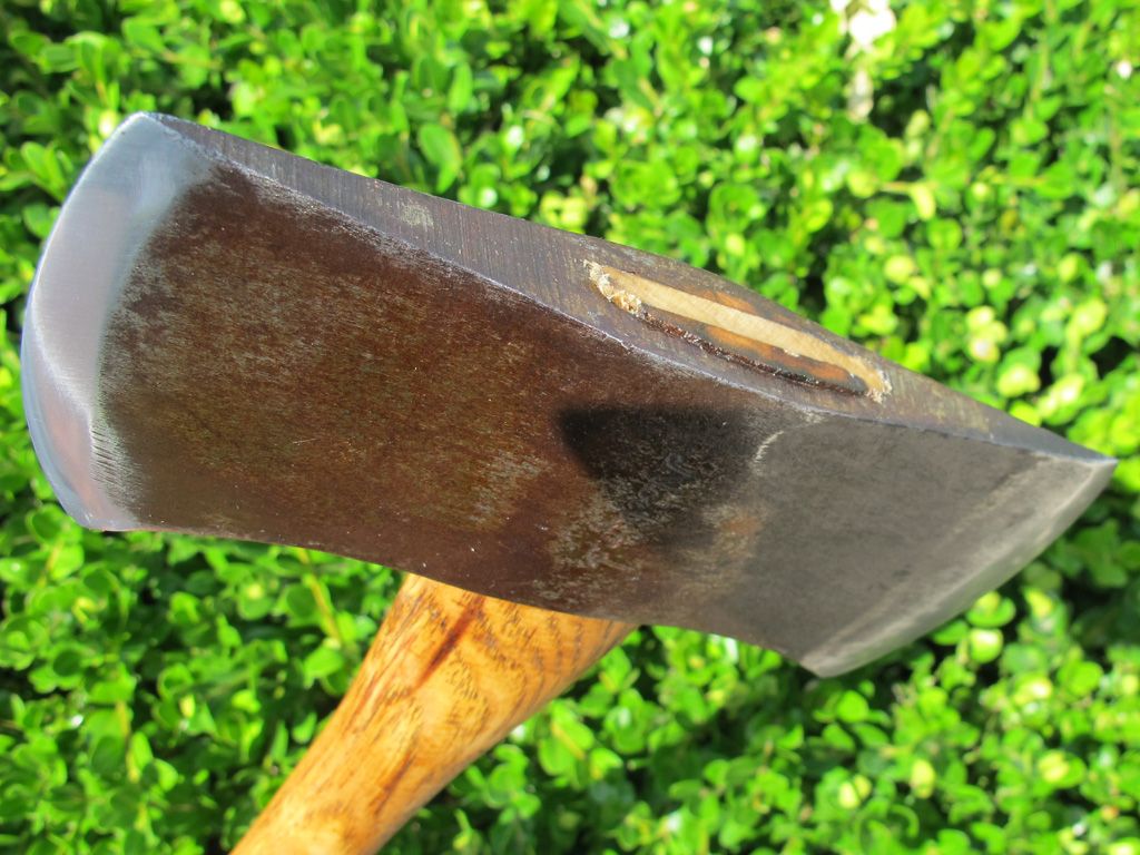

A nice plumb 1.5-1.75lb head on a House 18" broad axe handle. Bloodwood wedge, raw linseed oil. Dice (the cat) is not impressed.
Just rehung a Norlund Saddle Cruiser, I must say I don't get all the hubbub over Norlund. I was very unimpressed with the quality of the grinds and the temper of the steel.

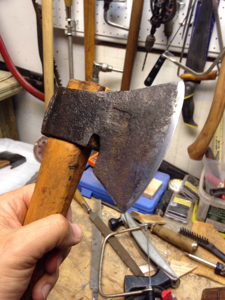

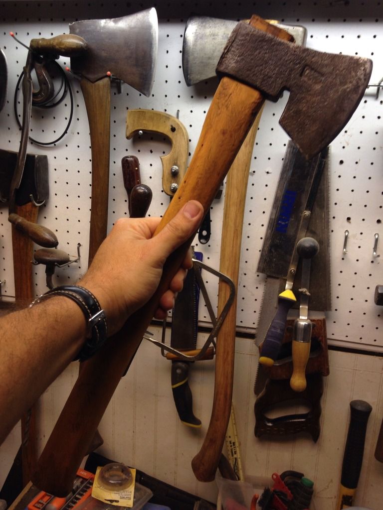

I was hanging this claw hatchet on what I think was a House handle rigging axe handle.
I just could not get past how thin it was and knew I would be rehanging it sooner rather than later. I like a lot of what House Handle sells but their rigging axe handles are just all wrong. I know that handle will never stand up to pulling nails or take many overstrikes. Just to thin below the shoulders.
[/URL][/IMG]
After taking inventory I did not have a suitable straight handle and since I had more time than money I decided to hew out my own.
[/URL][/IMG]
I dug up a Vine maple bow stave that had taken to much reflex after being cut. I was able to get enough of a straight section out of that. It has been seasoning in the shed for about twenty years.
[/URL][/IMG]
Vine Maple is not as hard and heavy as Sugar Maple or the Canyon Maple, but it does have a resiliency that I think will serve me well enough for a hatchet handle. I tried to make the center of the tree the center of the handle but I missed it. I don't think it will matter much.

Garry, I think that handle looks great. The vine maple around here is pretty spindly and crooked growing stuff.
Definitely looks sturdier than the House handle in your first picture.
How long did it end up being?
Thanks Agent H.
It is a little over 18". We do not have any Vine Maple in this state. We have a Mountain Maple that looks similar but the wood is not near as good as the Vine Maple in my opinion. I harvested this Maple in the Oregon Cascades, like you said it can be a little spindly and crooked. If it has a weakness it will be in abrasion resistance if you don't get much run out.
A cute little fella maybe for keeping in the car/truck or trailer or who knows where else. You did a 'very polite' job of rehanging this. My compliments.
