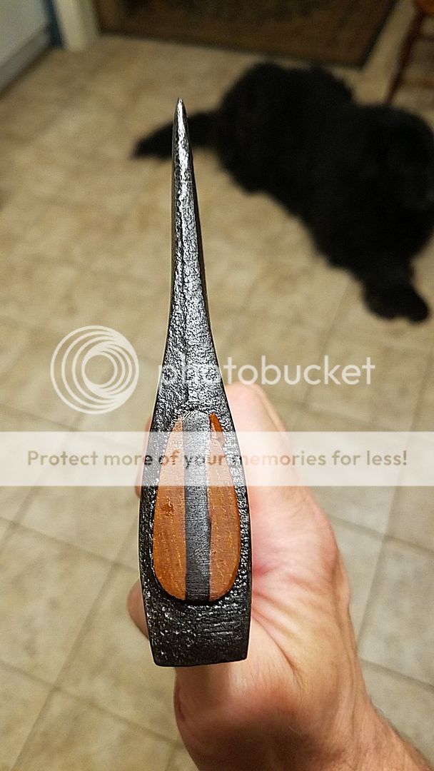

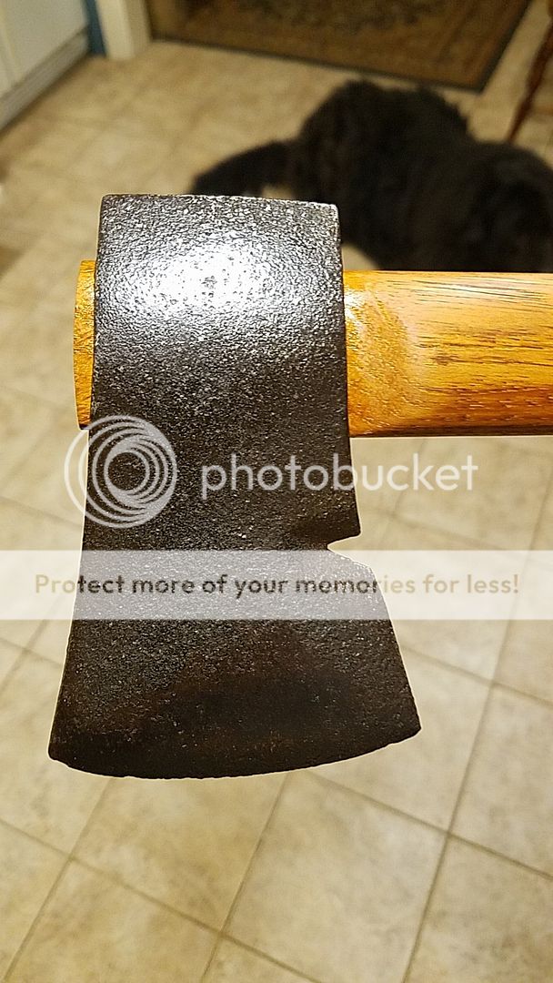

Just playing, I took a no name head that was in great shape and married it to an old axe handle cutoff. I shaped by hand, refreshed the surface of the handle, sanded and oiled etc. It came out pretty awesome, mahogany wedge. The hatchet is 22oz and 13.5".

Now the hatchet is done, a great night's project. It now shaves arm hair, I started with a file, then just used various stones freehand down to translucent Arkansas.
