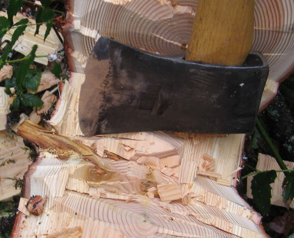

You misunderstood what I said about hemlock. No, hemlock is not a hard wood. But hemlock knots can be glass hard and have a reputation for damaging axes. You may have different varieties over there.
Perfect opportunity to show that Hemlock knot chipped blade pic of yours that makes me cry every time I see it.
