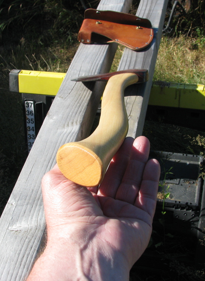

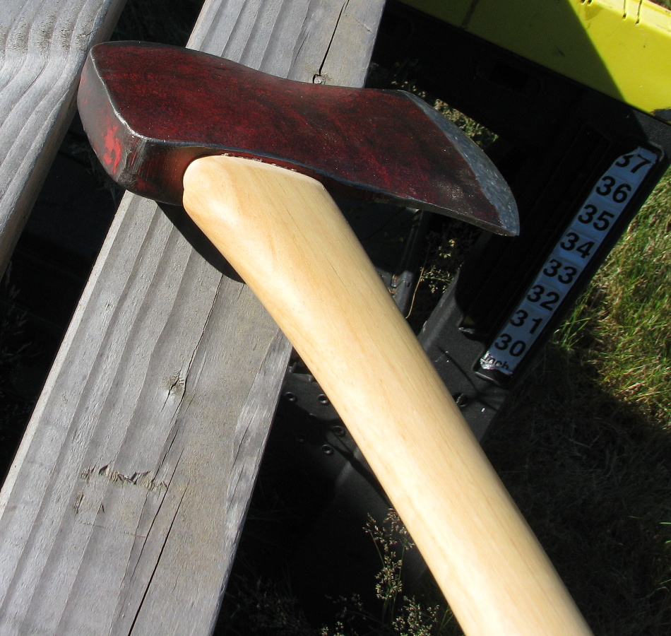

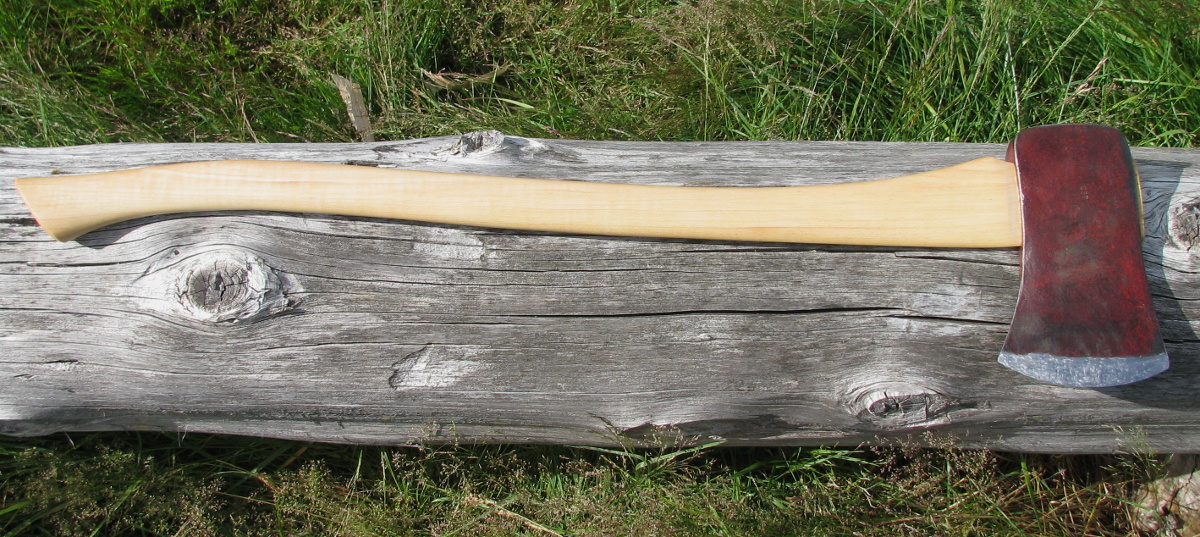

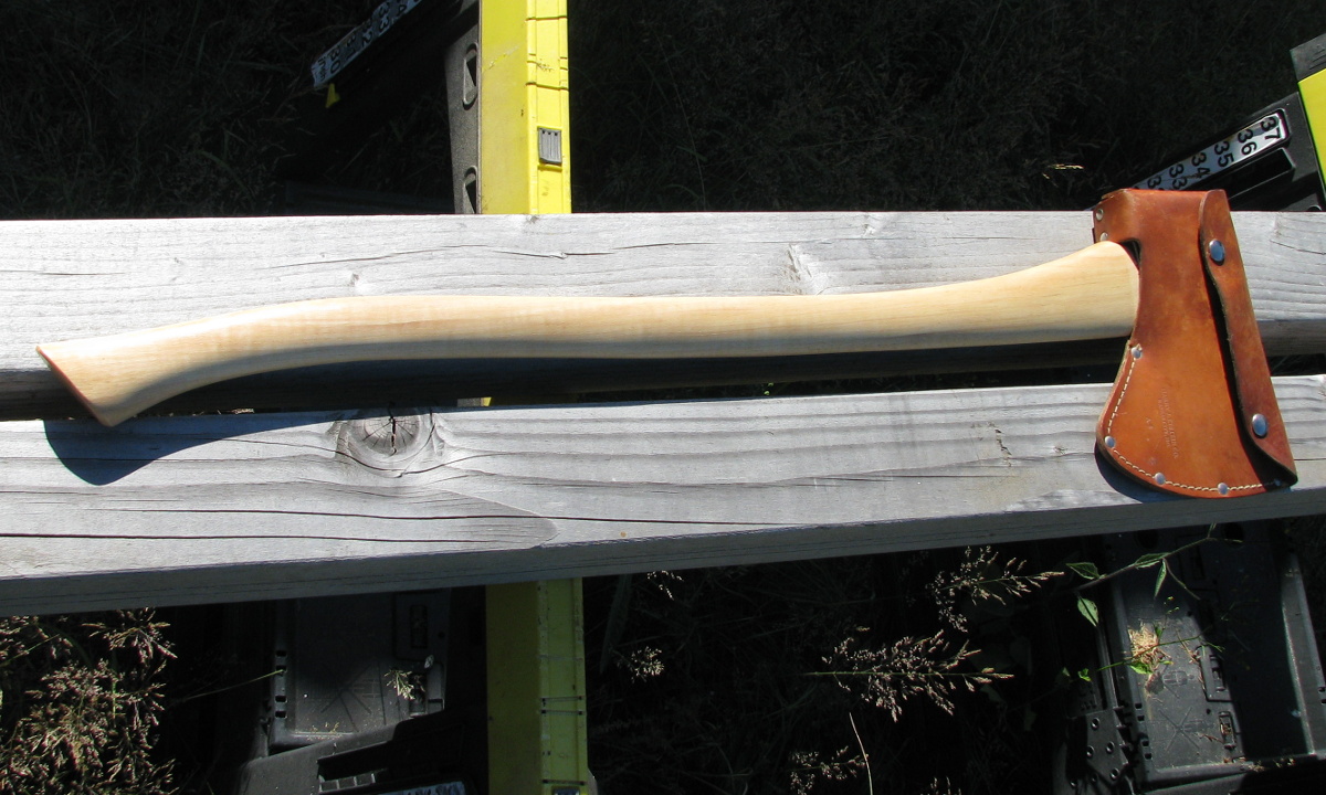

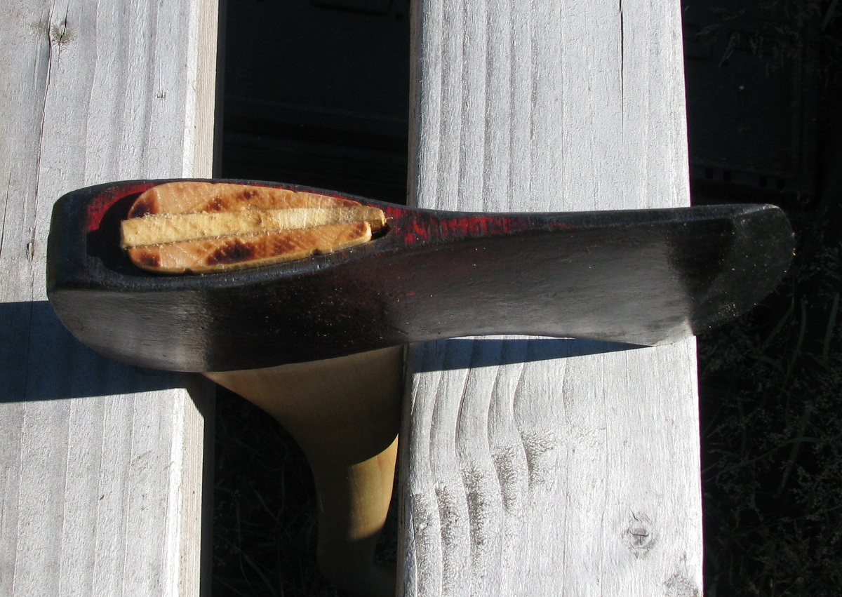

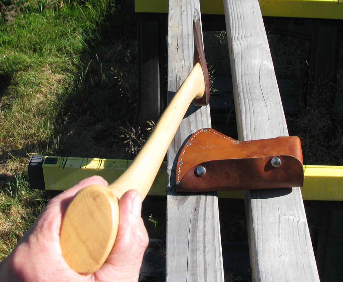

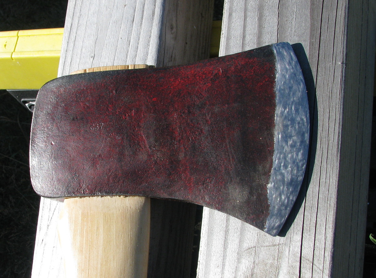

This axe is a wedding present for some friends of mine. They live on the Olympic Peninsula of Washington State. This is logging country and almost everyone has a fireplace or wood stove. This is a simple Kelly Woodslasher designed to be a solid working axe. It's not a perfect hang. It's not a perfect haft. It's not a perfect axe. But I think it will be a good solid worker.
After sanding and finishing I discovered that this is a piece of curly hickory. The curliness shows better in certain lights and at certain angles. The haft is a 32" Tennessee Hickory curved haft.

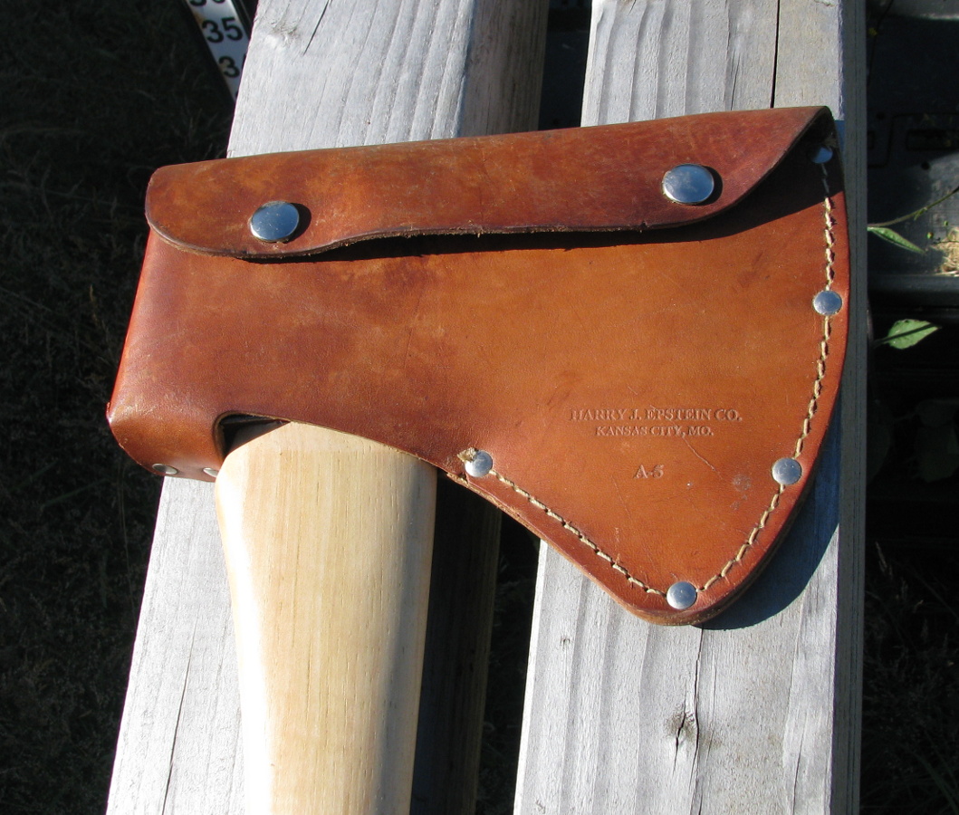

Oiled leather sheath from Harry Epstein.

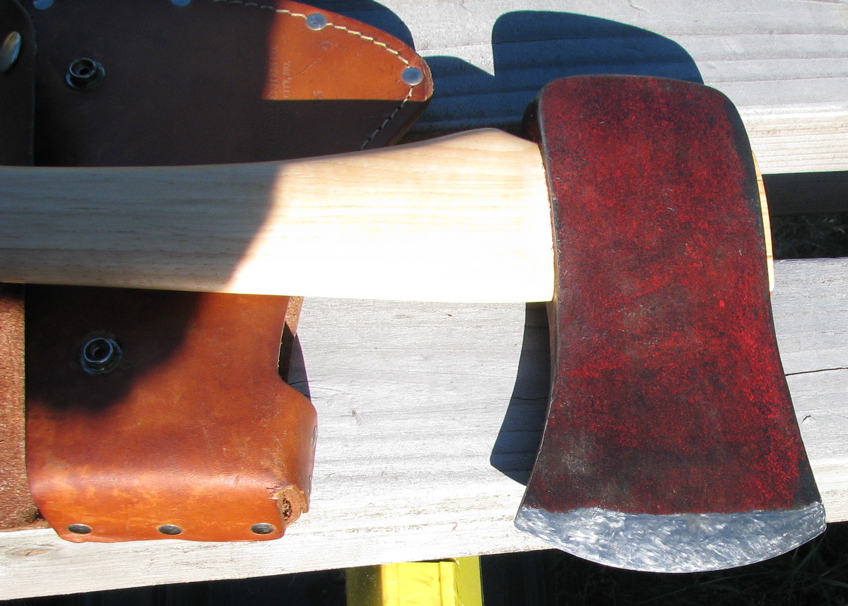

Hand filed and honed. C37 stamp.
Clean poll.
Slimmed haft with 2 coats BLO and 6 coats of tung.

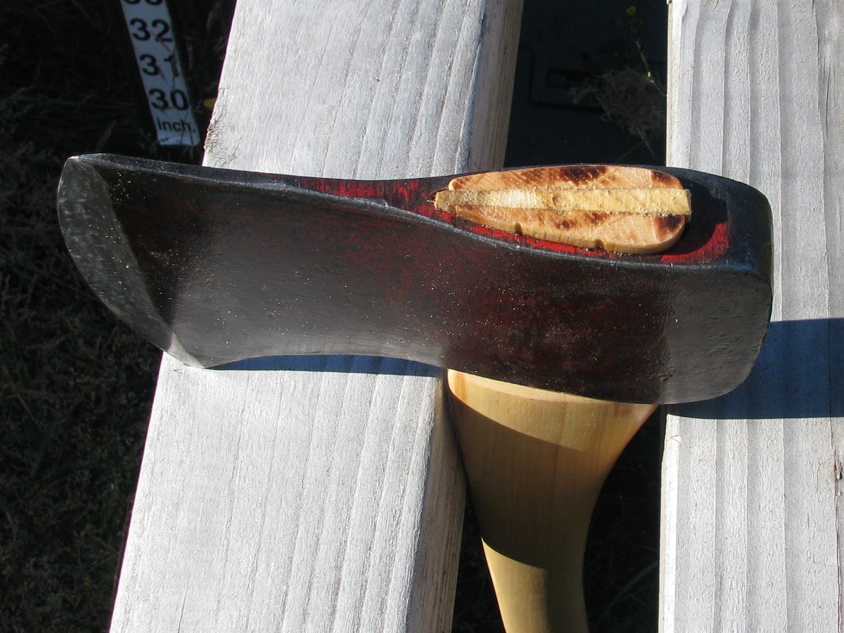

Haft didn't fill the eye but it will be fine.
It's ready for work.
You made that handle gorgeous and good job on that bit! You put a lot of work into that axe and I'm sure they will enjoy it.
