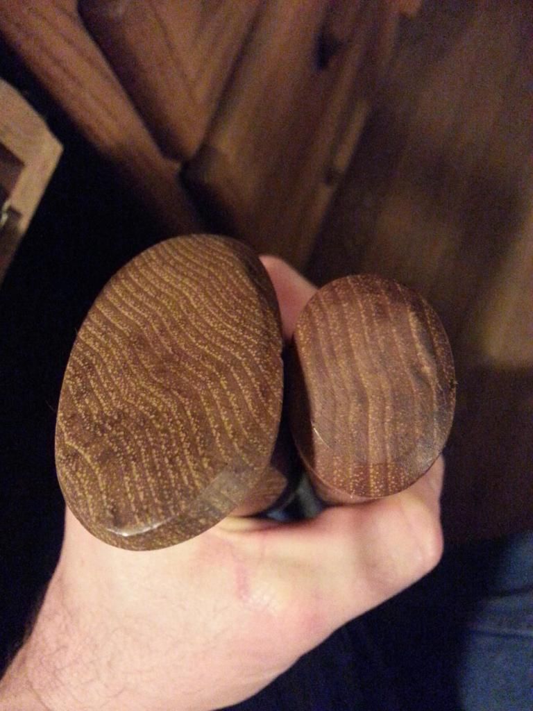

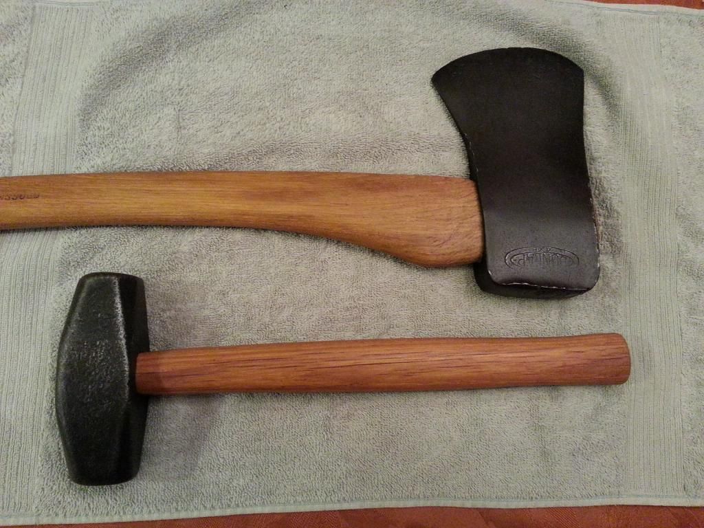

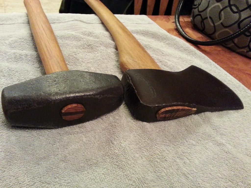

Here is a pair that I finished tonight. Actually the hammer was done a few days ago, but I didn't feel comfortable posting just a hammer here until I had an edged tool to go along with it.

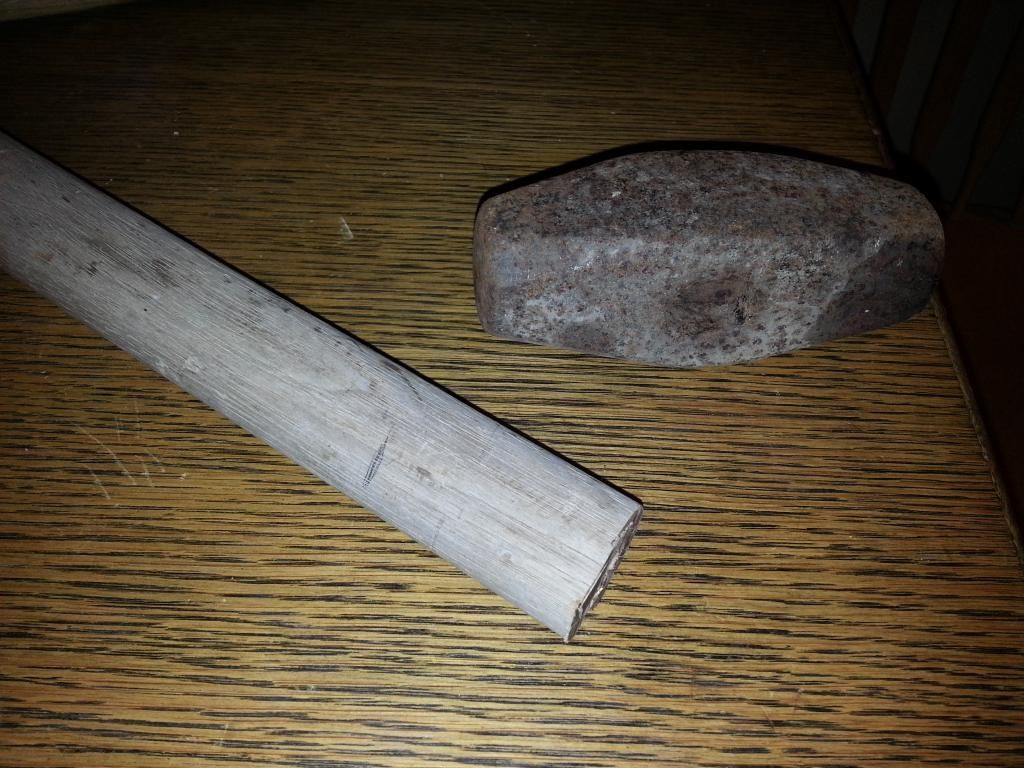

The hammer is special. It is a fine 4lb head on a handle that I crafted from half of a dry old gray sledge handle. I resurfaced and thinned it until it fit this head. It is now 14.5 inches long and weighs 4lbs 4 oz. It has a mahogany wedge.

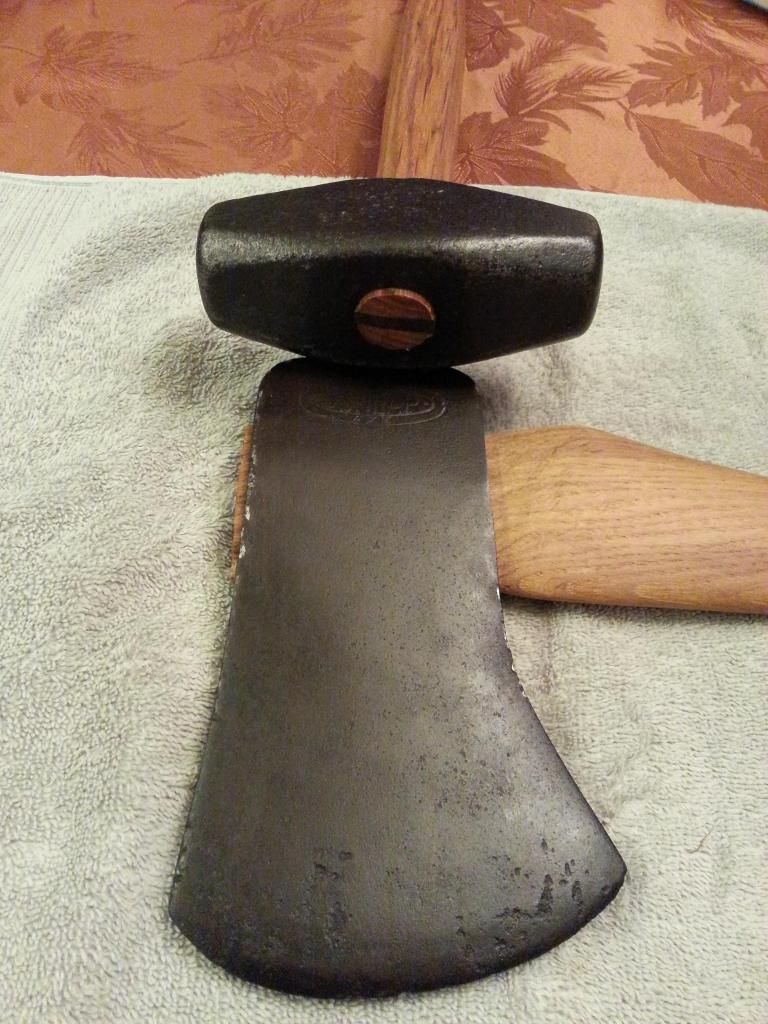

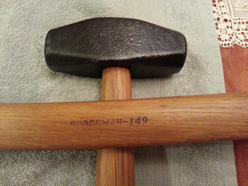

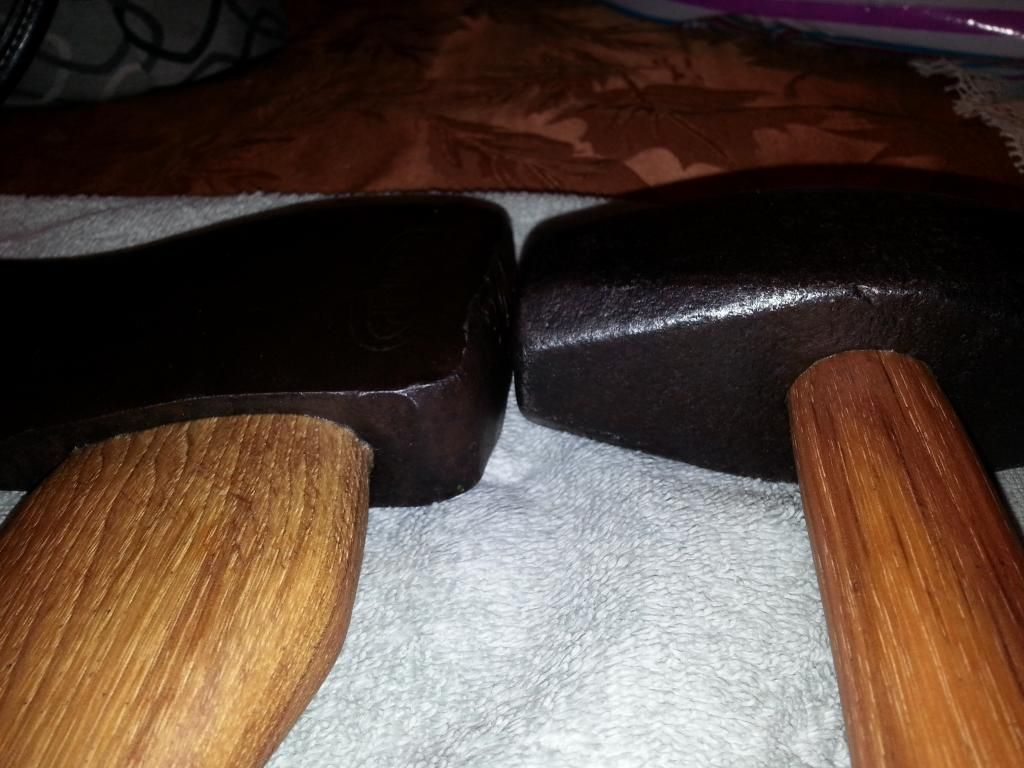

The axe is also special. This is because it is my first true rehang that allowed me to to feel truly legit. I have done hammers, hatchets and even re-wedged axes, but this is the first TRUE rehang on a new handle, reshaping etc. on my own with a rasp, a Mora and sandpaper. It is a Michigan Dunlap head on a NOS handle from a hardware store that went out of business about 20 years ago around here called Grossmans. I chose these for my first attempt because I knew that if I were successful I would have a nice quality tool, but that if I wrecked something it would not be a tragedy. I think that it turned out great. It is 31 inches long and with the 3.5lb. head weighs a bit under 5lbs. It has a traditional poplar wedge. It now has a metal wedge that was driven in by the pictured hammer. These are not the best work that you have seen, but they are the best that I have done and the first that I have done that I am really proud of and think will stand up to real use and real scrutiny. Both have been BLO'd and bees-waxed.
Gidday jblyttle. Looks good! Here I get to use an old phrase properly: you are definitely 'getting the hang of it'.
Nice pair Jblyttle! I like seeing the hammers you put together by the way. The wedges on both look really good and very clean. Just BLO on the handles of both?

Thank you sirs. BLO then BLO/turp/beeswax paste. I have noticed that any older handles that I have darken up quite a bit more than fresh ones even after the light wood has been revealed by scraping and sanding. It looks new and pale, but always darker with oil than new wood. I like it.
I use that stuff, too. Makes a nice protector for the head as well as the handle. I've come to prefer tung oil on the handle.
Yes, I always coat the head- I like the darker look that it gives the metal, and if there is any powdered rust reside left over hanging out on a pit or crevice it gets soaked with oil/wax and sealed. It also darkens to to the point of being invisible.
I see tung oil on the hardware store shelf and know that it is popular to use on wood but I don't know how it compares to BLO in terms of protection, drying, color etc. Oh, and cost. That familiar can of BLO from KleenStrip is at HD for $8, Ace hardware for $10 and I have seen it at Rockler woodworking store for the stupid price of $16.
I am interested in Howard's Feed-N-Wax, but every time that i think about picking it up I realize that the stuff that I make is about 1/4 the cost per volume and functionally about the same.

Any finish that will build up on wood is superior to those that don't. BLO is more of a preservative. It works as a preservative but it won't keep moisture out. Unless you put on enough coats to build up the finish. Its possible but not at all practical. thats why blending blo with wax makes since. BLO and wax blend being the last coat or coats only. Tung oil will build up. Most blends you would buy at the hard ware store will build up. They will usually be sold as an oil finish.

I think BLO penetrates better. Tung forms more of a coating on the surface while still penetrating some. I usually give a haft a couple coats of BLO followed by a couple coats of Tung. If I really want a premium finish I use 4 coats of each. The tung oil produces and noticeably grippier finish than the BLO does. And I think tung is a more durable finish than BLO/Turp/Beeswax.
As for cost, I bought 3 bottles of Formby's at a yard sale a couple years ago. Paid 25¢ apiece for them. I'm still not through the first bottle. But, yeah. It's more expensive than BLO. My bottles are old stuff (no UPC code on the bottle). They state that it's a blend of tung oil and other varnishes. I've heard that the new stuff doesn't even have any real tung oil in it. I use the low gloss stuff and I really like the look.

I used the tung oil finish on a mattock handle and a maul handle (low gloss), and it definitely feels more varnishy to me, and certainly much harder than straight BLO. I personally didn't like it very much, but I may give it a shot again at some point.
