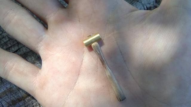

Great photo!, tiny hammer!
Maybe a cross-wedge next time?
I owe that to the cheap smartphone lens kit I recently picked up, the Macro lens really makes such a major difference.
Next time I will probably cross wedge it, and maybe use something other than a twig for the handle.
I think the grain structure of the twig just made it prone to splitting like that.
Oh and btw I wasn't lying, I really do need to pick up a brass hammer for leatherworking.
I don't need anything big and could probably make one from a piece of 1" brass stock if it's not too expensive.
