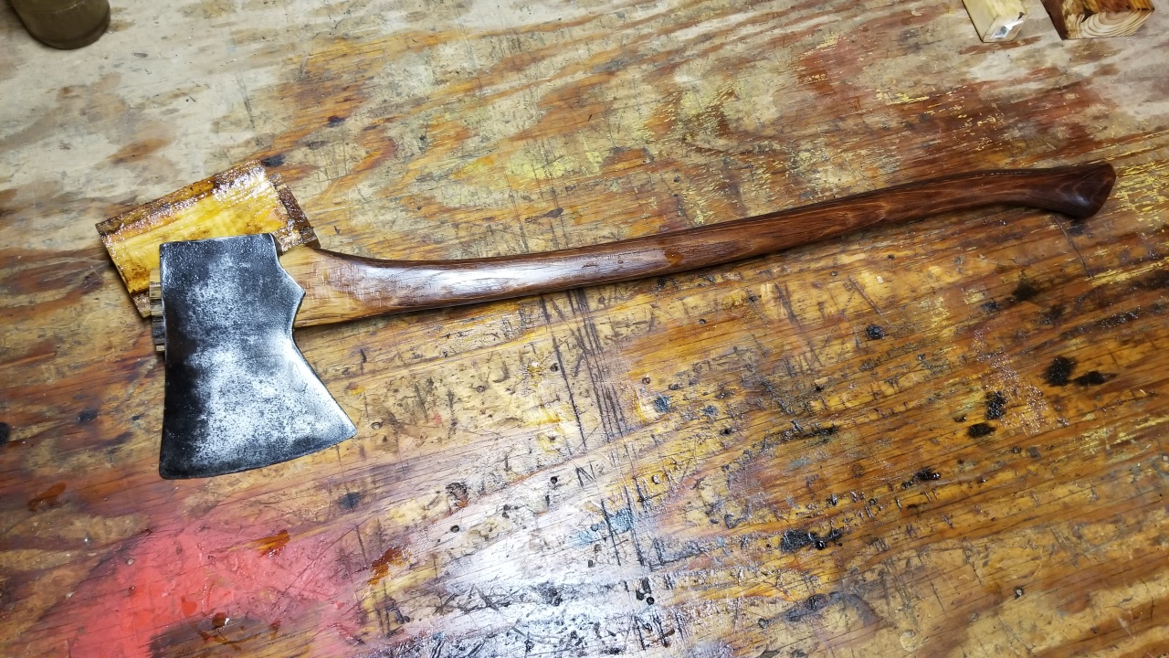

Both good looking hangs on good looking handles!
Man must be nice 16 bucks for a 28 inch handle.Was way far away today and stopped at another ace hardware 14.99 for 14 inch hatchet handles 20.99 for crap 36 in handles.Your an artist itvd.

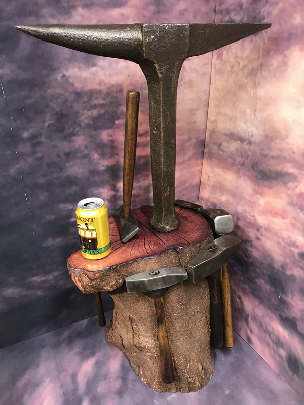

Eh, I guess this counts as “rehanging” my drink holder or cooper’s anvil, stump anvil, Bickern, beak horn, fancy coaster, stake anvil, and regionally a beer mat.
Not sure if the stamp says CROMLEY or CROWLEY. Is there a chance that it’s CASTLE? It did come from England.
I got this gnarled plumb stump and hit it with some Royal Plumb stain then made a hammer holder from a WWI leather strap and rusty 1” antique tacks.

So, I've returned to this and viewed it 3 times now. I have not commented up until now because I did not know if I could find the right words to accompany how impressed I am with this. I'm just going to blurt out well done, this is freaking awesome! There now that is out of the way. How long was the spike on that? Did you core out a hole and then chisel the rest? What was the process? It looks like very precise work per usual. Great job! thank you for sharing!Eh, I guess this counts as “rehanging” my drink holder or cooper’s anvil, stump anvil, Bickern, beak horn, fancy coaster, stake anvil, and regionally a beer mat.

Thank you very much! I was inspired by another I saw and it may not be my last. I got a bead on some in France that are frickin’ insane!! Like from the 1700’s with crazy markings. (If anyone wants a 300 year old anvil and to split the shipping cost for a pallet from Europe let me know.So, I've returned to this and viewed it 3 times now. I have not commented up until now because I did not know if I could find the right words to accompany how impressed I am with this. I'm just going to blurt out well done, this is freaking awesome! There now that is out of the way. How long was the spike on that? Did you core out a hole and then chisel the rest? What was the process? It looks like very precise work per usual. Great job! thank you for sharing!
AWESOME! Thank you for the additional detail. It looks great!!Thank you very much! I was inspired by another I saw and it may not be my last. I got a bead on some in France that are frickin’ insane!! Like from the 1700’s with crazy markings. (If anyone wants a 300 year old anvil and to split the shipping cost for a pallet from Europe let me know.This one was under 40 kilograms so it could go airmail.)
But this stake is 6” long and 2”sq tapering to 1”sq at the bottom.

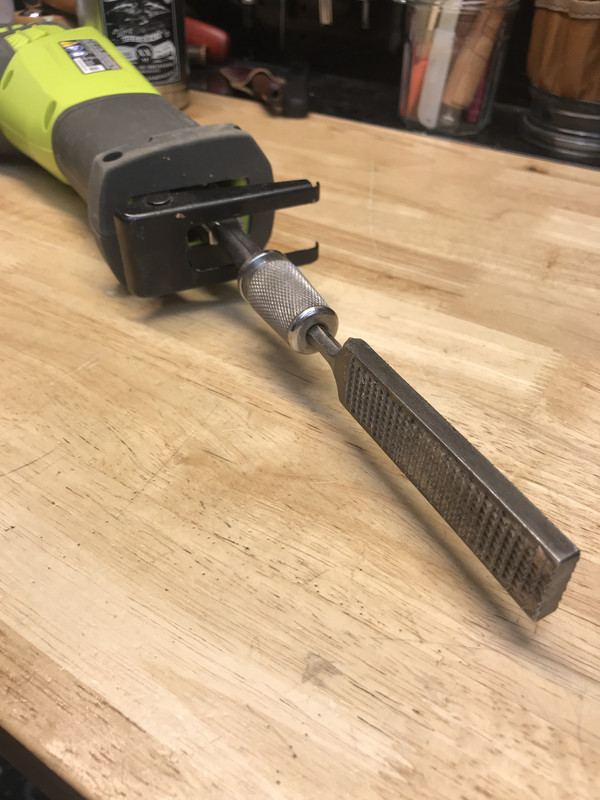

The socket started out as a bit of a chore. It took some drilling, chiseling, and filing. But the wood was so hard and deep in there was still green, it was very difficult to work. The 6” socket started getting too deep for my chisel to be effective. But just in time I remembered this thing that I bought years ago, never had a use for before, and sat forgotten about in the bottom of my sawzall bag. The wood file attachment.
Holy cow! It was made for this!
I wish I had remembered it sooner. It made the rest of the job so easy! LoL
The spike is relatively long for the 18” tall anvil. It can be turned any direction and is very stable when dropped in the socket.
I’m thinking I’ll let the stump dry for like a year and finish checking. Then I might do a crazy color epoxy resin like a pearl purple or maybe metallic black just in the checking. Something like this:

Err aaaah... Good grief! LoL.It's a beautiful anvil stand. But as tough as plumb is I think you would be better off with a round that would better facilitate the addition of a band or two. And I think you would need to bark it. I lean toward utility rather than toward art. Combining both would be cool.
