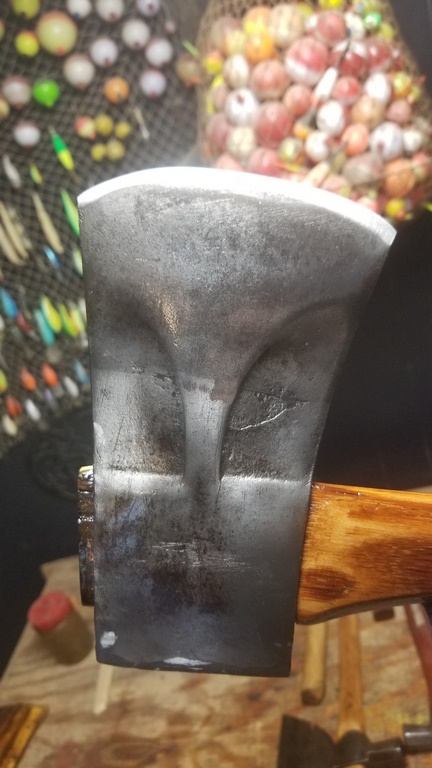

Damn fine job on that did you shape the handle yourself? I’ve had my eyes peeled for a sing song logo for a while now.
Thank you! Nope, it came with the axe. I bought it for the handle. But once Mr. Rust advised me I could save the head, they went back together again. I just scraped the paint off, removed the metal wedges and rehung it.

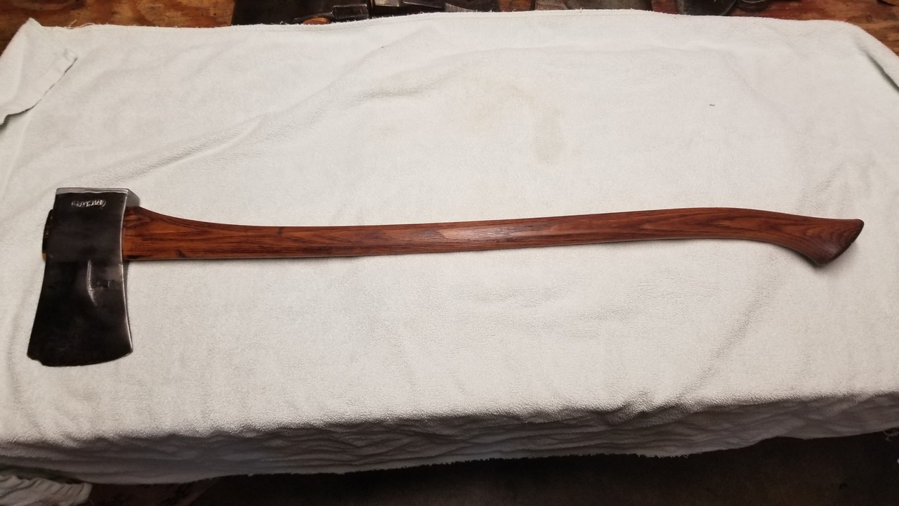

Finally finished this project this morning. It was on a hatchet length haft when I got it. Pretty rusty. I don't have a scale yet, I'd say it's 2 lb head. Gave it an Evaporust bath, sanded with some Emory cloth. Radial grind on bit finished with a puck. The total length of haft is 27" as it sits. The balance is great. Haft had a factory varnish and OLD Home Depot? Sticker on it when I got it with a different head on it. Had a gap in the front, I used a piece of red oak dowel to fill it. Poplar wedge. Hang is slightly closed, and I love the finished product. This thing feels great to handle. I immediately took it out to chop some dead stuff down. Enjoy! Comments welcome! This is my second finished hang.

Feels good to swing a newly hung axe, doesn't it?
Feels great SP! Most of my time swinging was behind a splitting maul when I was about 15-16. I'm 30 now. Use to go with my old man and his buddy to go collect 18ft car trailer load after load of wood, start to finish, hand split it all, to give to some folks/friends in the local trailer park that majority of them heated with wood. We get some brutal temps with wind chill here in Iowa, believe it or not. It's been a number of years since then, and compared to the maul, swinging an axe is exhilarating! I plan to eventually heat with wood myself, can't wait! By the way thanks for all the info you share, I've learned a good deal from reading through your posts, along with many others. Glad to be apart of the community.
