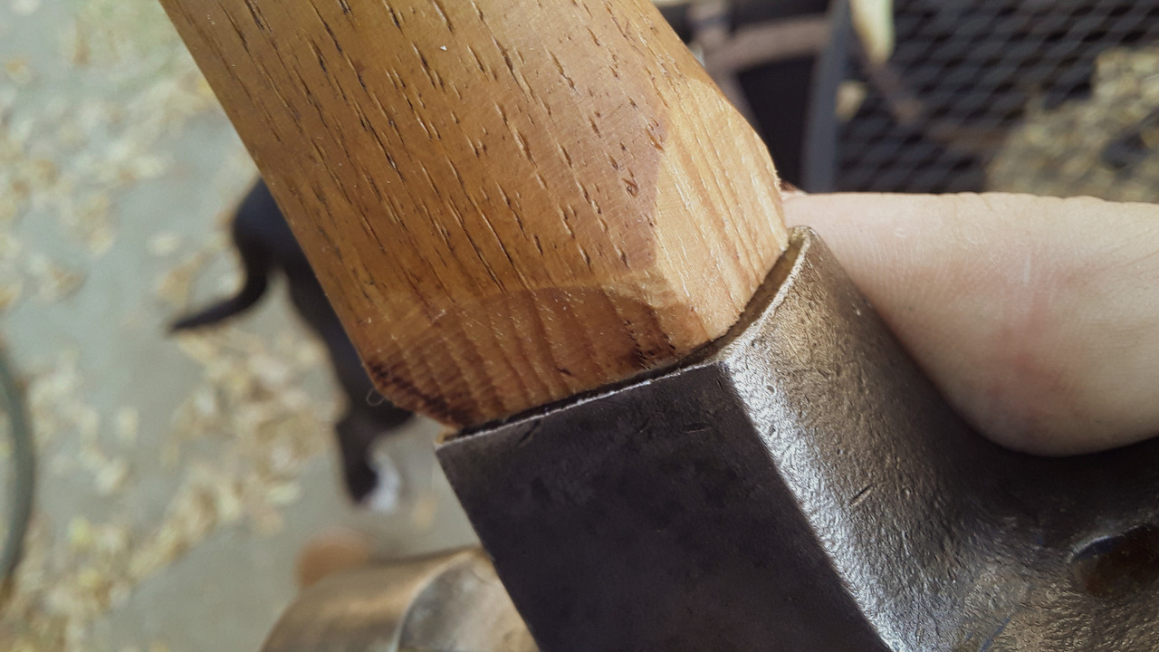

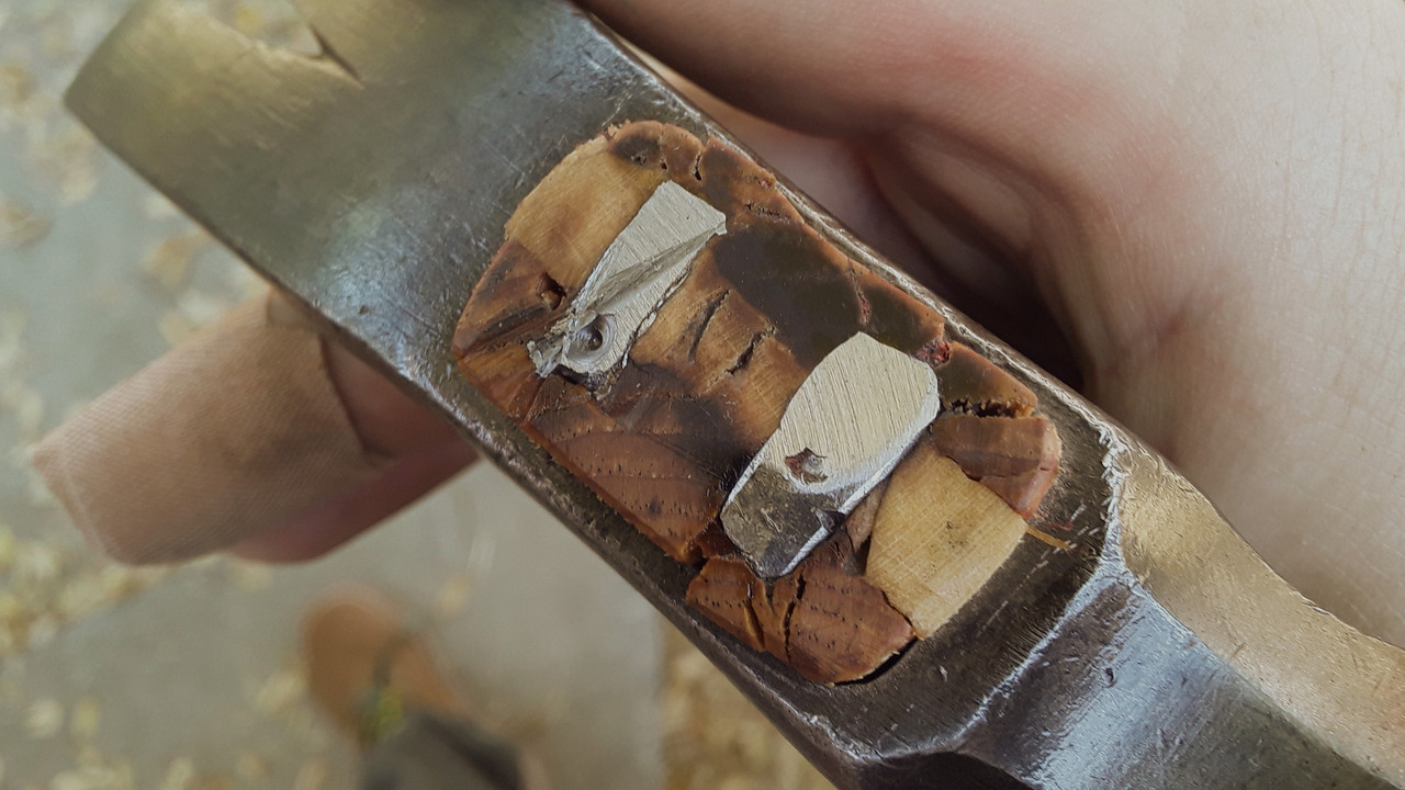

Here is the little Stiletto all finished up, save for another few coats of BLO.
Started with a nice piece of straight grained Oregon white oak, squared up with a plane at the bench and then traced the handle pattern onto the blank. Next it was outside to the shave-horse where the profile was roughed out with a drawknife, then cleaned up with a pair of spokeshaves. I modified one of these to be a round sole for working tighter concaves then you can get into with a standard flat sole.
Once the top down profile is finished I thinned out the 1 1/4" thick blank down to about 5/8", flaring out to the palm swell. When I'm happy with the top and side profiles, it's time to layout the chamfers and bring the rectangular (ish) blank into a nice octagon. Then it's back to spokeshaves, followed up by a card scraper and finally sandpaper to take the handle to it's final oval shape.
I sharpened the head and finished the package up with a walnut wedge. I'm really happy with how this turned out, and super excited to finally add a saddle cruiser to the horde! Thanks for following along!

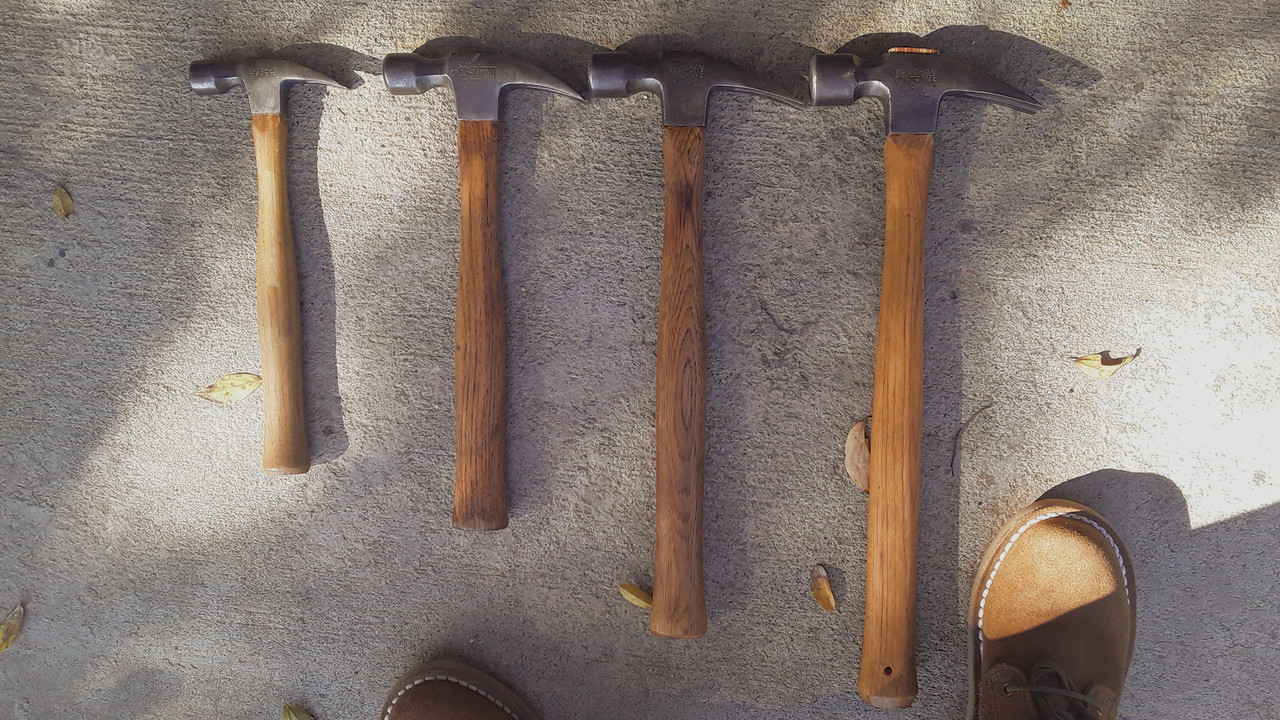

Now I just need the 28oz #606, and the 32oz #707 to round out my set of Vaughan RIP claws.
I have at least two and in some cases 3 of every one of these, but the 28oz and 32oz I don't see myself using much a so I'll probably avoid getting multiples of either.
I can't leave a good V&B hammer behind when I find it though so who knows, but I won't be actively looking for duplicates of the larger ones.
