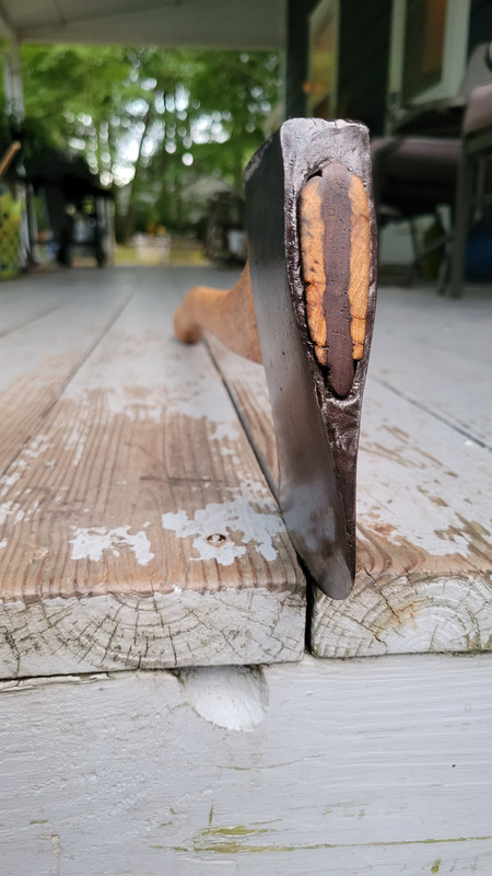

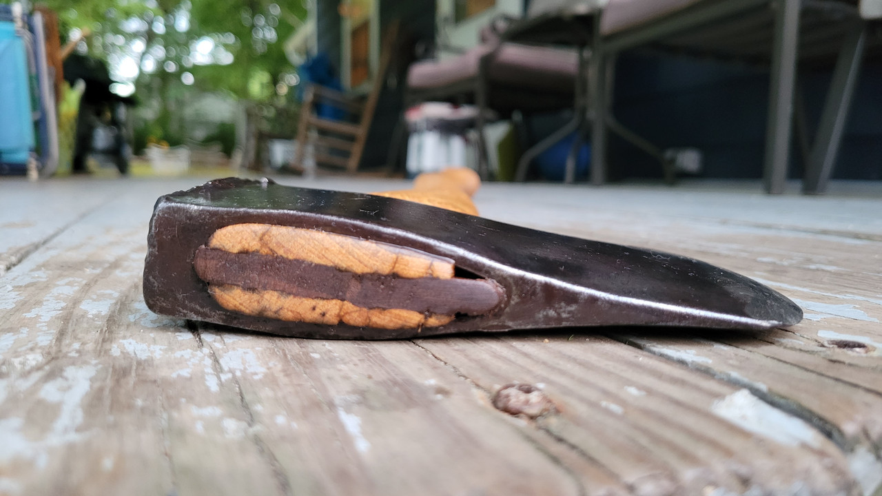

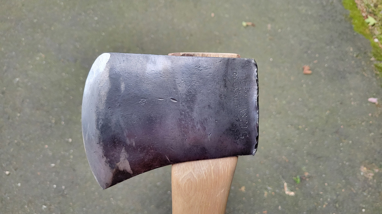

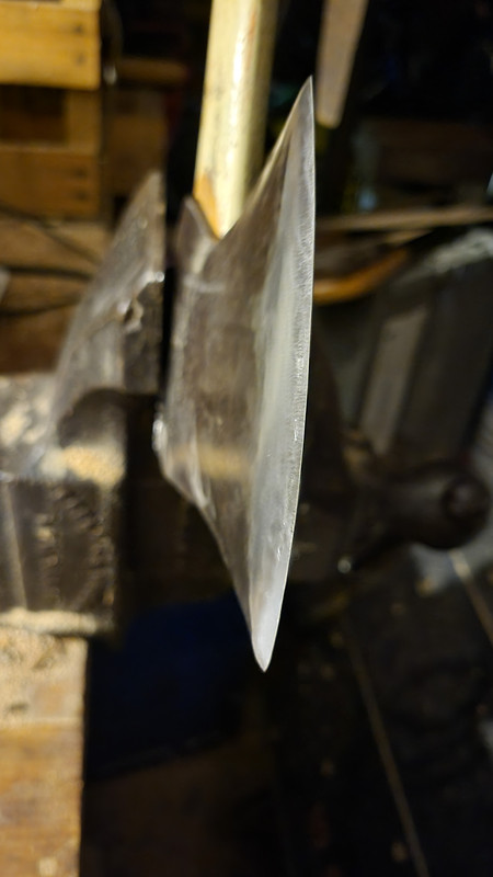

shes beautiful miller, i love the cheeks on it, theyre almost like phantom bevels
Relief Bevelsshes beautiful miller, i love the cheeks on it, theyre almost like phantom bevels
Just well done convex cheeks with a high centerline as an axe should have. This actually works better than phantom bevels.shes beautiful miller, i love the cheeks on it, theyre almost like phantom bevels

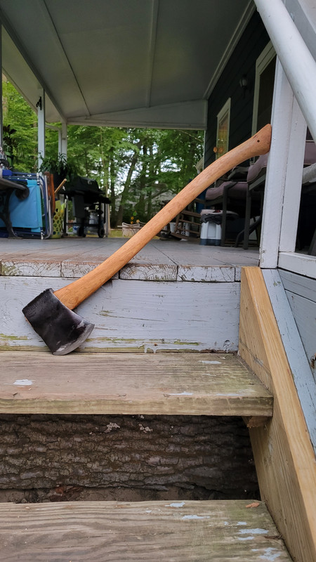

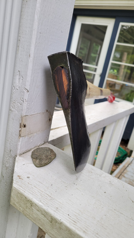

Very Nice!I changed handles on this one, It was 15 1/4" but I have other hatchets on 12 to 14" handles that I liked using better than this one.
15 1/4"
It's now 13 1/2" and I like swinging it much better, the label is just about worn off since I took these pictures. I used a 9" shinto saw rasp on my last two hangs, it's got a course side and a fine side, works great

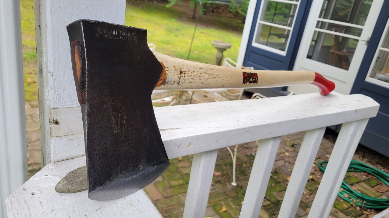

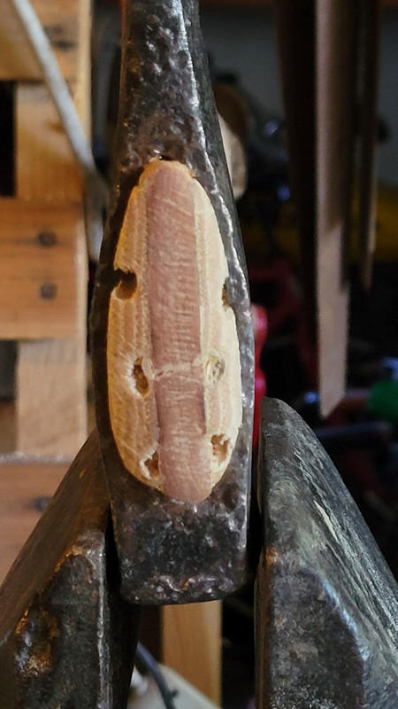

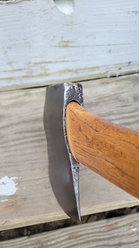

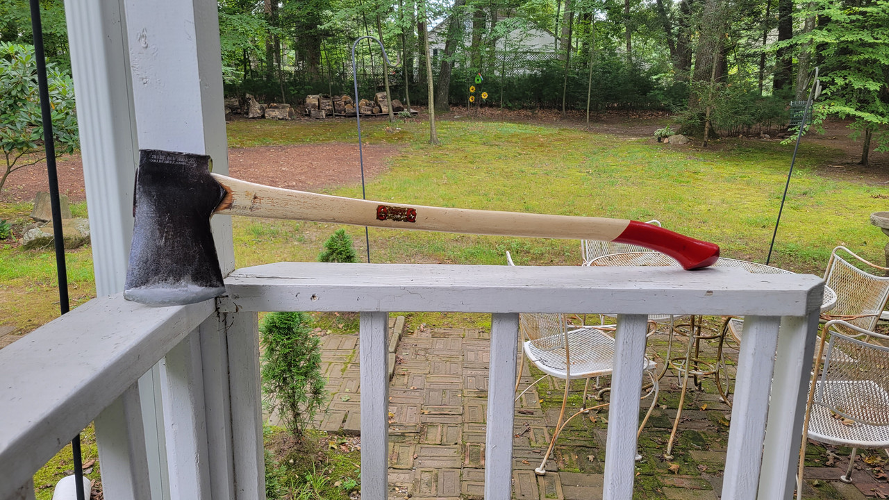

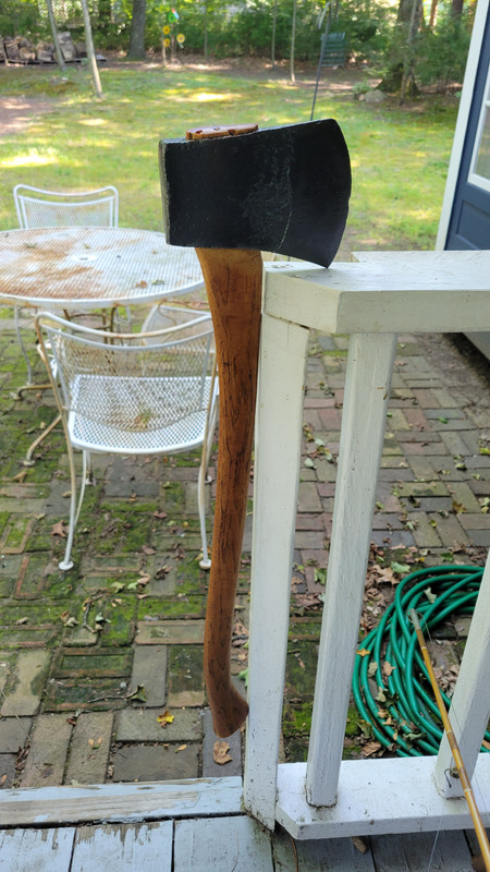

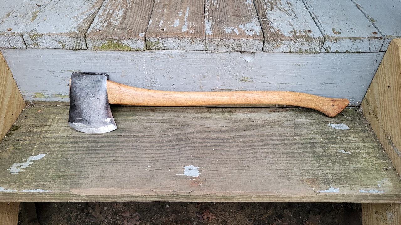

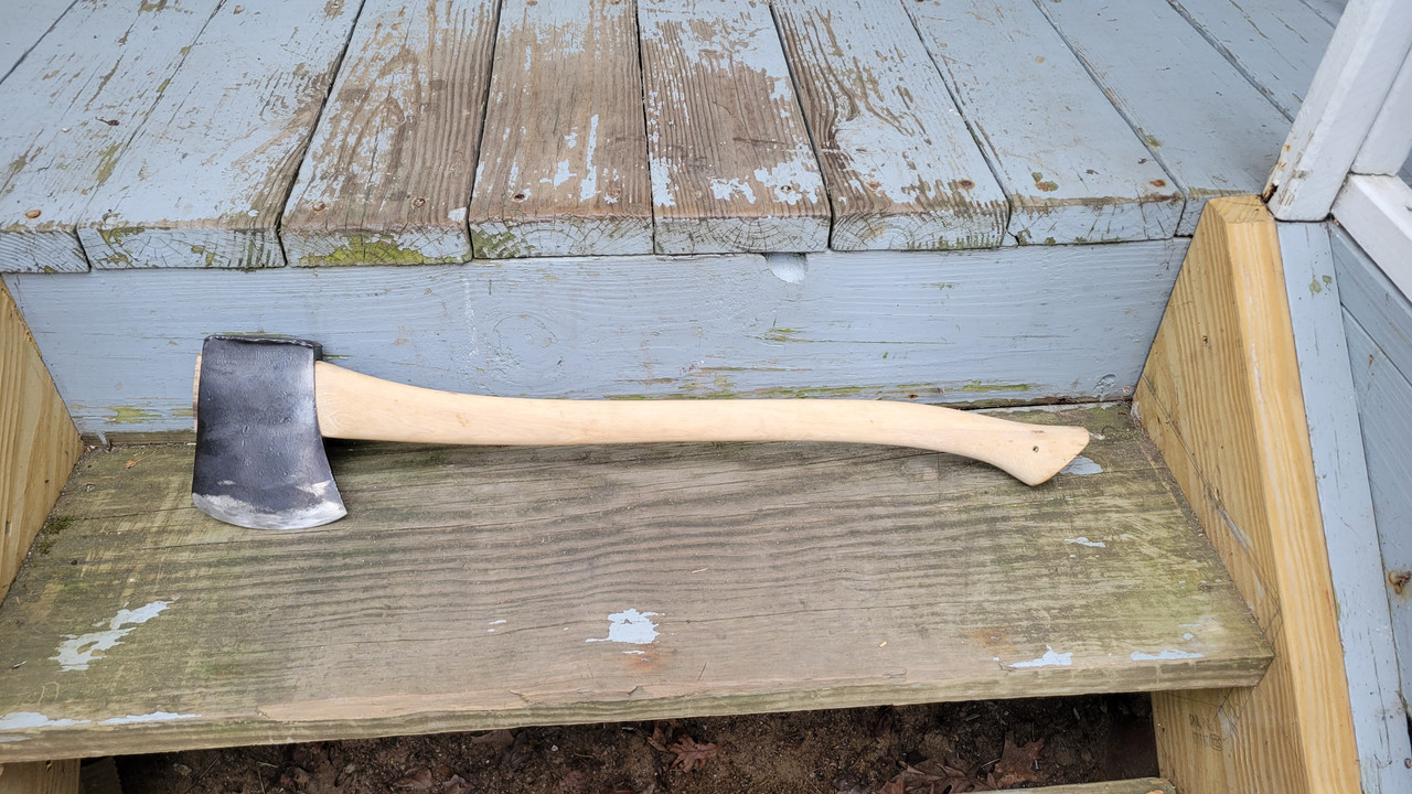

Good job bringing that one back in service!The Two for Tuesday Rehang.
This is a rescue double whamy!

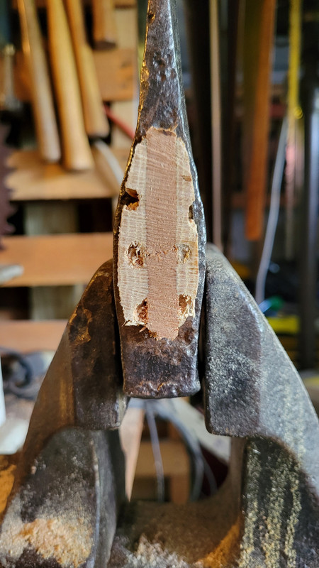

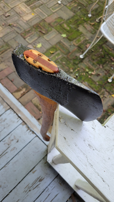

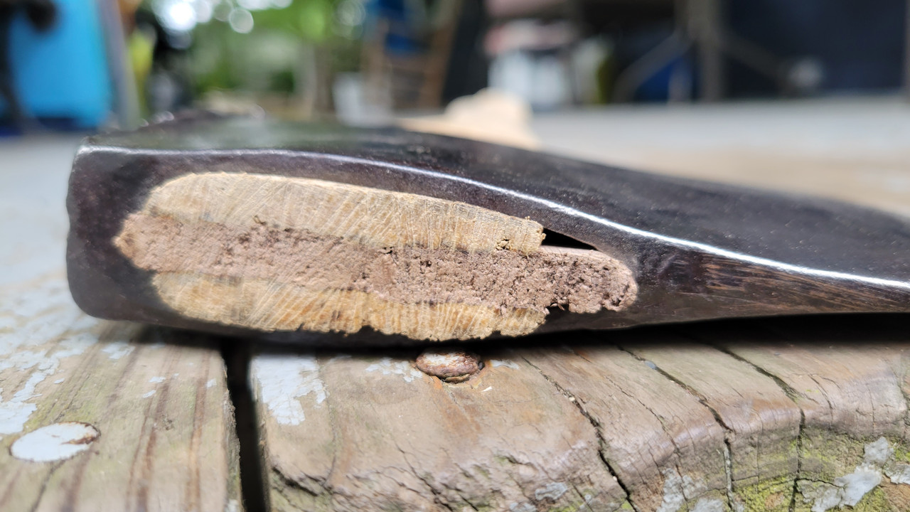

I missed the opportunity to get pictures before of the handle. It had a a horribly drilled and dug into tongue that most had to be cut away, leaving just about 3" to the shoulder.
I had to swallow the shoulder as you will see.
The hang is still tight, solid and full, just needed the shoulder space

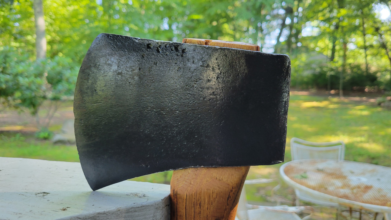

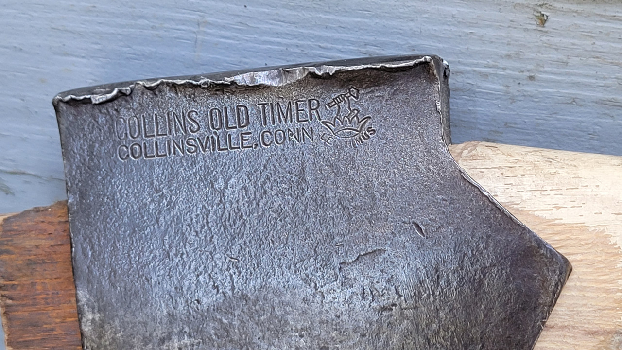

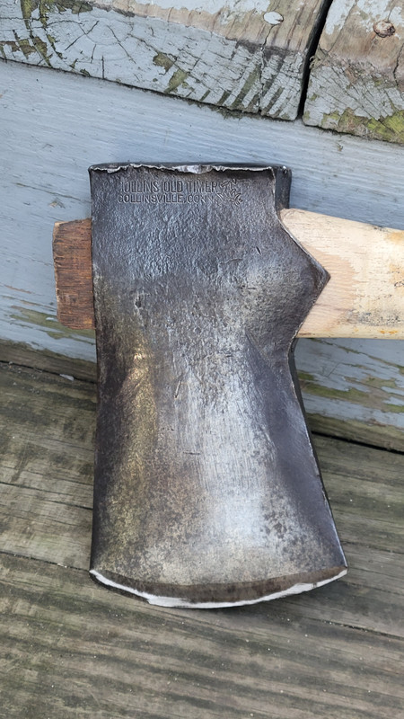

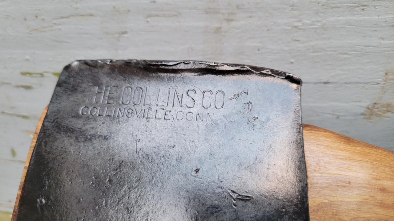

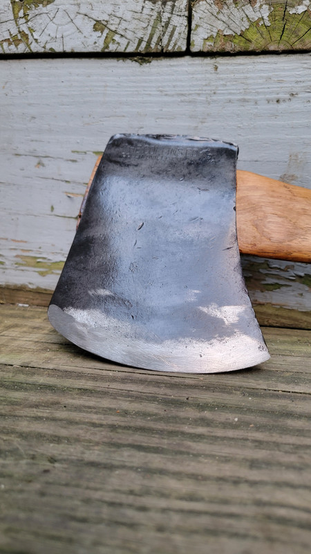

The head is a possible worn and weathered away marked head. It had a wonky bowing eye and seems to have been laying in moisture one side submerged for quite a long while. The profile rust line and the different effects each side are revealed thru different exposures.
Connecticut Pattern
Head alone is 3lbs X 6½" X 5" Bit
Finished out at
4lbs X 29½"
Single Birch Wedge

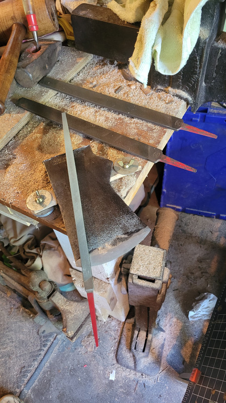

Good way to clamp an axe! And I like your Duff Barrett railroad jack. Peavey handles fit those.
