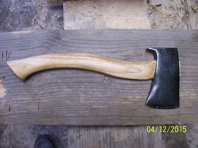

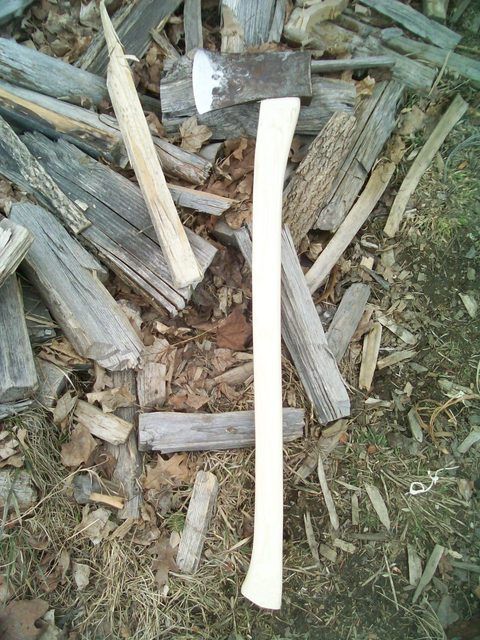

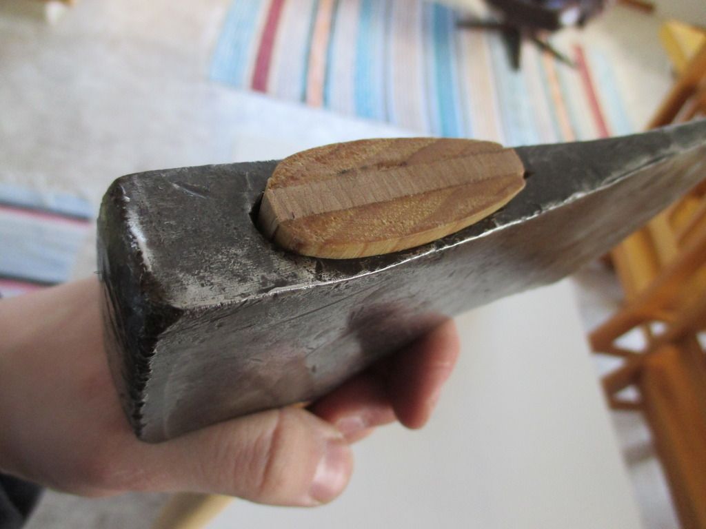

I haven't wedged it yet, but it's at least 85% done. Hickory handle (self made) with a 4LB Collins Homestead Dayton.

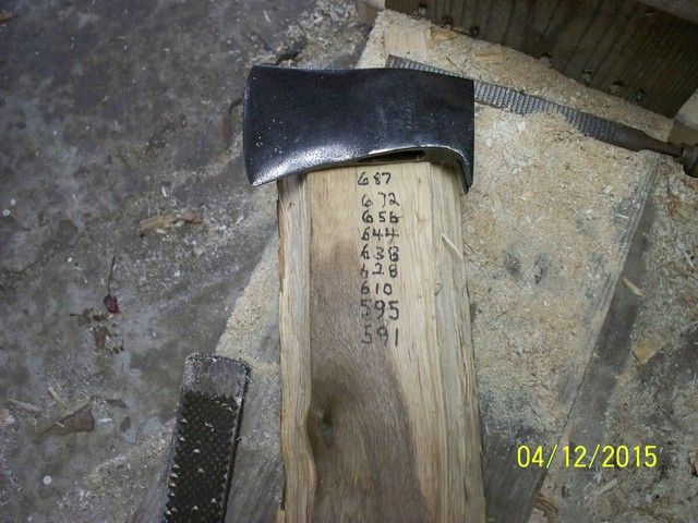

You made a lot more progress than I did today G-Pig. Misplaced my rasp so it's been sllooooow going.
I use a rasp for maybe 1% of total stock removal. Mainly it's useful for fitting the head and getting the alignment right, but I still wouldn't suffer to much in that step without it. My spokeshaves, on the other hand, do work, along with the low angle block plane (the secret to straight and true handles on the flat plane) and draw knives. And of course the hatchets. A regular double bevel, and a Plumb side hatchet that is just a wonderful, if not admittedly specialized, tool.

I put it on the scale in the kitchen and it came in over 3 3/4 pounds so I believe it was 4 pounds originally, it has lost some because of bad mushrooming on the poll. It's a 33" handle.

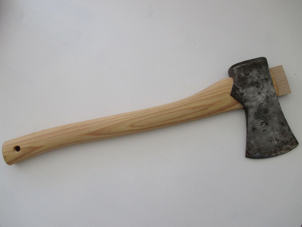

Just finished this one. Master Mechanic in Hudson Bay pattern with a 28" hickory haft. May just keep this one!

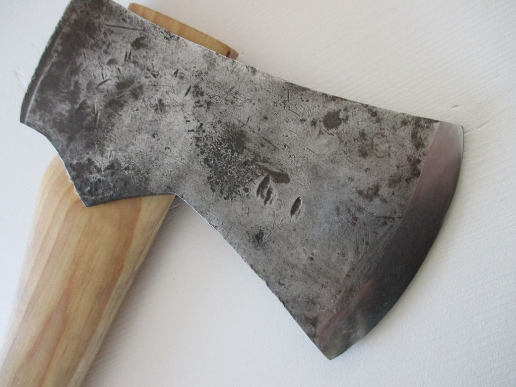

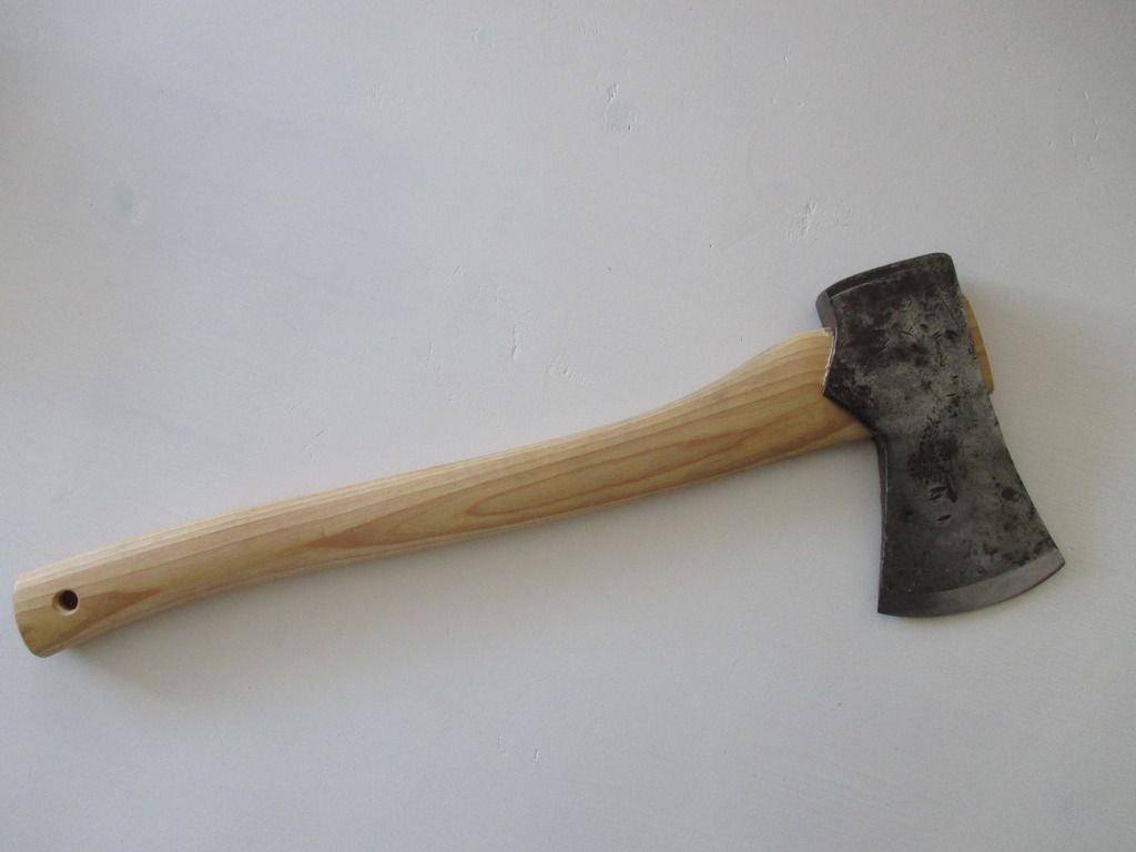

I don't really know what to call this axe pattern. Very slight rounded lugs and a fairly long bit. It isn't really what I'd call a Jersey (Jersey inspired?).

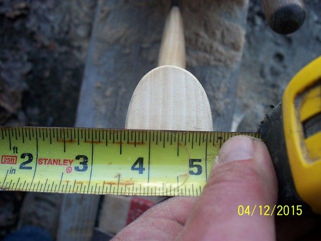

Handle is about 30" long white ash with a beech wedge. I have yet to sand it or oil it. I wanted to test the edge and working qualities before I put more energy into it. Cuts well and hits where I aim it. Did a nice job hewing up a small timber which will end up being some knee braces in the shed project.
