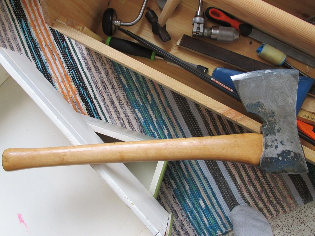

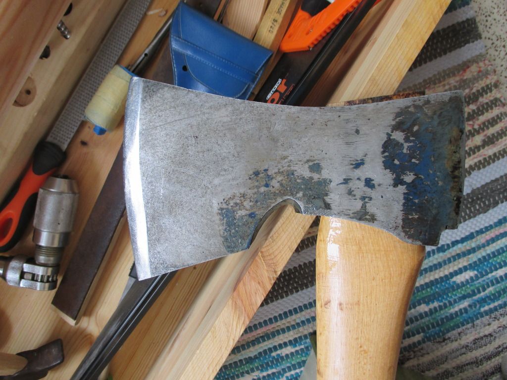

Old Gränsfors Bruk carpenters axe with birch handle
Quite the novel-looking critter by north American standards, but looks to be downright handy for all kinds of work! Any chance that the poll is hardened? Only other light-coloured Euro tool wood I can think of is Beech but I suspect your guess of Birch is probably correct.
LOL, I believe the design is heavily influensed by Hjärtum, the most beloved carpenters axe in sweden. The poll is not hardened, not what I could see after the vinegar bath. The handle could be made from beech, I'm not too familiar with beech tho, either way the handle is dense as f-k.

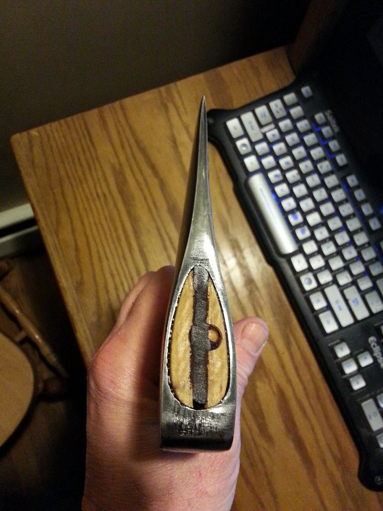

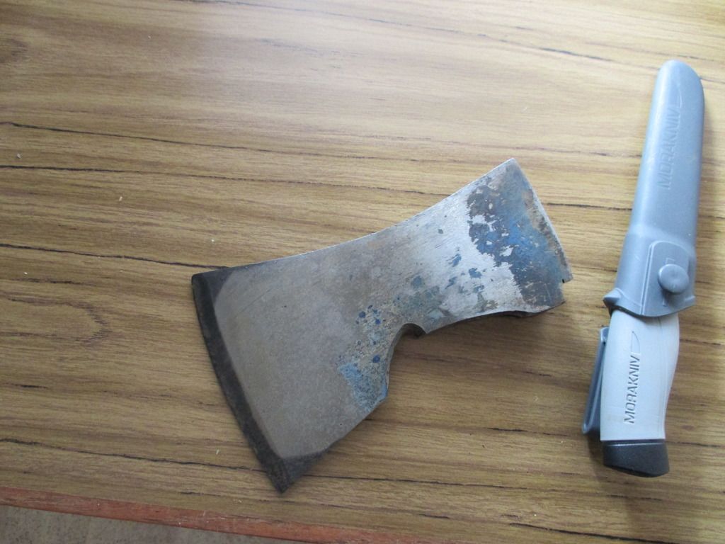

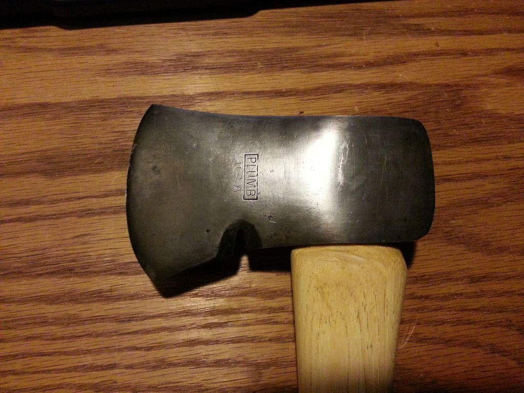

This is a great quality Plumb hatchet head and a House handle hatchet handle. I picked these up a couple of weeks ago, the head was fit with a hand held rasp and a Mora 106 carving knife. I recommend that knife to anyone. I would normally like the handle a bit thinner, but on a 14" hatchet I'm good with the little bit of extra weight. This whole tool weighs 1.75lbs. The wedge is mahogany.
Nice job JB, that head looks familiar...............
Haha, was wondering if you would see it. That handle took some time, a good amount of wood needed to be removed for that fit. I like it though.
I'm planning on coming to see you again soon, maybe you want this one back?
Nice hang on the little Plumb JB. Its almost un-real how under valued these great little hatchets are.

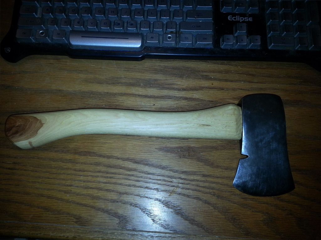

Just finished this one. It's a 3 1/2 LB POWR-KRAFT. Always wanted to do this pattern - this is the first one. The head was in decent shape when it arrived - just a little clean up and a good sharpening. Took a Garant 36" Fawn's Foot haft, shaved it down a bit and sanded. I picked this haft for the nice, straight grain (a rare find in this city) but also because it had a couple of nice heartwood features. I used Tung oil for the first time rather than BLO. It has two coats now. Using 400 grit to light sand between coats. Will do another 3 coats. It seems to work well. The ridges inside the eye make it interesting to attach the head to the haft, as in, you better know what you are doing.
That's neat! Good job, looks like a rock solid hang Curt
JB - I like those those Plumb Boy Scouts. Yours looks to be in really nice condition. Don't think your handle looks too thick.
Curt - that powr-Kraft looks great as well. How do you find the steel on it?
Nice one Curt Hal, my first axe and first hang was a PowrKraft Dayton with ridges in the eye. Its a great Axe, I'm sure you will enjoy yours. The combination of eye ridges and phantom bevels on yours makes me think its a good chance these were made by Kelly.

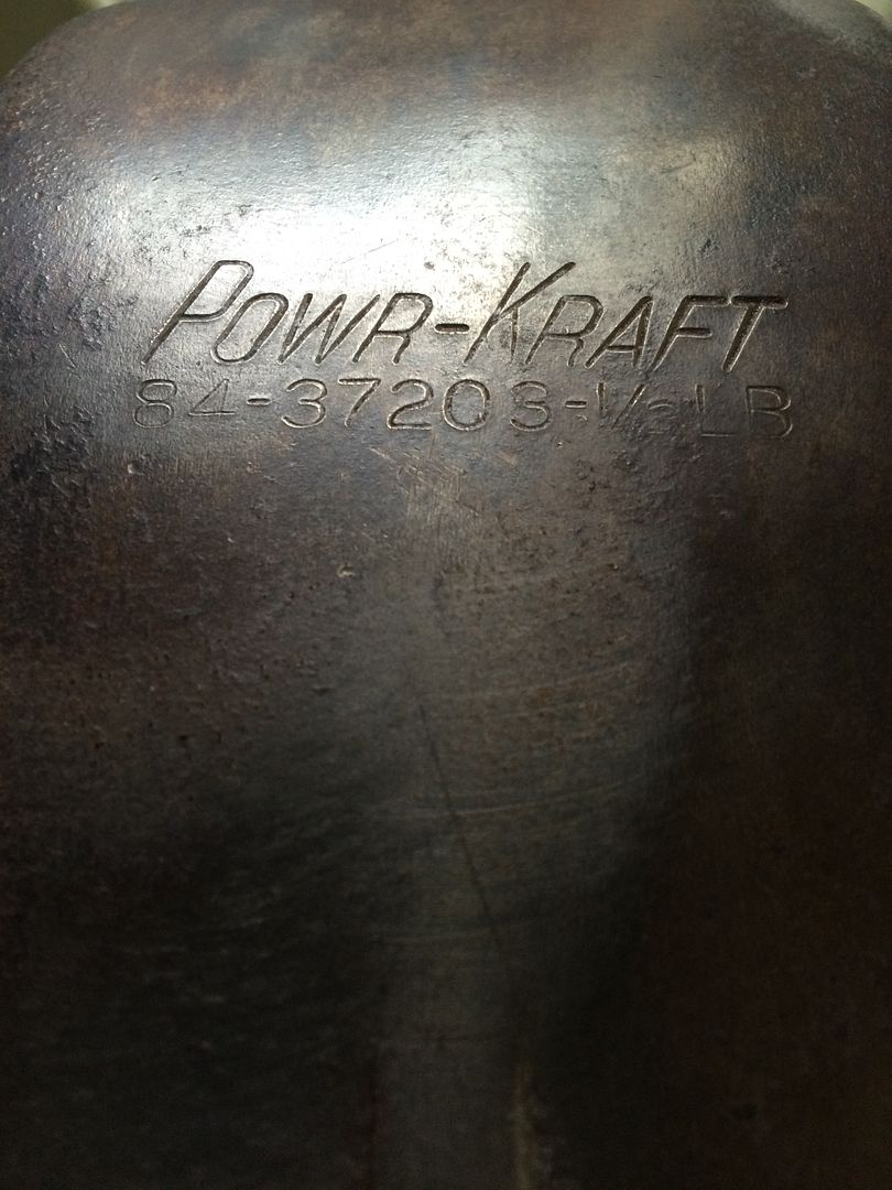

I don't find too much info on POWR-KRAFT. Mine has serial numbers of a sort on it. Wonder if there is a way to place them? Maybe nothing to be had from it but I'm curious now.
84-3720 - made in 84'?

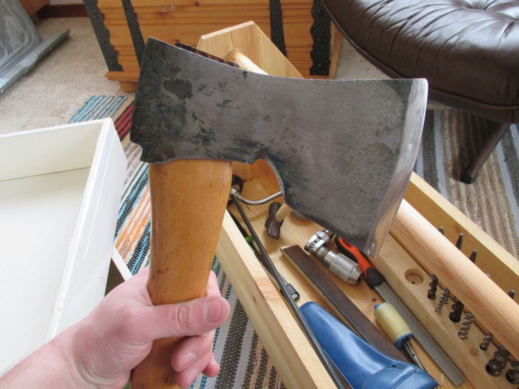

I love that axes profile. Looks like a great one.
I don't know why I am so surprised to see a carpenters box there. Maybe its because it has been so long since I have seen anyone carry one. They are so much better than a canvas liner with pockets that they make for buckets these days.:thumbup:

All I know about the brand is that it was a Montgomery Ward house brand. Mine has a very similar number stamped on it, I want to say it also starts with 84 or 8? I'll have to check tonight when I get home. I've been more than happy with mine. I'm thinking about taking the handle off to thin it out and reshape it. The head definitely seems deserving of the effort.

I think you can find the old Montgomery Ward"s catalogs on line. Probably have a good chance of matching numbers. The quality of things back then was amazing, compared to what is offered today. Some of their firearms were also very nice.

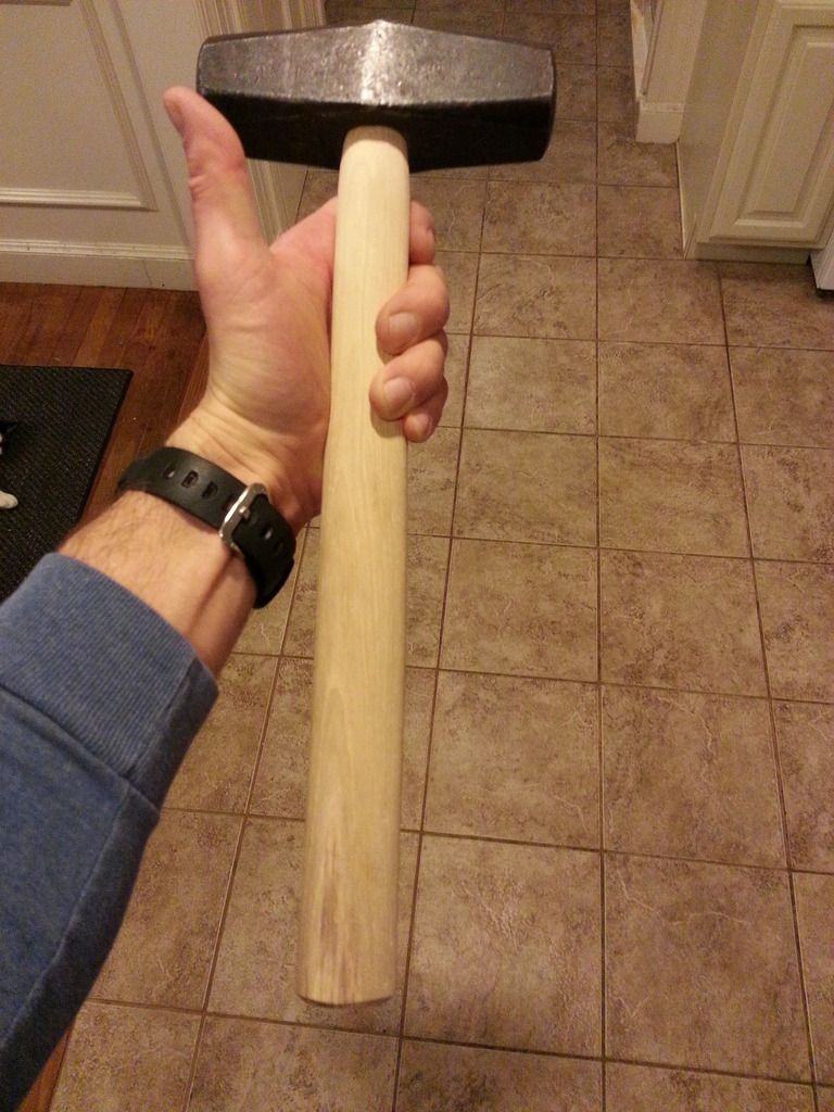

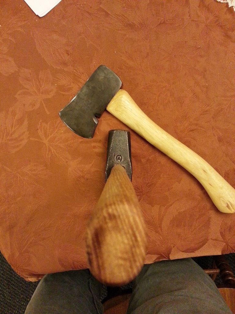

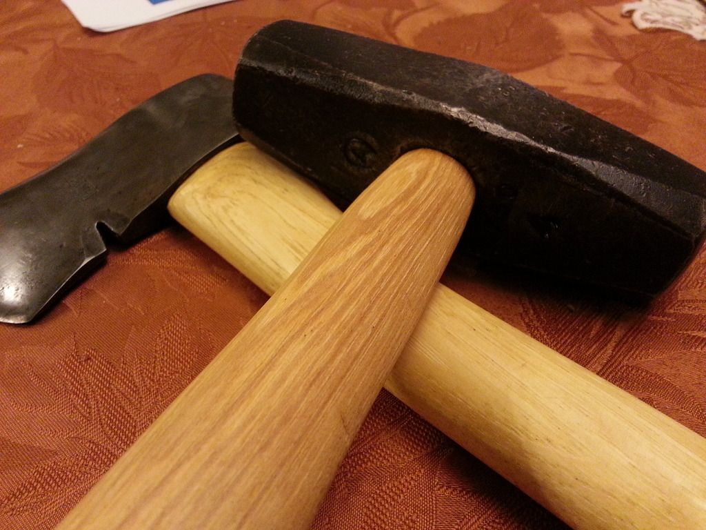

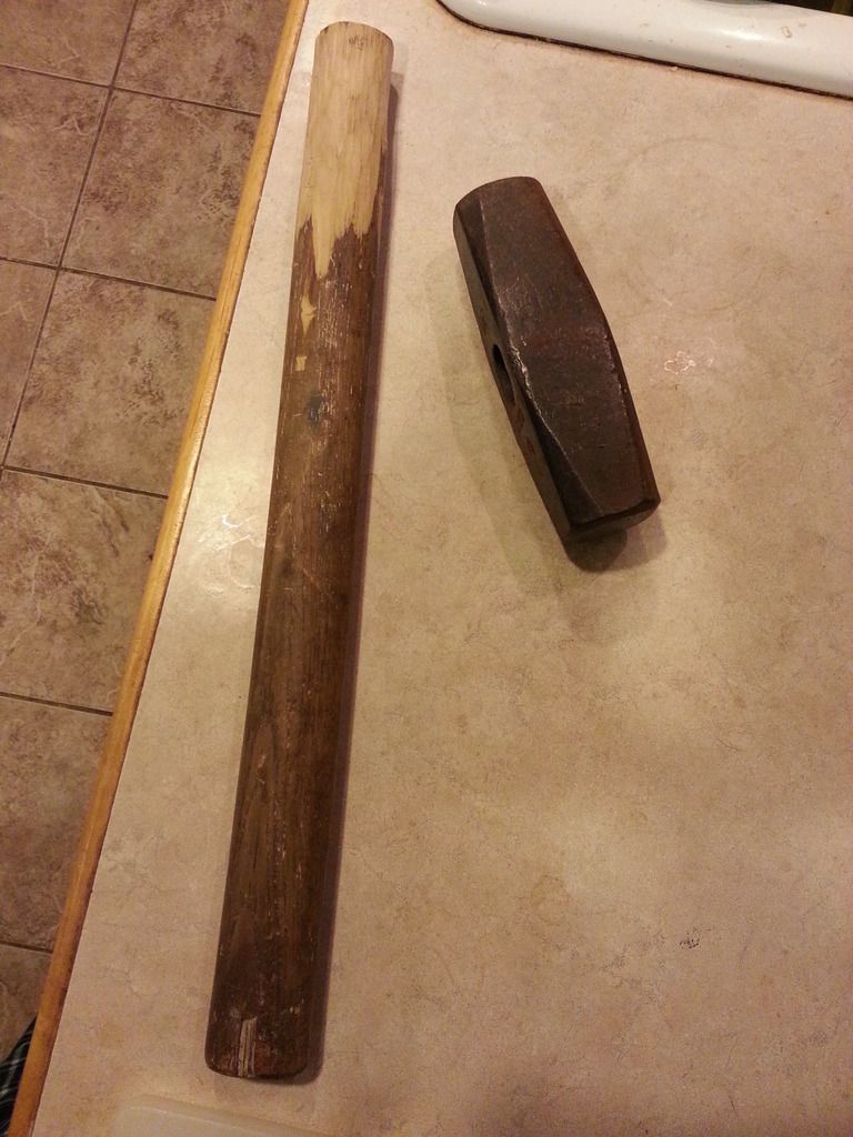

New fun project, a 4lb Atha sledge head on a handle cut down and thinned from an old 36" sledgehammer handle. The result is an awesome old sledge that has an almost 6" long head, is 15" long and has a total weight of 4.5lbs. Pictured with my recent Plumb hatchet rehang. All work aside from cutting the handle shorter was done by hand with a rasp, file, Mora knife and sandpaper. Then oiled.
