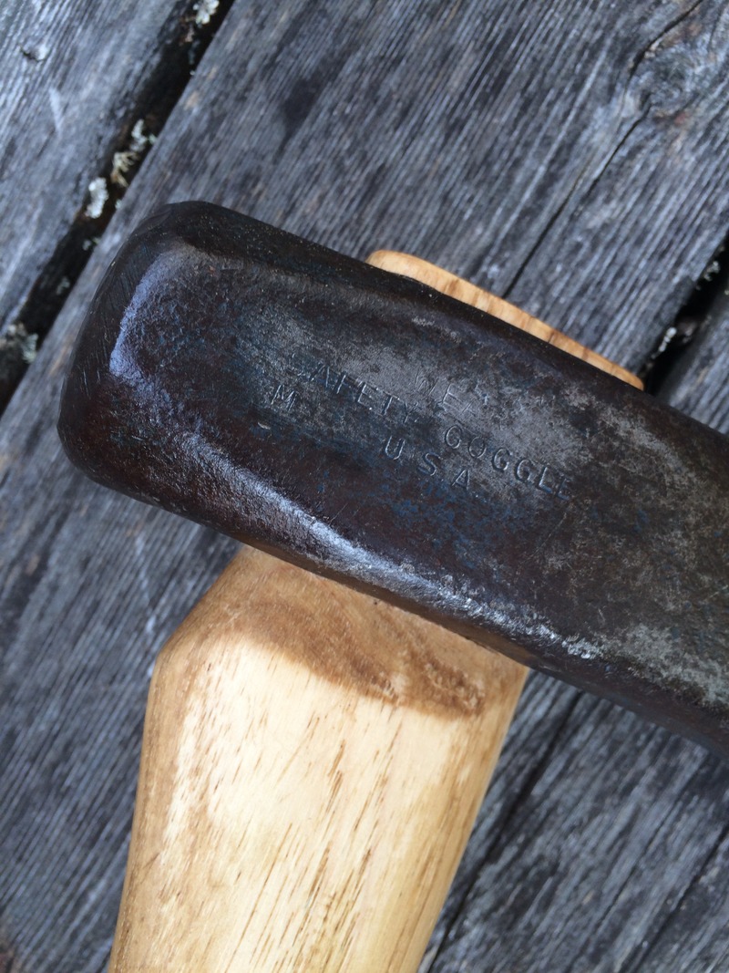

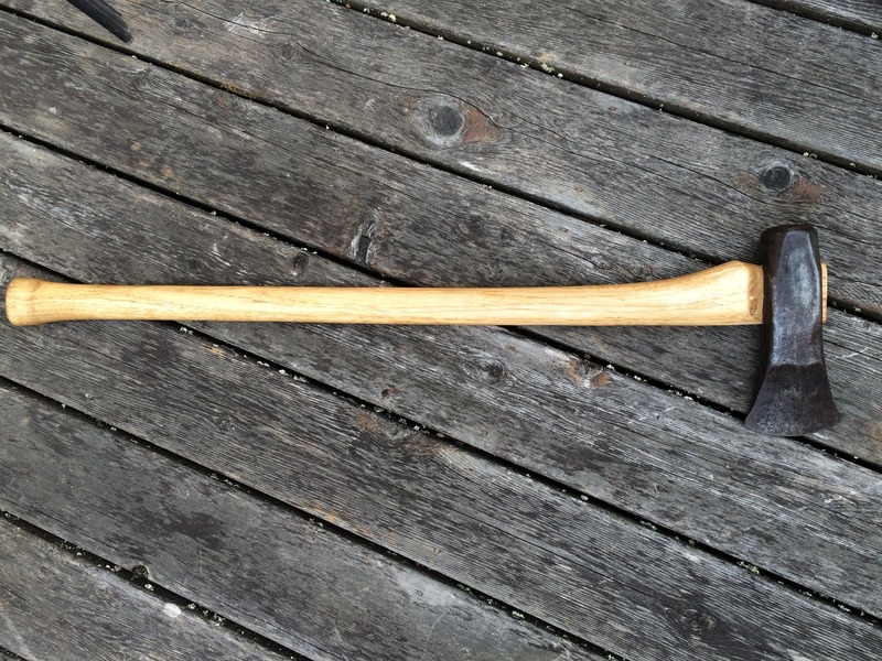

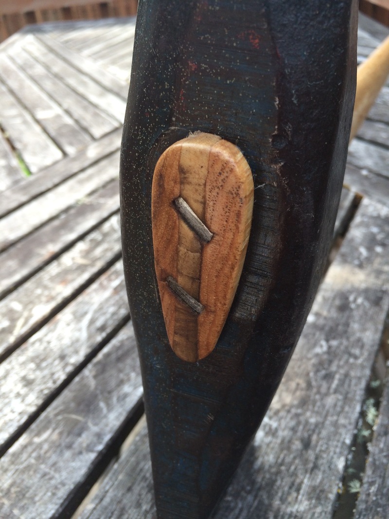

There isn’t too much aesthetically pleasing about a basic maul but this one’s handle was a recent casualty.
Pig with lipstick is still a pig. She gave up the pageant at the swimsuit competition. Sharpened enough to make it usable.
This is the only tool I have put steel wedges in- other than a hammer I hung several years ago.

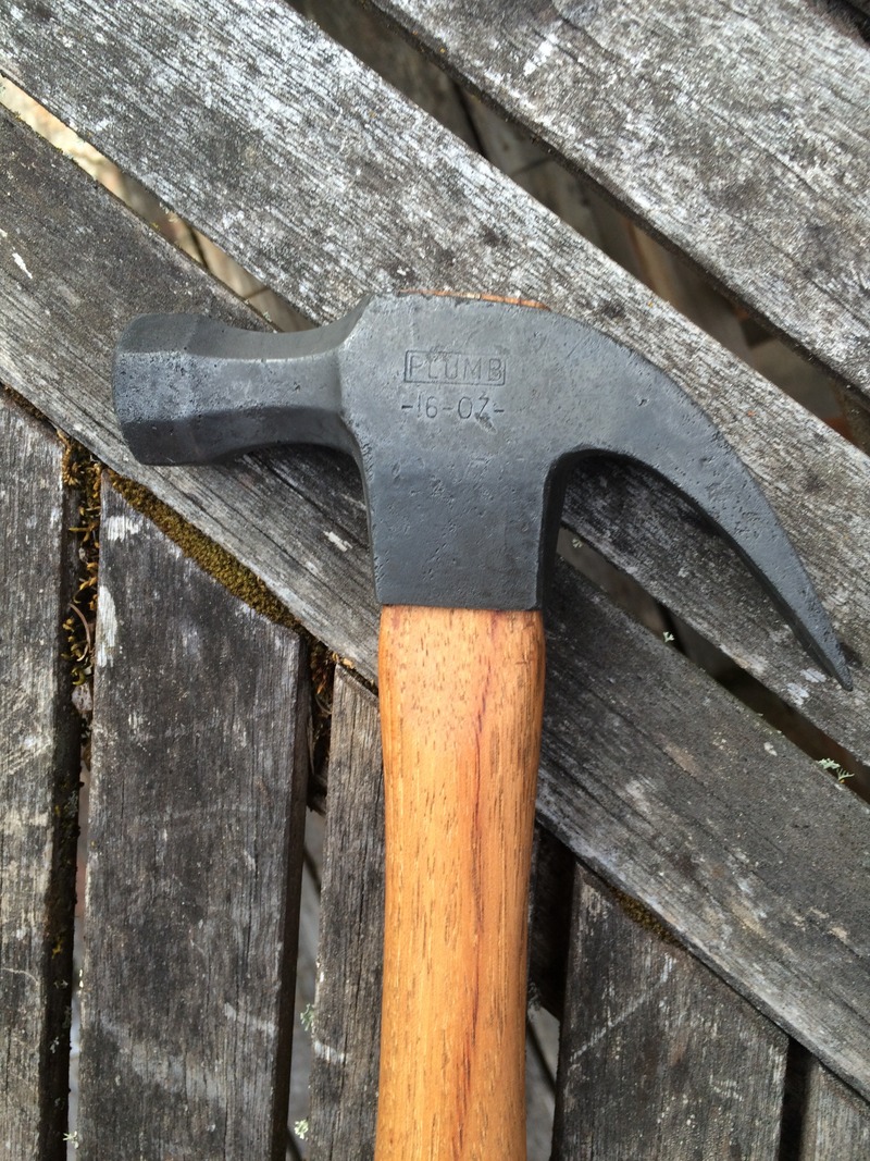

Oh, and speaking of hammers… This 16oz plumb has been shuffled from corner to corner, drawer to drawer for about a year.
I assume it’s not old but now that it is hung it will get used more than the fire axe I am sure.

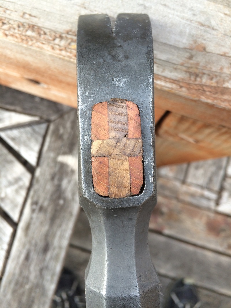

This is my first attempt at a crosswedge.
That space on the Plumb's wedge-work doesn't extend but a touch- couldn't put more wood on it than it came with (that would be great though!).
Thanks Square_peg. Figure it's good practice for larger hangs. Followed some advice from the COTS thread here.
Annoying when the stick comes short .... we know that extra wood is just shavings on the shop floor somewhere AND while not as much the case with carpenters hammers, no two hammers have the same eye so there is no point in attempting to standardize the handles. I think you did a good job as well. One trick with the cross wedge - and you may already understand this so forgive me - the first wedge (the long wedge in your case?) can't be any wider than the handle. Because, once you drive the second wedge, you're going to spread the first wedge. Does that even make sense? It's not what we typically do with an axe. I always use a wedge that is as wide (or slightly wider) than the eye, right. But when cross wedging the first wedge can't be that way. The second one can. Hammers are terrific practice and I've hung far more of them than axes. Anyway, even with gaps, my feeling is that the cross wedge = hung for LIFE! :P At least my opinion is that they really work.

COTS- thanks for the tip on the first wedge not being wider than the handle - Didn't think of that, not sure I would have.
Did you arrive at that from several tries at it?
The hammers/tools that you have cross-wedged (and not) are impressive.
Looking your thread again it looks like I ran the single and parted wedge pieces "backwards"?
Yeah I realized this from doing it the "usual" way a few times. What happens is, if it is already the width of the eye, the first wedge prevents the second wedge from really doing anything. If it is only the width of the handle, then it can spread open with the handle. The second wedge can be done as usual. Essentially you're trying to spread the handle front and back with one wedge, then left and right with the other, so you sort of have to think of it in steps. I did my first one the same way you did yours. I'm not sure there is a right or wrong, I just "decided" that I would do it the way I do now.

I appreciate knowing that COTS. I have a Skookum WPA sledge and a few other large hammers that I have yet to hang.
I think you're doing it backwards. For me cross-wedging involves 3 wedges not 2. The first wedge is the across the eye in its shortest dimension. The main wedge is cut into 2 pieces and driven as 2 separate wedges.
That works too but I just split the first wedge with a chisel once it's in. Strikes me as simpler. The second wedge will drive through the first one no problem. It is entirely possible that I am failing at putting it into words. I may just put an illustration in my project thread.

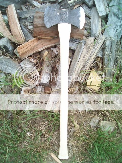

Here's an old Marshall Wells hardware Co. I rehung on a fine Hickory handle, which this ol' fella deserves.

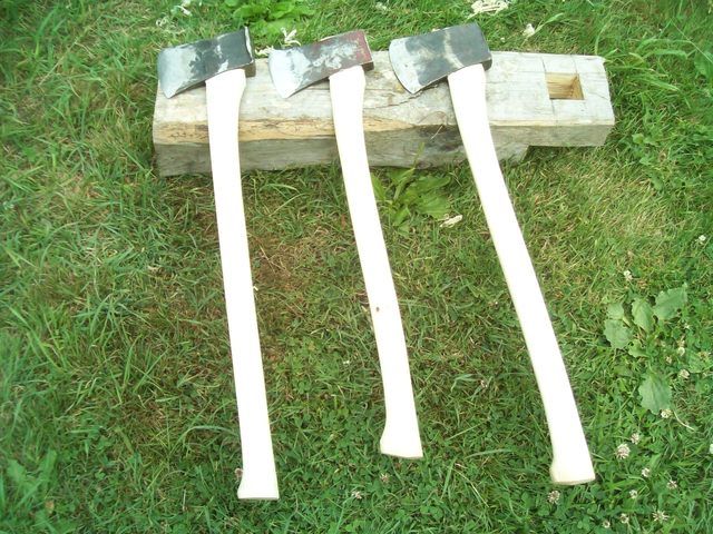

Also, a few more close to finished; a 3 1/4 pound KATCO (King Axe and Tool) on a 30" Ash, a Kelly Woodslasher boys axe (my very first vintage axe, sentimental as such) on a gnarly Hickory handle with knots (lots of character), and a 3 lb Rixford Connecticut on a 31" Ash.
That looks like a nice old reversible peeling pattern double bit there G. I don't see too many of those. A three pound Rixford Connecticut would be a thrill to find as well. Good job on the handles.
Your handles always have a very distinctive look G-Pig. I love to see you handiwork. I have an identically shaped Katco in the 2-1/2 lb weight category. It's my favourite.

Nothing wrong with those Wood Slasher boy's axes. I have one marked on and two I suspect to be same unmarked.
The light exposure keeps me from seeing the handle details but would like to :)
Especially the "character full" one.

Unfortunately I am a better wood worker than I am a photographer (obviously). I'll dub around with the camera at some point because I too don't like the way these pictures have been lately.
You can see one of the knots on that handle in the middle. The other is smaller, lighter in color, and right next to it. Apart from those, the grain was just nuts. It was absolutely a test of my skills to end up with a serviceable handle from that piece of wood. I used a finely fettled low angle block plane (which can cut without tearing out-- at least some times), a rasp and a scraper pretty extensively on that one because of the wonky grain.
