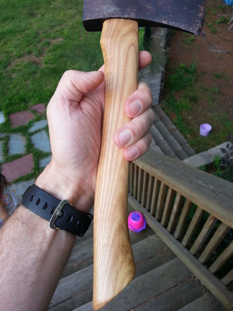

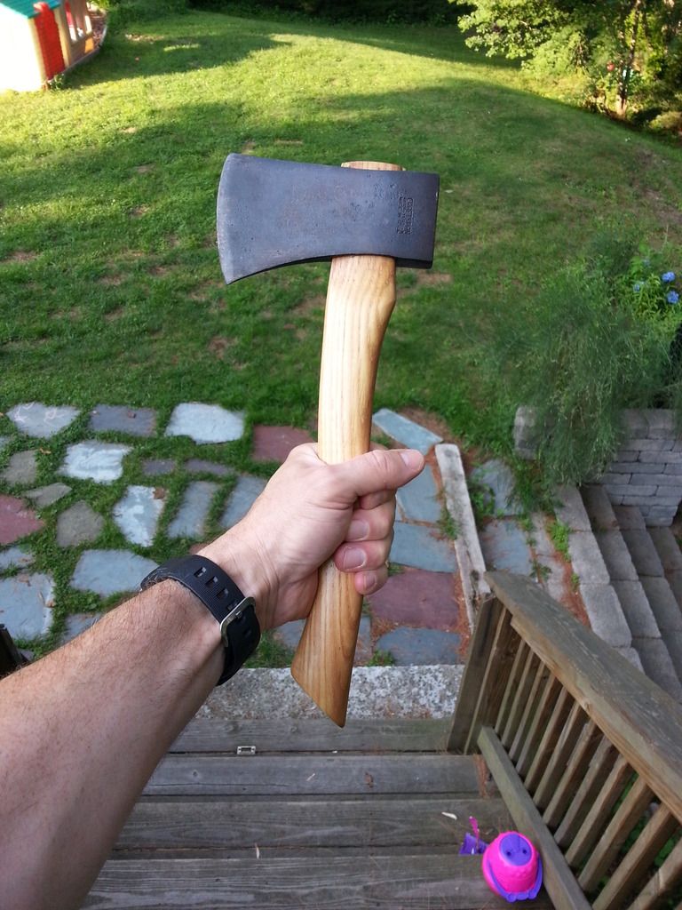

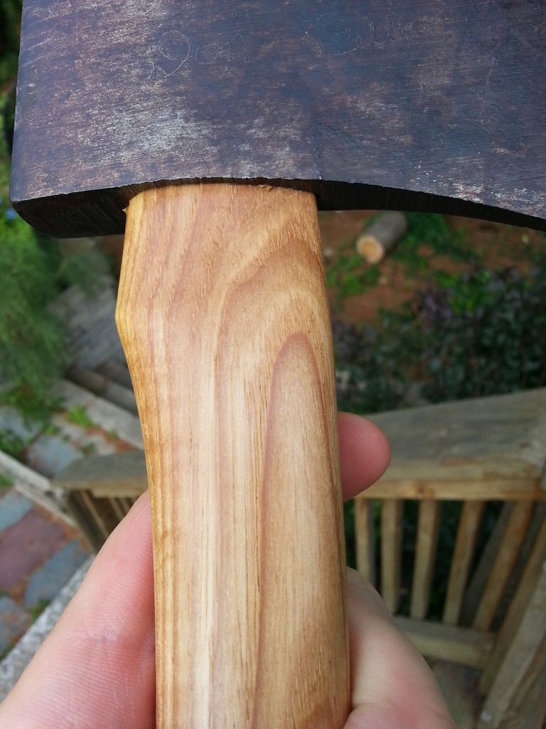

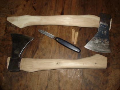

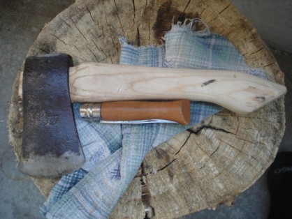

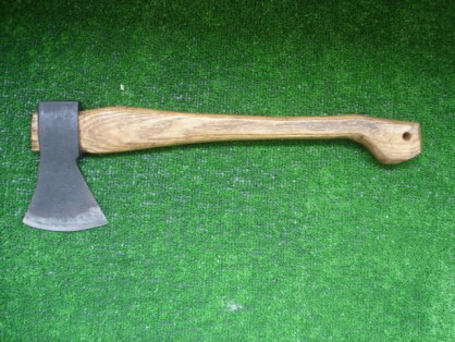

Did up this Flint Edge, first time having to carve away wood for the ears, definitely a learning experience.
I think it looks great Smith, where the lugs meet the shoulder - doesn't look like your first time.

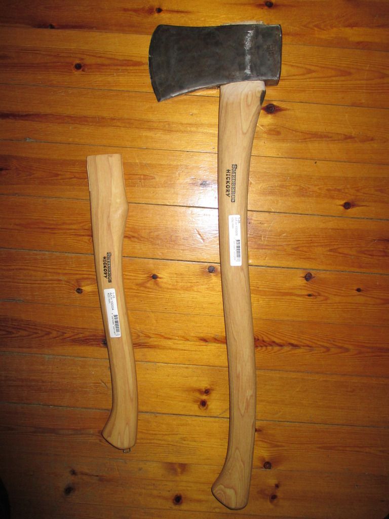

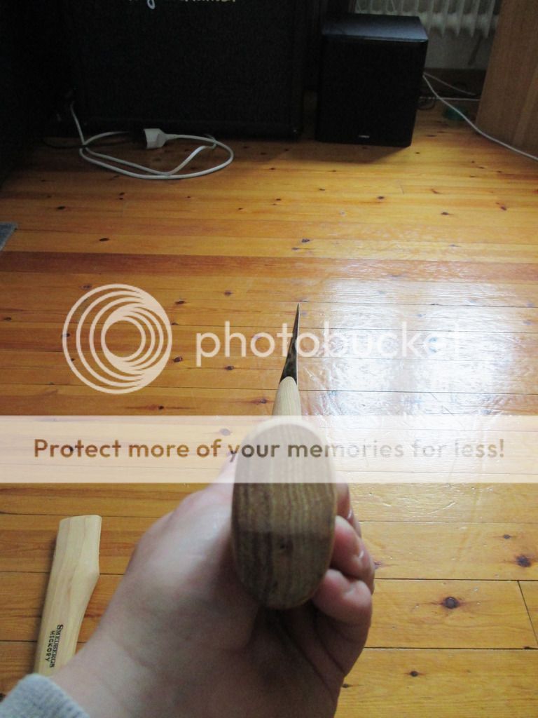

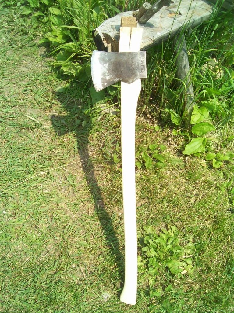

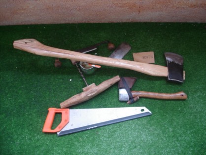

I went to the only store in Sweden that currently stocks decent hickory axe handles and picked up a 650mm for my military surplus and a 400mm for a hatchet.

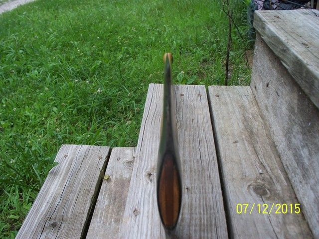

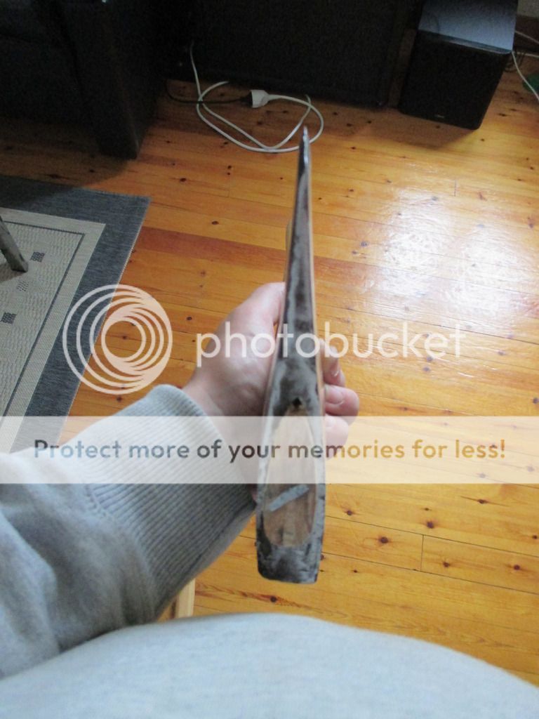

Unfortunately I was so excited to hang it, I completely missed checking the alignment. It's waaay off, but I hope it still will work. I've had a couple of Hultafors' with the same alignment that worked just fine.
I'm not sure why the handles are measured in mm instead of cm. In carpentry and construction everything is measured in mm, where precise measurements are important. It sure wouldn't bother me if the handle was 651mm or 649mm.Looks like they make pretty nice handles aikonen. I know it aggravates me to no end when I realize that I forgot something along the way and it turns out to have caused an issue.
So ... uh ... I'm cool with metric and everything but, why are they measured in mm and not cm? Save a zero and a couple syllables in the process.![]()

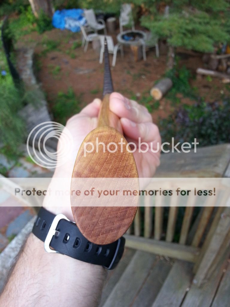

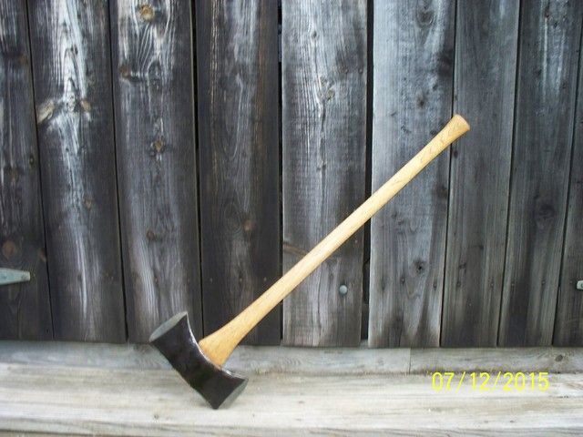

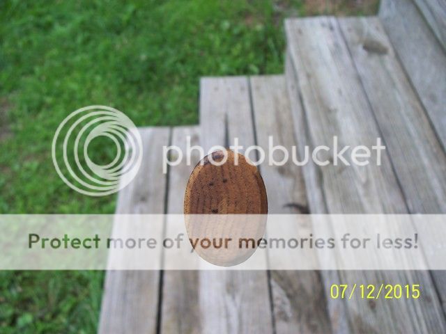

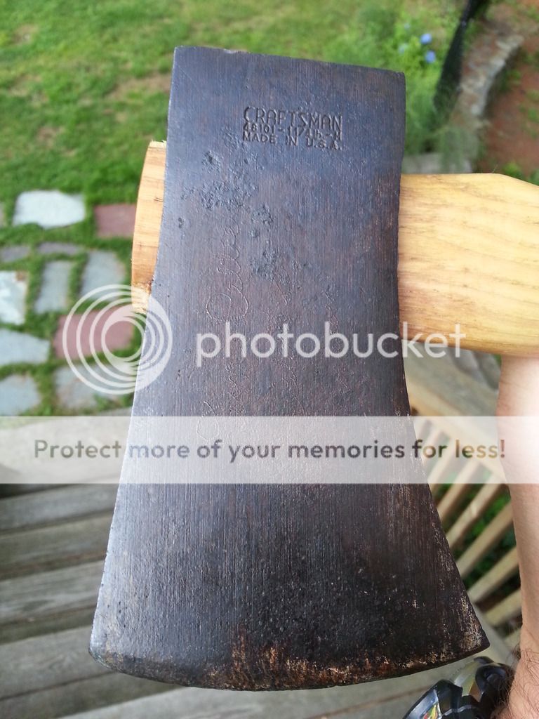

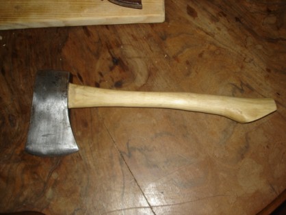

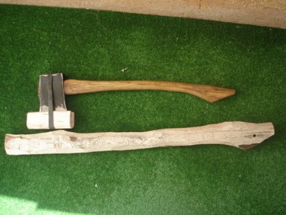

I'm not a fan of polished heads either but that one turned out nice, the haft turned out great, nice work.I am not partial to polished heads, but the person I got this from cleaned in up with a grinder, so I had to put it onto the belt sander to try and get as much of the deep marking off as I could. You can see the grinder marks around the Collins stamp. The haft is 33". It is a Garant, so to trim it down, I shaped it into an octagonal shape with a rasp and a Schrade folding knife, sanded and applied a couple of coats of bee's wax and mineral oil. When I looked in my bucket of wedges, I found one with a bit of dark wood in it. I like how it looks.

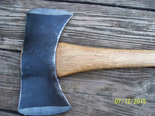

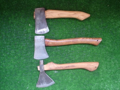

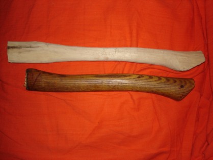

I found a nice quality $3 Craftsman USA hatchet head and had a crappy $1 yardsale replacement handle. I wanted to finally try the BLO followed by tung recipe the Square Peg frequently mentions. I applied two coats of each after sanding the handle smooth. I like the way it looks quite a bit. The tung dried fairly hard and smooth, not like a varnish but definitely more like a regular "finish" than just blow. The wood looks great. Not bad for a $4 hatchet.
I like it, can't beat that for 4 bucks. The blo/tung finish brought out the grain nicely.

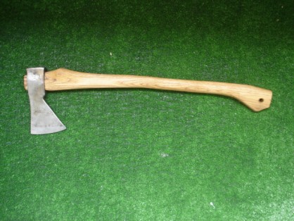

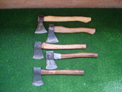

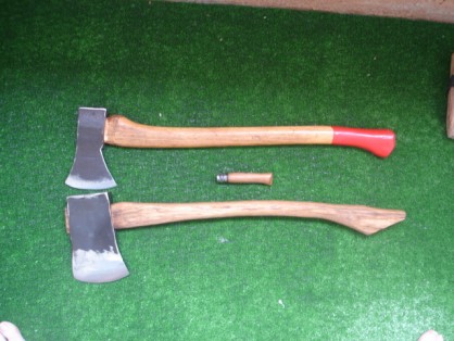

This ones about 90% done. Little more fine tuning on the handle, hammer that wedge every day for a week or two, trim the extra off and that'll be it.
This one'll be going up for sale too.
