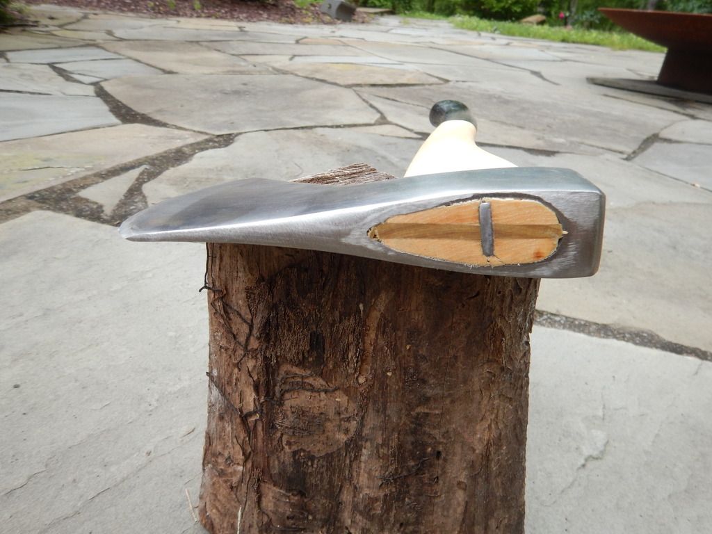

How do you guys get such a clean look on the bottom of the eye, mine always has wood curled. Am I driving it too hard?

Small curls are not unusual for me. I trim them off with the sheeps foot blade of my pocket knife. I think driving them hard is the way to go and I would not change a thing.

Drive it hard, I trim any curls with a knife or a razor blade. If you want it really clean you can drift the handle off and sand the curls off then seat it again.

A few small curls are OK but no curls is just as good. I want the forward progess of the haft into the eye to be stopped by the inside of the eye itself. This is the strongest most durable hang. If it simultaneously fills the bottom of the eye and produces a few small curls then that's fine. But you don't want the curling to create a shelf. That axe will come loose.
So in short, you're not driving it too hard. You should drive it hard. What you're doing is not shaving enough off the haft at the bottom of the eye.

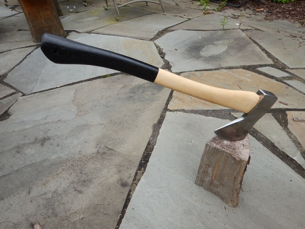

Had an old vintage handle that came off an old craftsman hatchet. It had a Crack that ran too deep to put the craftsman 1lb head back on so I cut it down and fitted it for this mini craftsman. Feels great, I think I'm going to like this one better than my straight handle mini. It was a 14" handle. Now overall length is 12".
Not bad ! You should dig up the " the mini hatchet " thread and add it there.

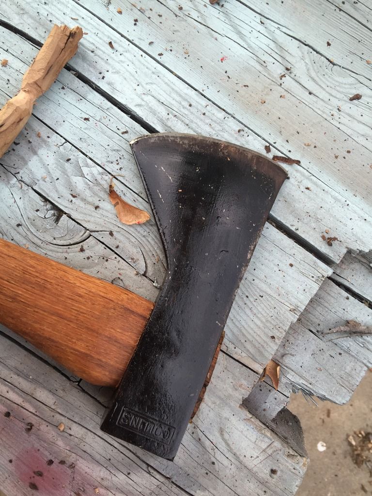

Collins hb on original haft. Grain isn't perfect, but the haft is straight. Turned out pretty well. I don't think this one had ever been used
Nice work on that Hudson Bay. I only have/use one no-name HB pattern.
That Collins look pretty intact. Leaving the black paint looks good.

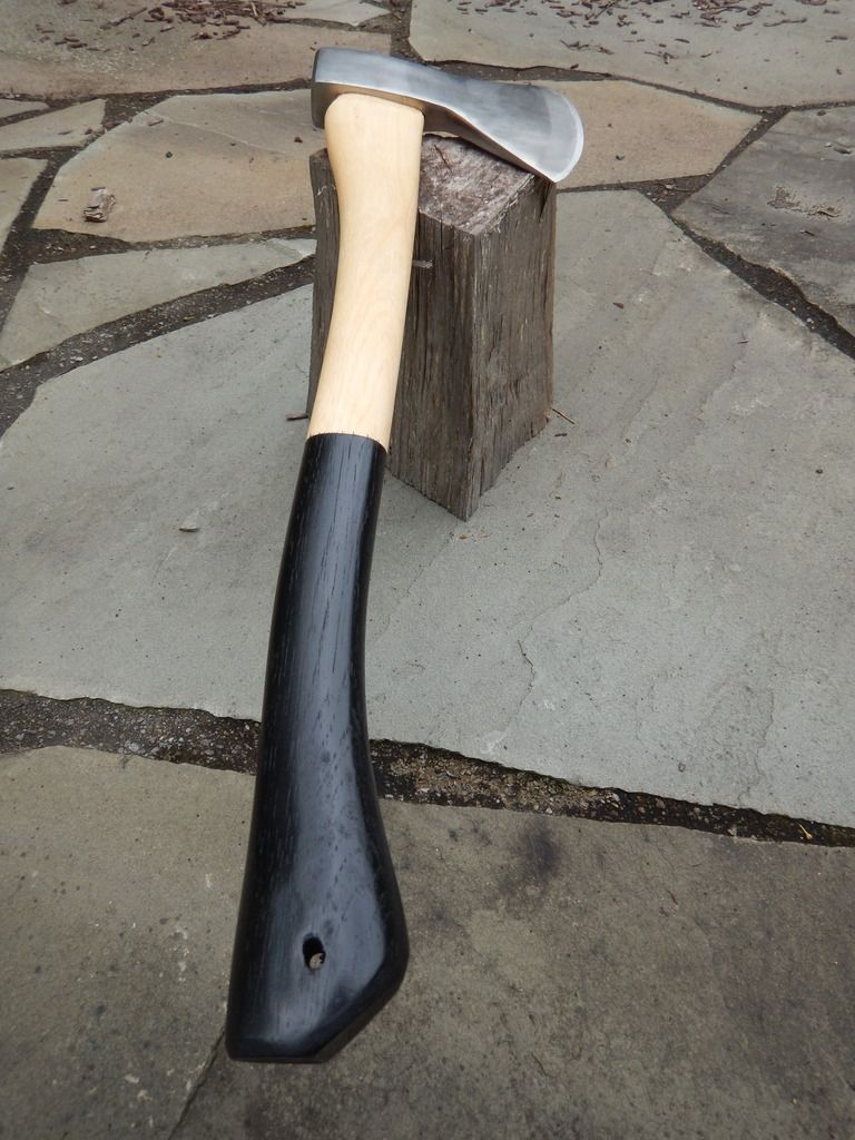

I've been a chainsaw guy for years but just got introduced to the world of Axes. I procured a few cheap axe heads to learn to hang and this is one of the first nice ones I tried. I bought the head already finished and went with a painted half handle and BLO.
I first tried stain on the lower part of the handle but I haven't had good luck with stain on these hickory handles so I ended up using paint. I had some bleed through under the tape that I need to clean up.
It's so pretty now I'm not sure I want to use it.
