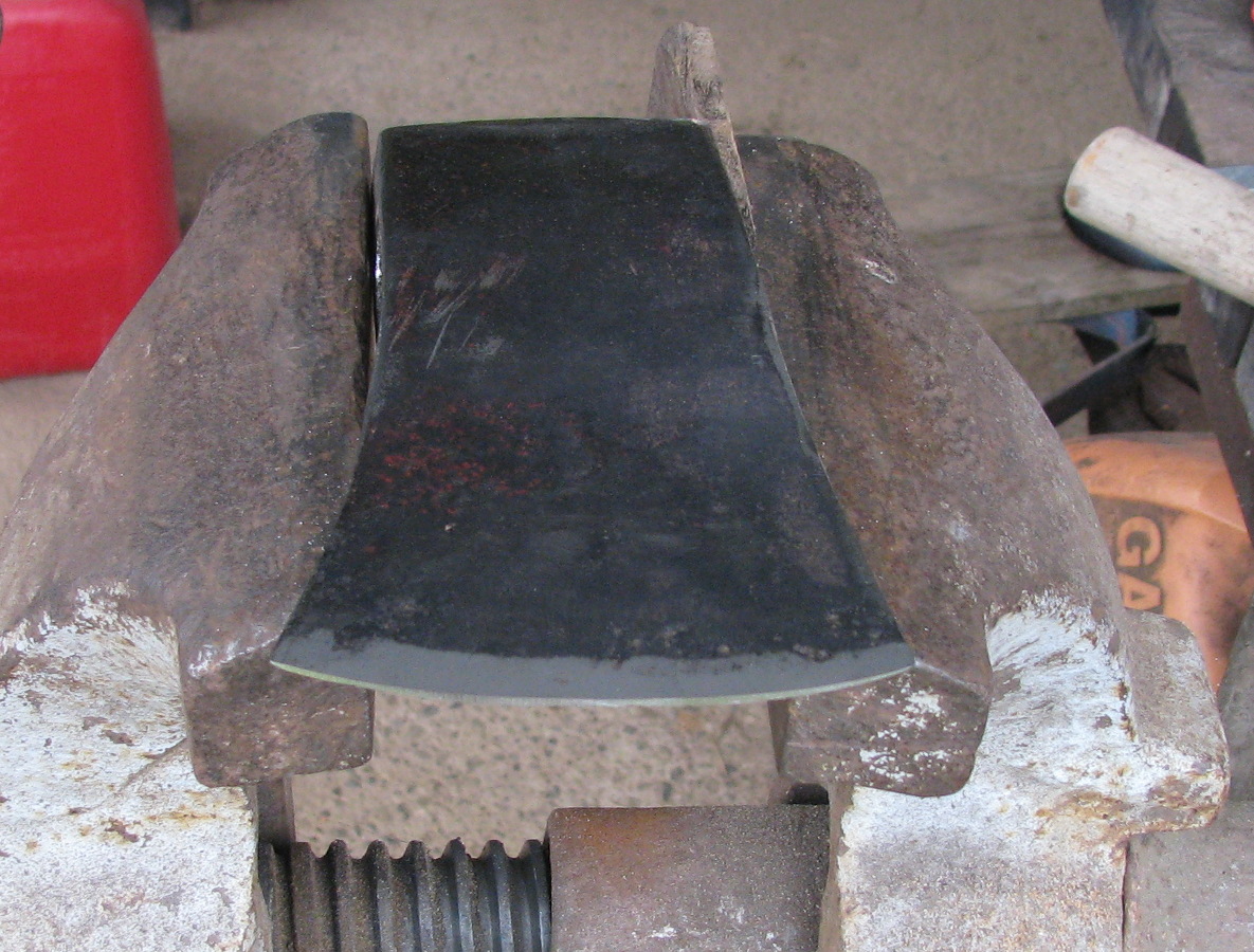

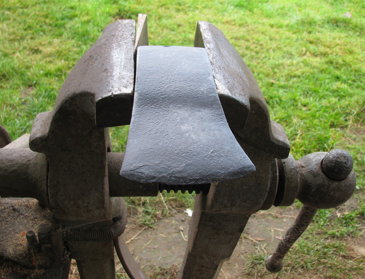

The steel seemed really hard when I first tried it so I kept putting off sharpening it. Today I bit the bullet and it wasn't that bad. The steel was decent under the rust.
Sometimes it seems impossible at first. But once you get a little patch cleared you start lifting the hard oxidation layer with the normal steel just below the surface. Then it gets easier to file.
I like how you have it set in the vise. That gives you good control and power.

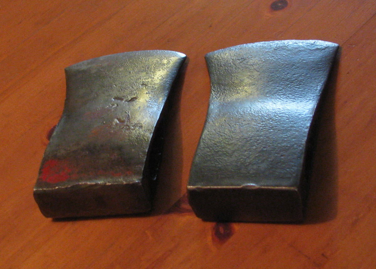

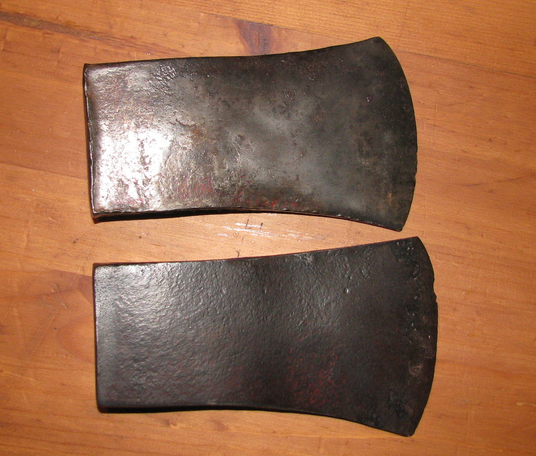

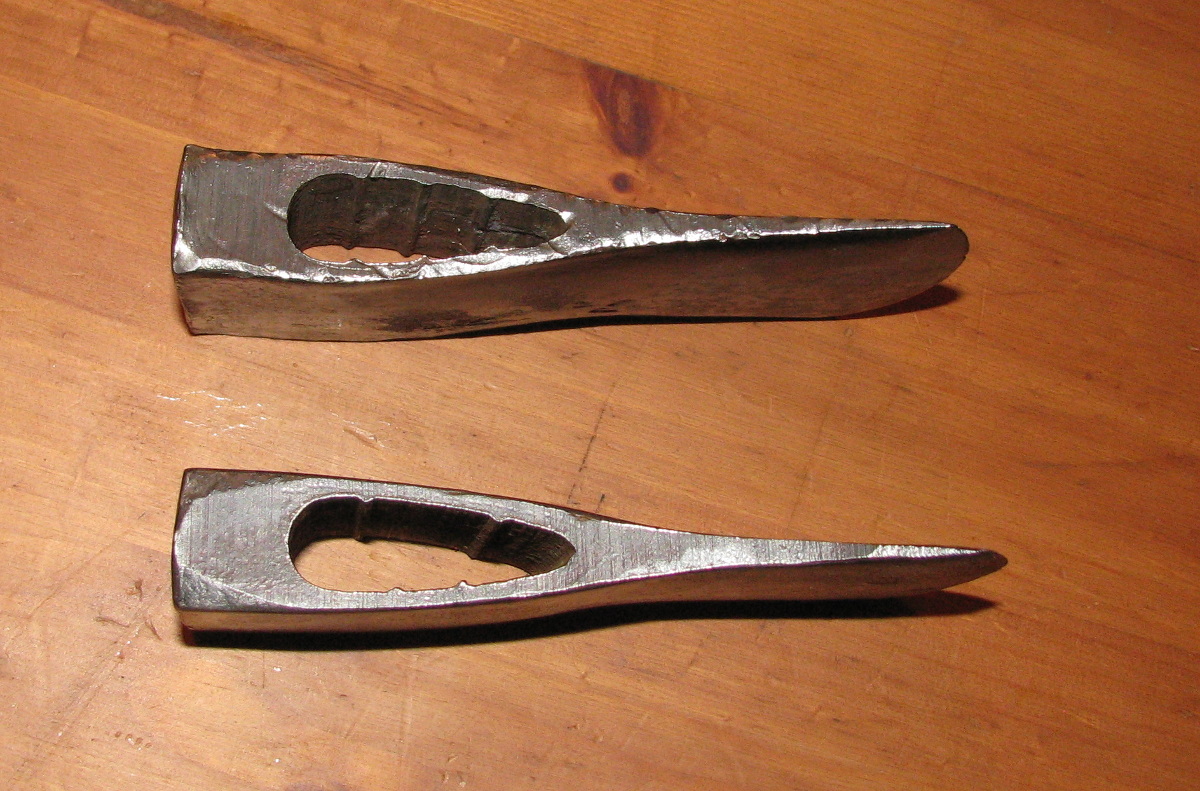

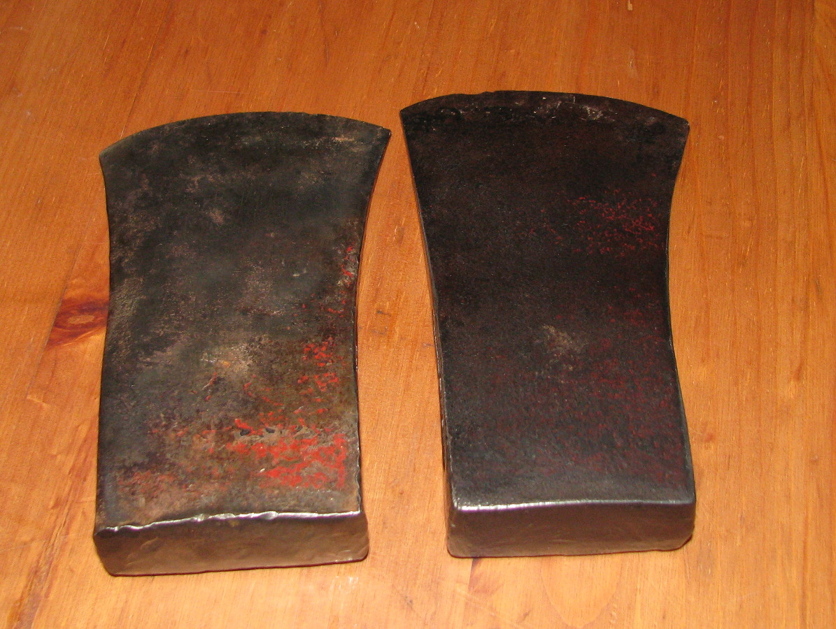

A tail of two Woodslashers. One with 4 eye ridges, the other with 6 eye ridges. I'm not certain but I think the 4 eye ridge axes are older.
The 4-ridge axe was rustier and more pitted but had less wear on the bit and poll. I'm going to hang that one for a buddy.
There's a pronounced difference in the cheeks. The 6-ridge is convexed a little higher. The 4-ridge steps down just beyond the eye. I kinda like the shape of the 4-ridge axe better.

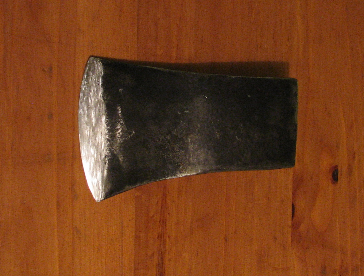

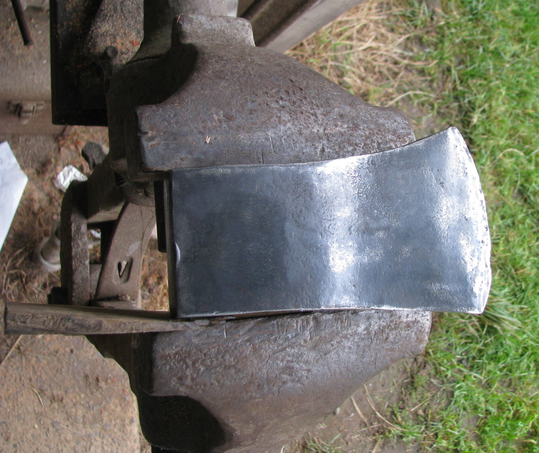

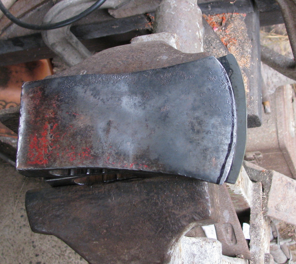

This is the 4-ridge after being heavily cleaned with a knotted steel cup brush. There is a scaly rust layer that is very persistent.
I had to resort to a flap disc to clean it up better. I focused on getting the scale off while trying to leave some patina. A well-worn flap disc is best for this. It came out some better.
I took out the chip in the bit with the bench grinder and left myself a wide edge to file.

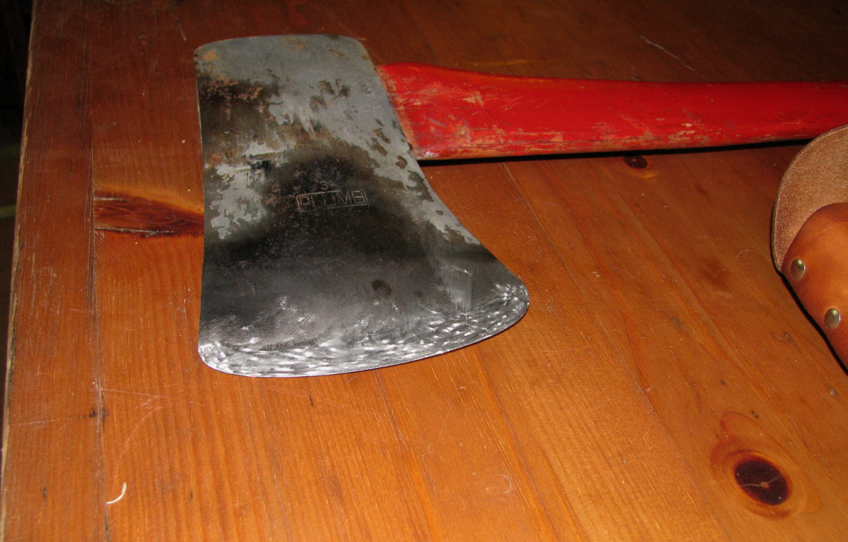

looks like my favorite little plumb boy's axe is getting a tune up,i grabbed it to go chop around and i hit a few rocks... and vice grips so i reprofiled the whole thing back from a splitting bevel to a pretty shallow bevel with a roughly 35 degree edge topped with another 40 degree micro bevel, if you can hold the paper right it'll slice it really clean. thanks again brian for the diamond stones

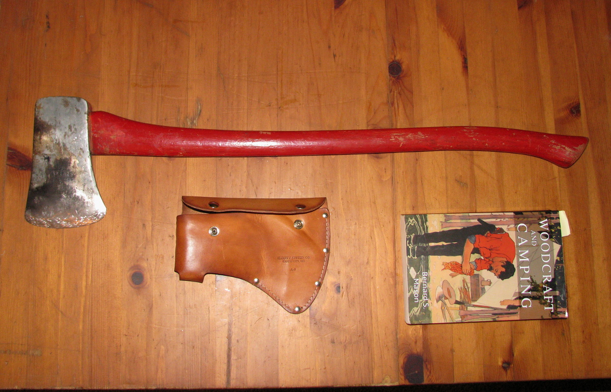

I finally did something with this Plumb that has been sitting in my garage for a couple years. I've maybe used it once or twice. It was an estate sale find, almost unused 3-1/2 pound Michigan. It has convex cheeks and it's original Permabond 33-inch haft with un-clipped fawnsfoot.. Still had the factory grind and no poll damage. Someone painted the head silver/gray and the handle red. No harm done.
This afternoon I took it out for a test run but that goes in another thread.

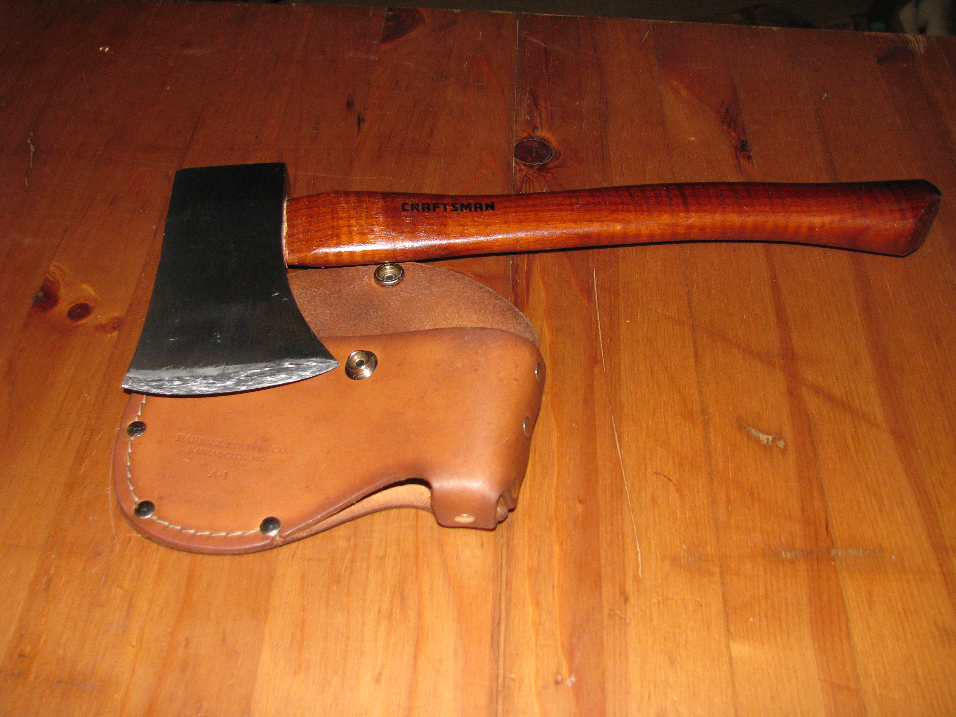

Sharpened another little Craftsman hatchet today. This one will be an Xmas gift.
Got lucky finding another curly hickory haft.
You got really lucky with that Vaughan / Craftsman hatchet.
My grandmother bought one a few years ago for kindling and the top of the head had a big dip on one side of the eye.
Perfectly fine as a user , but just not pretty.
