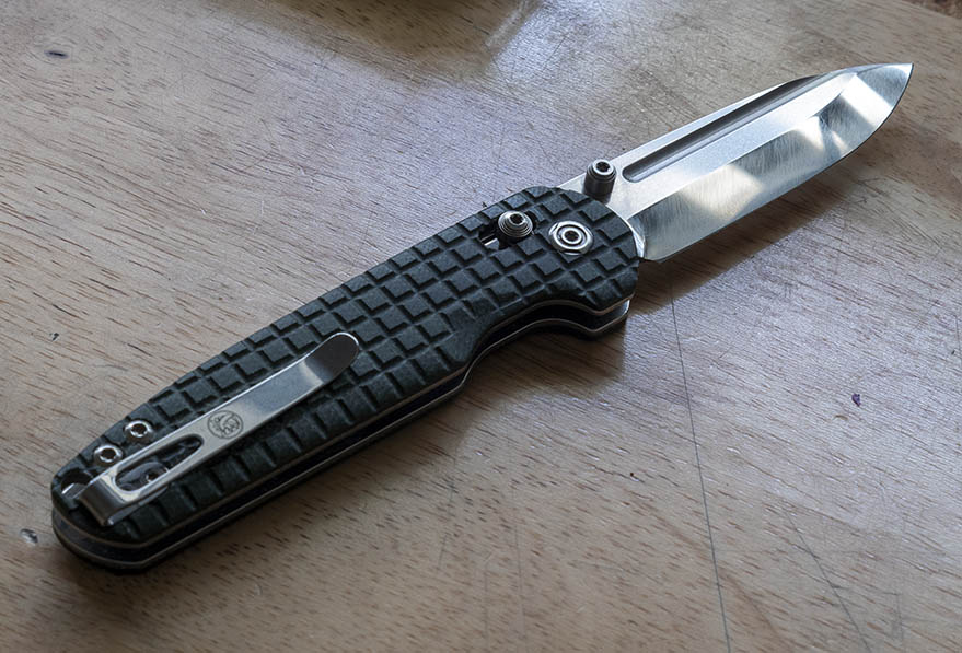

New one for me yesterday. I picked up a Vosteed Grind, which is one of the few folding knives I've seen with a Scandi grind. You can get them with a zero grind or with a microbevel. I went with the zero because ... hello ... I bought it for the grind.
Of course one of the beauties of a Scandi is that the wide bevel essentially acts like an angle guide. They're laborious to sharpen, because you have to remove material from the whole bevel to apex the edge, but it basically requires no skill ... which is good for me as a free-hand sharpener. :p
Or at least that's the theory. As I soon discovered, the theory collapses if the bevel isn't perfectly flat from the factory, and with my copy of the Grind, it was not. I should preface this by saying that the knife was sharp from the factory (130 BESS), and easily stropped down to 90 BESS. After cutting a little cardboard, however, the score went up to 185 and it would not strop back to the excellent initial scores. Hmm.
Well, thought I, this would be a great time to experience Scandi sharpening! The knife was almost very sharp, so it shouldn't take a ton of effort to restore its hair-popping form. And that's when things went off the rails. My first thought was to start very conservatively using a Supersharp 3000 grit diamond plate. It immediately became apparent that the factory bevel wasn't perfectly flat, and worse, there was a good 1" section at the belly that had a very slight convex to it. That's a huge problem if the intention is to maintain a zero grind. Instead of having to remove maybe a micron or two of material, now you're looking at removing (guessing) 10-20x as much material to apex that section of the bevel.
Long story less long -- I ditched the 3000 plate and went to the Atoma 140, followed by many additional stones. Eventually I established a reasonably proper Scandi bevel ... and then said the hell with it and put a 15 dps microbevel on it. I suspect that the factory burned the portion of the edge that was convexed, and removing enough material to get rid of that with a zero edge just wasn't going to happen in this lifetime.
I should have taken pics along the way, but I didn't. Here's the final result:
