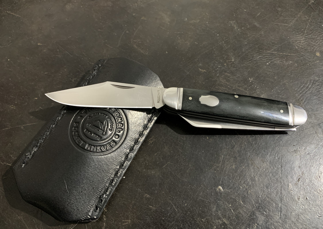

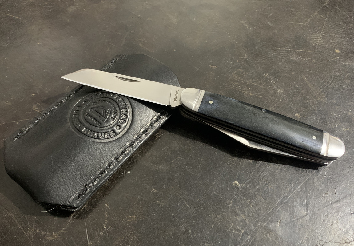

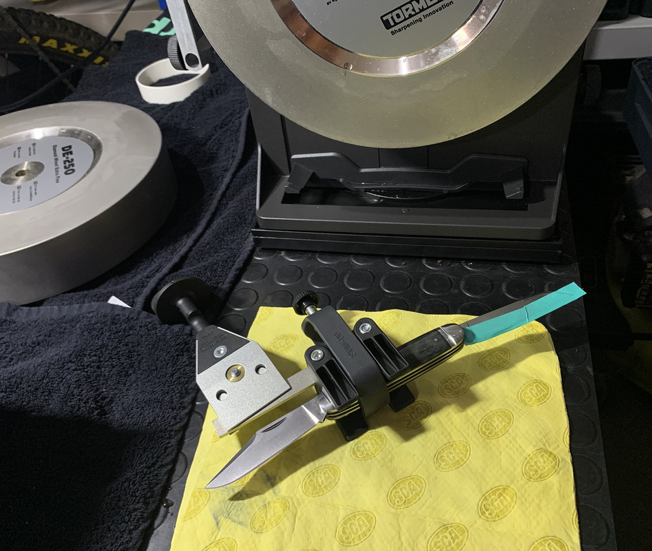

I sharpened the second pocket knife on the Tormek. The small knife jig holds the knife securely by the handle and is excellent for holding pocket knives or blades that does not have a flat surface to clamp. These wheels chew steel at an alarming rate. It is easy to overdo it, but I am pleased with how this turned out. I erred on the side of caution and did not lower it too much (17 dps). The knife is a Rosecraft Briarpatch Jack.

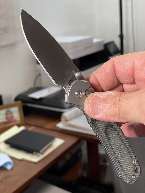

This is an Architect Knives AK 4.5, with a blade of S35VN. I love the feel of this knife, it is a very useful size and weight for us in Southern California, where there is very little wood to cut, very little of anything that needs to be split or batoned. As near as I can figure, the grips are black linen AND brown burlap micarta. Micarta is great, but this almost Neapolitan micarta must be so much better! TWO things in the micarta! WHOA!!!
It got the full treatment on the Wicked Edge guided system, starting with a 400 grit diamond stone which reprofiled the blade from about 25 to 20 degrees per side pretty quickly. I proceeded through 600/800/1K/1.5K diamond stones, then switched to ceramics at about 2 and .5 mu. A light strop with blue lapping film and the blade had a mirror finish from the heel to the tip.
It cuts like a savage, and the handle is extremely comfortable. The S35VN presented no problems; the whole process went quickly with no drama. It might be a little too fine for heavy yard work, but I can always just sharpen it again. Maybe I'll bump it up to 25 degrees per side, that might make more sense on a knife that is going to see some enthusiastic use!
BESS scores came in around 140-145, not impressive considering the care I took on this one. Could this be a case of too much polishing degrading an edge? I have another AK I am going to sharpen next week, so I think I will keep the BESS machine handy so I can test after each stage. It will be a little more work, but I might learn something useful.
