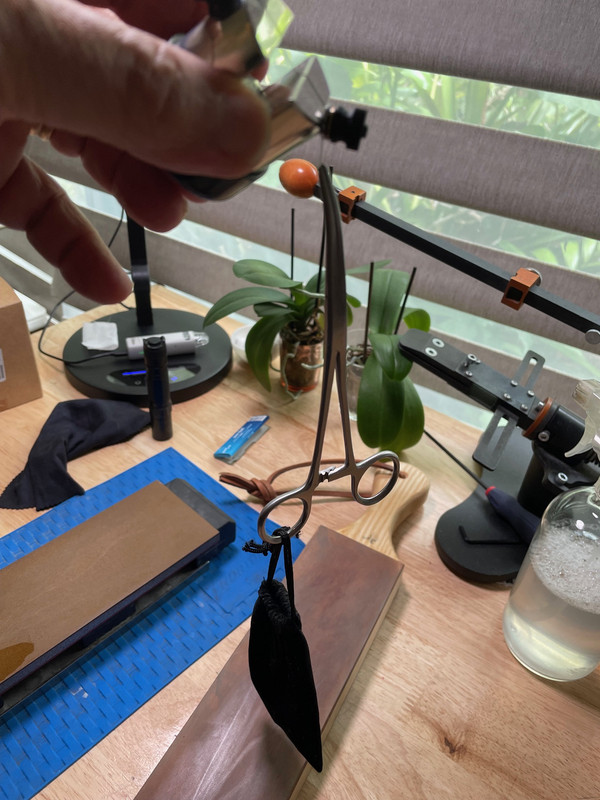

The biggest variable with the BESS tester is the speed of the test. The slower you go, the more accurate it is. The second biggest factor is the tightness of the media. You can eliminate that as a factor by applying 100g of weight to tension the media. I accomplish that by using a hemostat with a little jewelry bag tied to the handle containing a few weights. The total package weighs 101g. I don't think the tightness of the screws has much effect. The screw on the side where the media comes out barely needs to be tightened at all. The other one can just be lightly tightened if the knife is sharp. If the knife is dull, you do have to crank down on it a bit to keep it from slipping.
