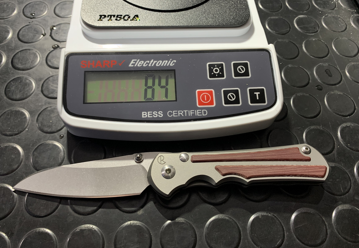

First sharpening on the CRK Inkosi Insingo since it left Idaho.
Factory edge was pretty but not particularly sharp. The secondary bevel from the factory was much thinner towards the tip. They did a convex edge that i measured to be 17.9 DPS at the apex on the heel, tapering to 25.0 DPS at the apex on the tip.
Pretty wild scratch marks at the tip.
I noticed a lot of the insingo blades look like they have a similar DPS change from heel to tip from factory. I suppose this is to add strength to the edge at the tip, but since this blade shape is to tip-focused I was really struggling to make cuts with it. Decided to put a 18.0 DPS V-edge on it with the K03 to see how it works for my EDC use.
Used Poltava metallic bonded CBN stones J120, 150, 220, 240, 400, 600 and 800, and then stropped with 6, 3, 1 and 0.5 micron gunny juice on roo leather. Worked great on the magnacut.
And here's the end result. Cuts now like a dream. Depending on how it goes I may end up going back to more obtuse angle towards the tip or put a slight convex on it.
