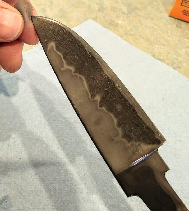

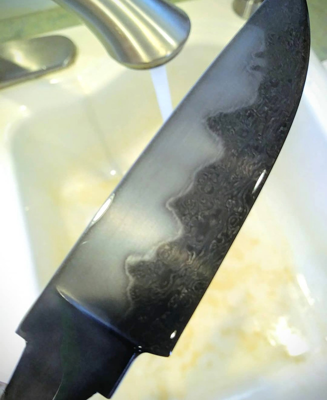

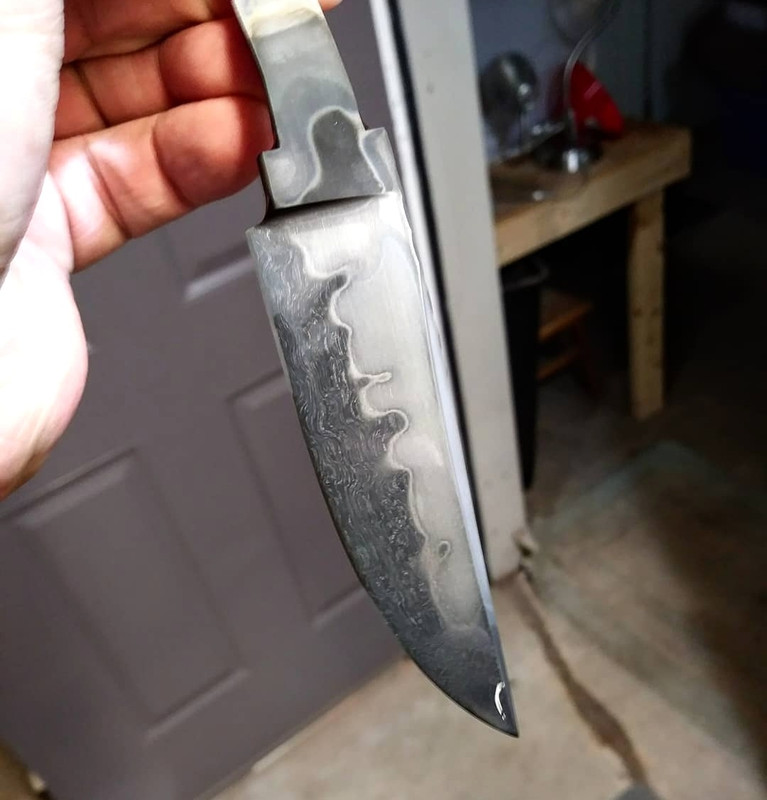

These pics might be interesting to some in this thread.
These blades are forged, simple carbon monosteel. They all have hamon and this is half way through my etching/polishing process. Notice the extensive banding....the "watered"/wootz like pattern.....in the black, hardened area of all three blades.
Again, these are NOT Damascus or San Mai blades....just simple high carbon stee.
W2
1095
1075
