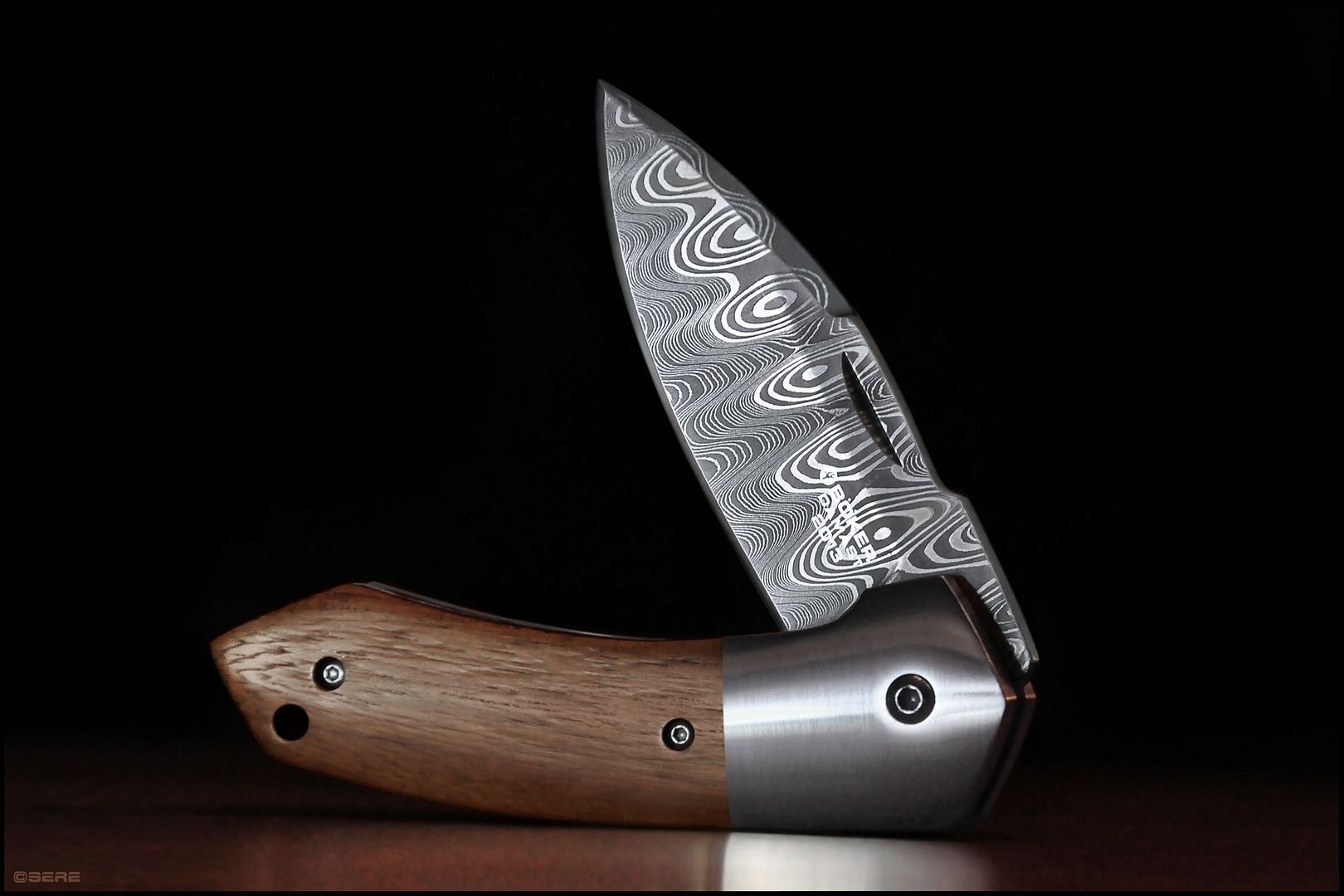

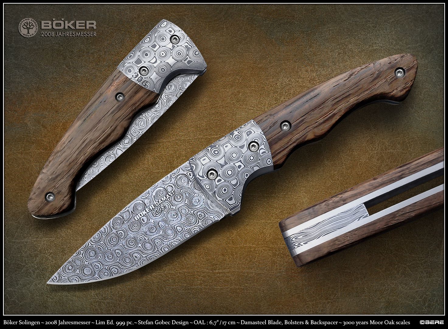

I really like Damascus and Damasteel a lot. I have two Böker folders in nice presentation boxes with Damasteel blades. I've had them for a number of years and will always keep them as nice safe queens. Here's the annual edition 2008.
This is the Annual Edition of 2013. Design by Jens Ansø. The wooden scales are almost black after several years on display.

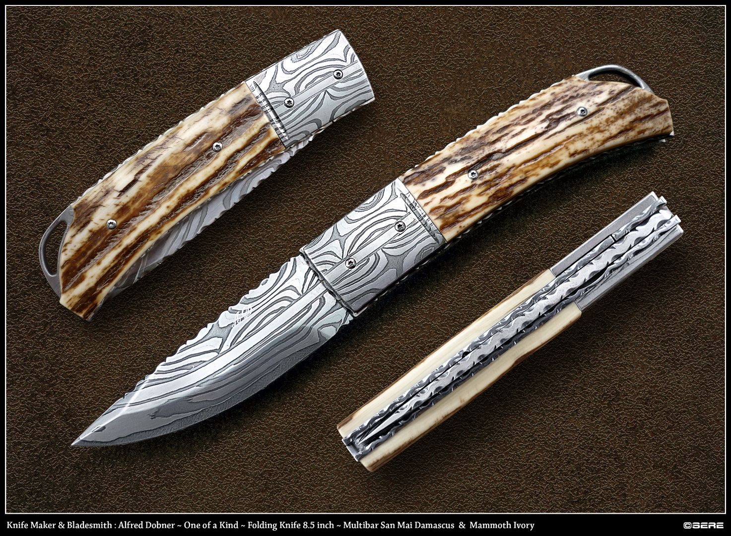

This multi bar san mai Damascus by the well know Swedish maker Alfred Dobner was my first custom.

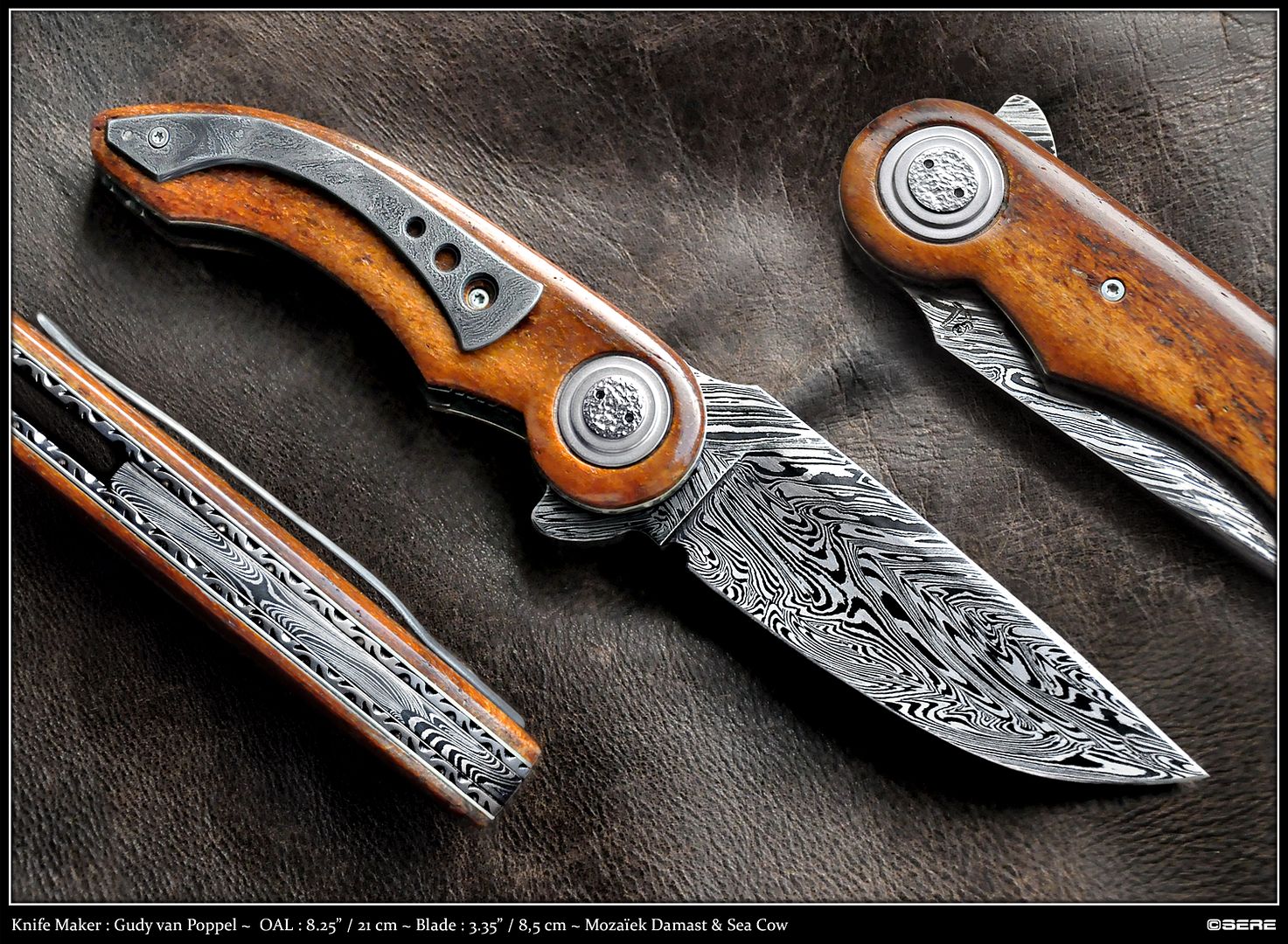

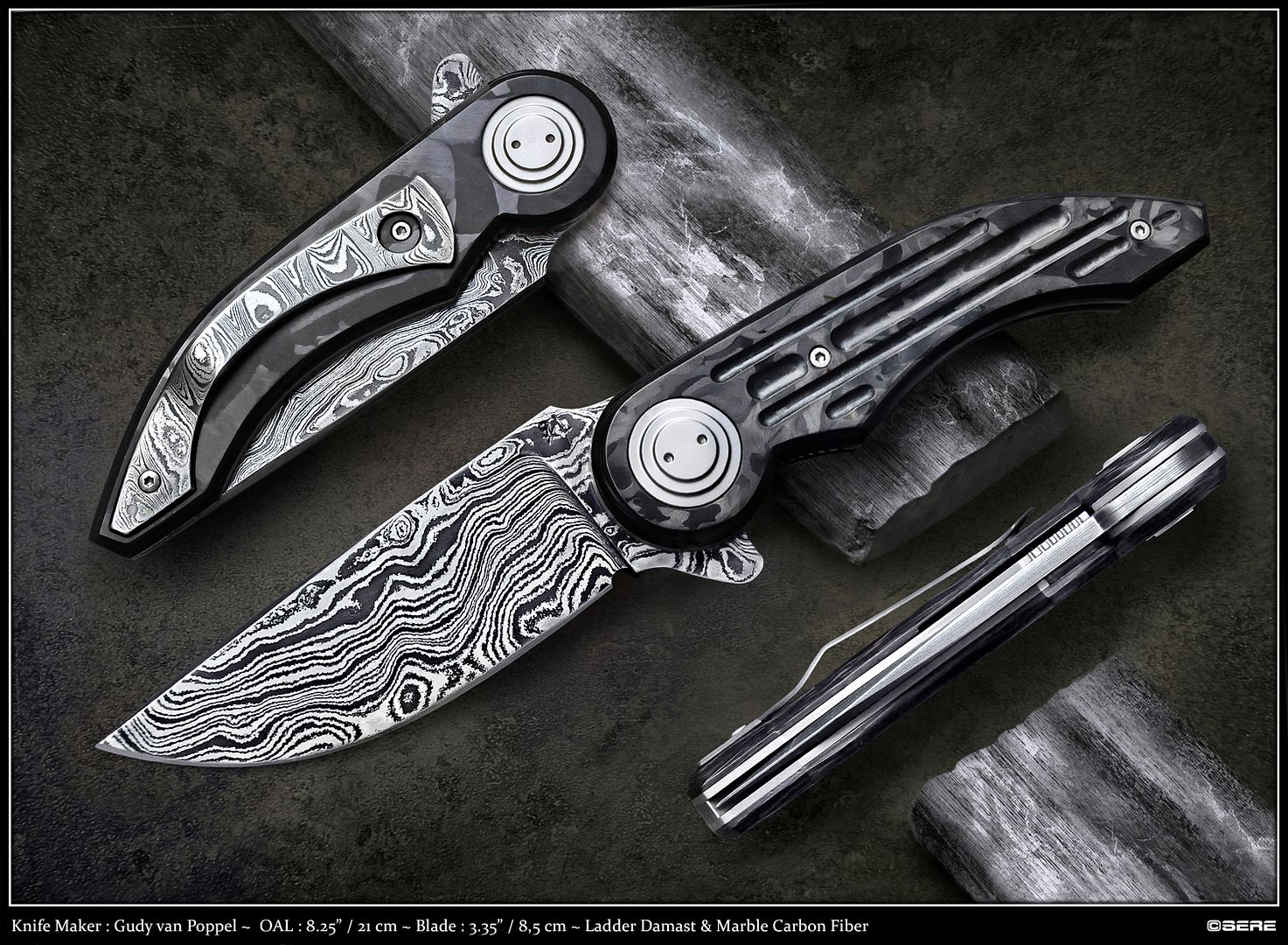

Knives by Gudy van Poppel always felt right and I had several of them. Here's 2 folders with hand forged Damascus by the maker.

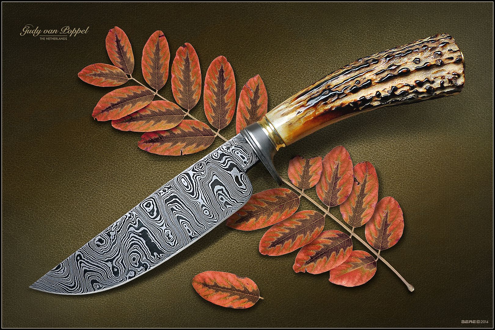

This Sendero by van Poppel is the fixed blade I liked the most. The Sambar Stag was outstanding all around the handle. Nice belly on the blad and good centering in balance. Never the less I sold it.

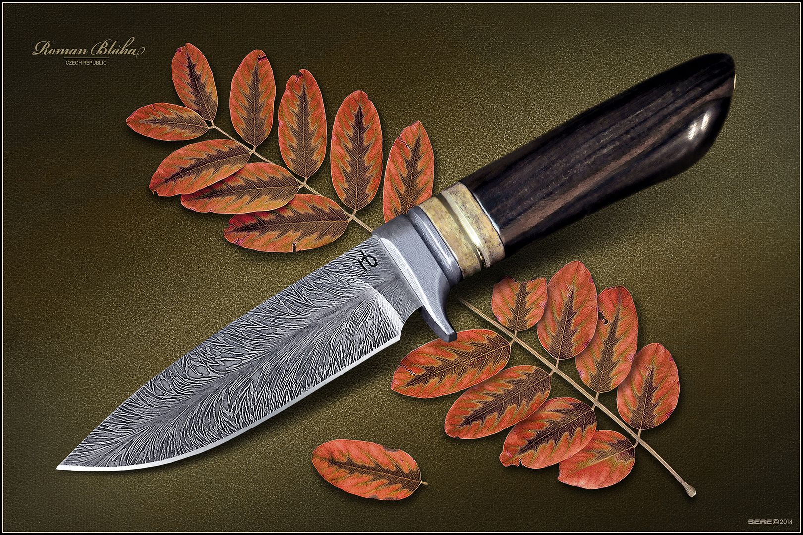

Another nice one was this knife by Roman Blaha in Feather Damascus, Ebony, Giraffe bone and Alpaca.
