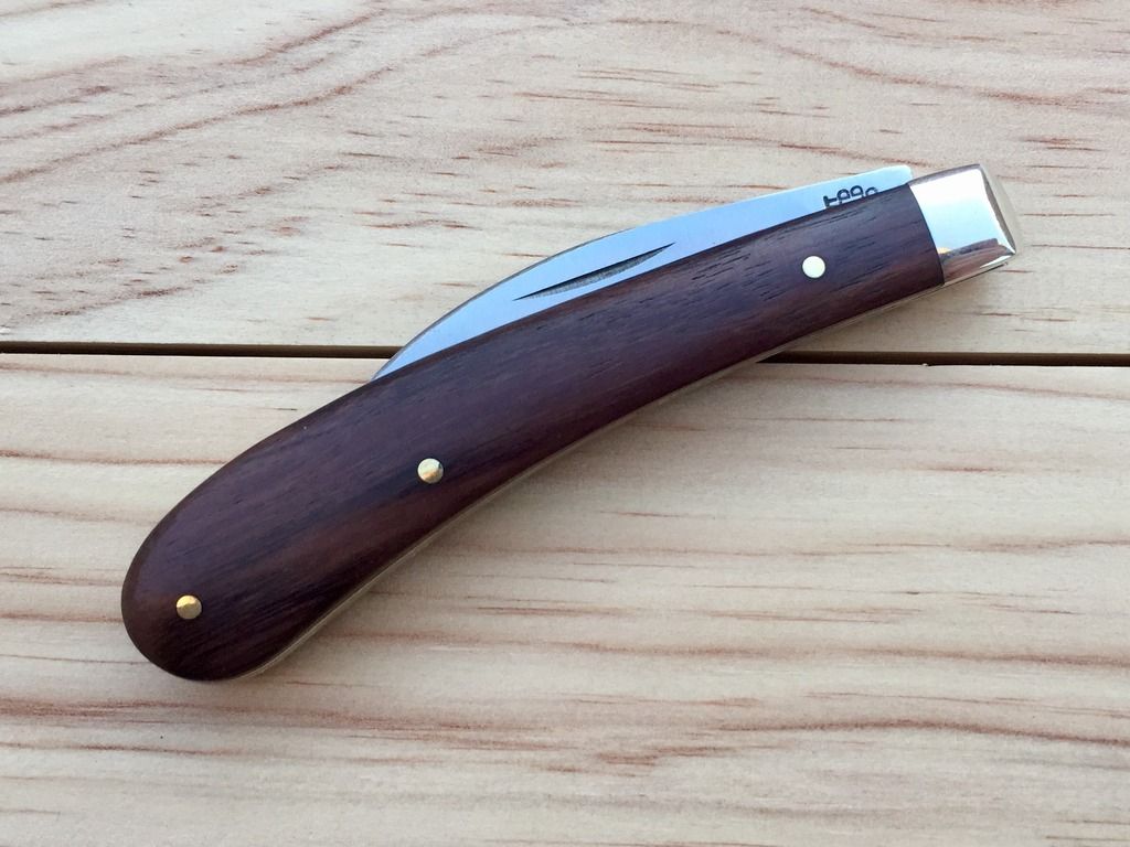

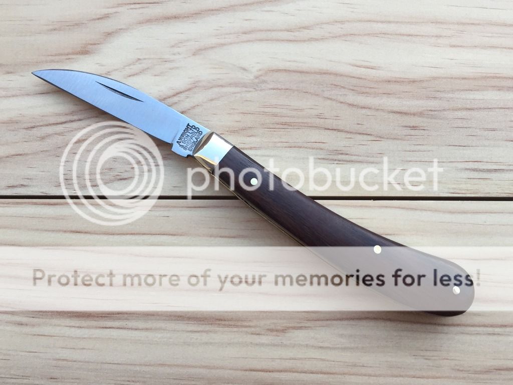

I love that knife with the Wooden Scales and both the Elliot CC marks and the Lockwood - that knife combining the History of the two great Cutlery companies is just awesome...I am going to refer to this knife as the " Elliot / Lockwood Knife".
I am looking at these however.....

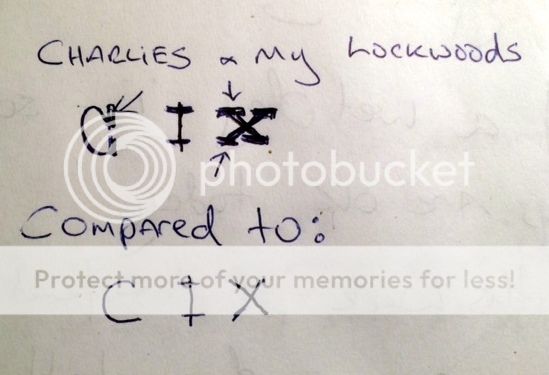

The Elliot / Lockwood knife that you have just posted obviously with those two stampings could easily be dated post adjoining of the two Cutler firms in 1930...thats fairly basic.... But the Elliot / Lockwood Knife has England stamped after the Sheffield, The looks to be of a Later model build being Brass pinned, the Font of the stamping is Cleaner and Thinner, The C & The X are clean and have no "Feet" or "Bookshelf endings" on the letters as shown in my hand drawn Picture.
Charlies Knives - the Stamping Font is different than the Elliot / Lockwwod Knife.
On Charlies Knives the Font of the Stamping C & X are deeper and heavier - a different styled font - as shown in my hand drawn picture.
The pathetic Picture of what is a pretty good descriptive Font that are on Charlie's and my knives.....

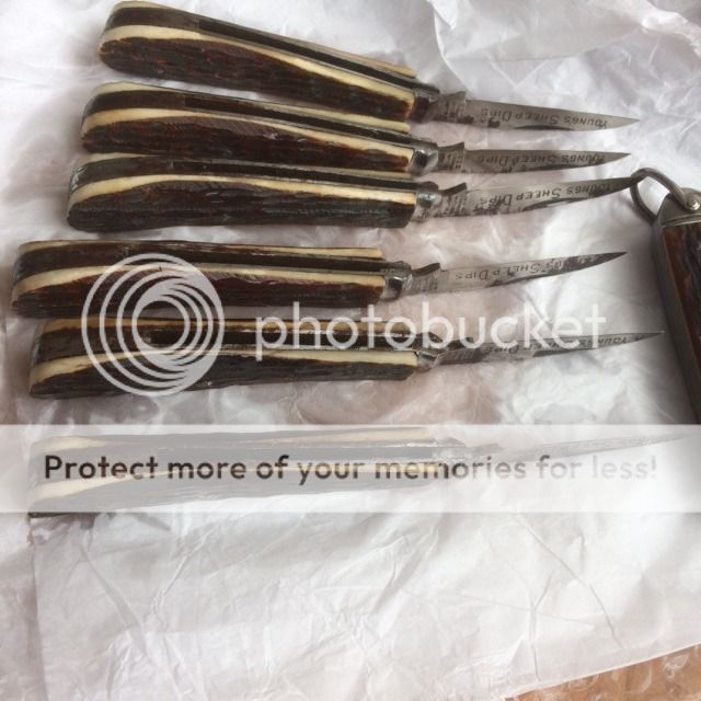

The pins are Hammered and are Iron, the "Youngs Sheep Dips" is not acid etched, they are either Stamped slightly untidier OR Engraved ( I'm still studying that one...)
The Elliot / Lockwood Stamped knife has very clean and even font - and from what I can see Augies Slater has too- cant see if that knife has England Stamped on it - but could bet you it does as it is exactly the same as Jacks "combined stamped beauty".
Im going to stick my neck out and say that Jack is bang on by saying the Wooden Handled knife is Older - the Kick Style, The Font of the Stamping etc - and that knife has a slightly different Pinning pattern to it as well.....

I think "England" is mostly helpful when it is present. When it's not present, it depends a lot more on other clues.
