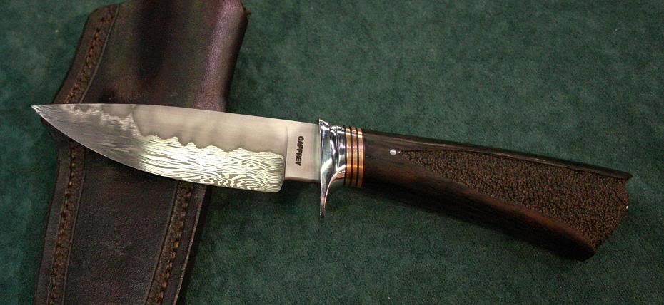

Ed Caffrey had a "clad damascus" bladed hunter at BLADE this year, which was exceptional.
Something like this, or W2 or 52100 with a hamon would be striking for the blade.

bm - that Caffrey piece is stunning!

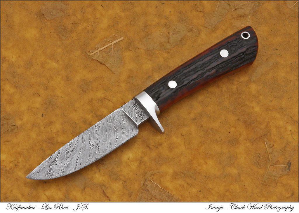

My idea of a perfect Hunting Knife is based on a lot of experience skinning Whitetailed Deer and for various uses involved in the hunt. I like a small to medium sized knife with about a 4 inch dropped point blade with a proportionate handle.
As for materials, I would go for a medium layer count twist damascus blade for the cutting qualities as well as the durability of finish, 416 fittings, and a grippy handle material. That and a good solid secure sheath and what else could you ask for? :D Here is one I made a while back that I was partial to. Lin

Thanks, Roger. I think Lin's hunter is excellent. It's straight forward and functional in design, and it has damascus and amber stag for a higher level of interest.

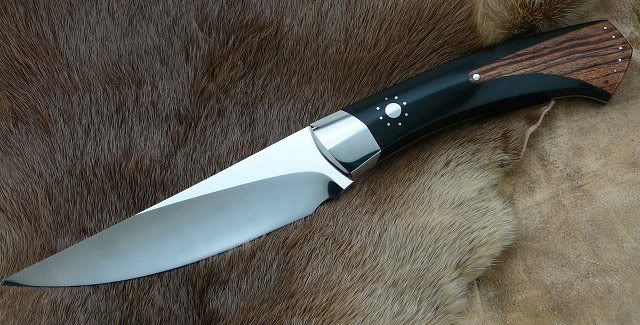

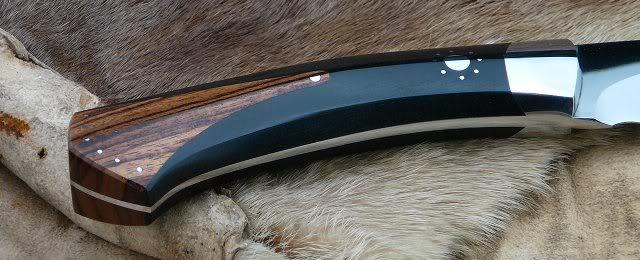

Okay - here are a bunch of random pics of hunters and smaller fixed blades that I like. Some are or were mine, most weren't. Just pulled from images I already had on fototime.
On the short / long ricasso - I don't have a standing preference. And even Nick does them both ways:

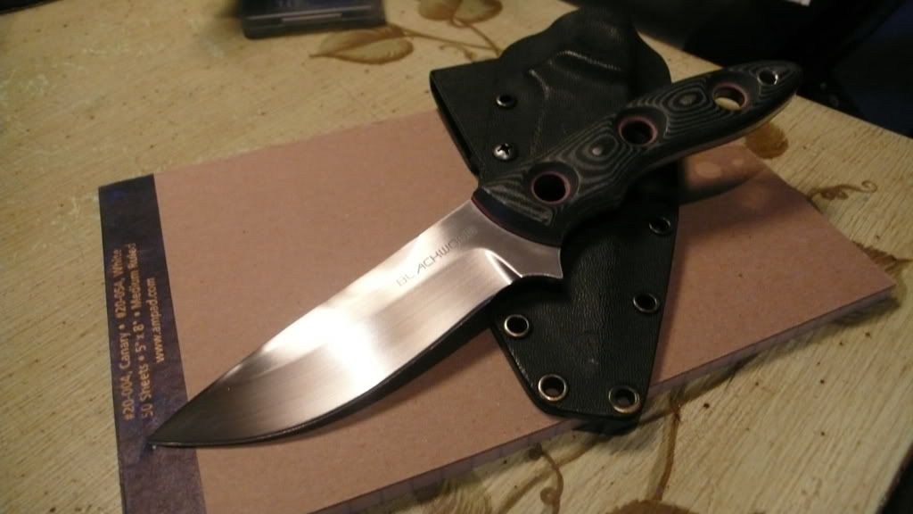

PS - I really like the blade profile on the one that Karl just posted up.

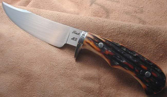

To me, this particular Fisk "Gamemaster" is the definition of the perfect Hunter. It's like nature created this piece of stag to be a hunter handle.

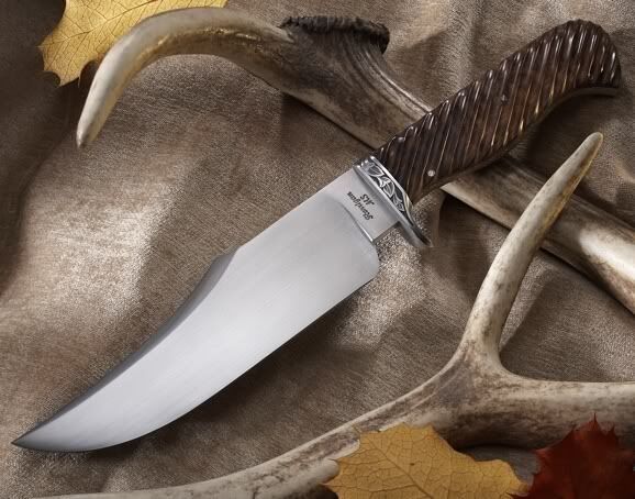

Jon, here's what John Horrigan calls his "Hunting Bowie". Again similar to the blade profile on your drawing. About 5-1/2"ish Blade if I remember correctly.
Here's what Jerry call his "Sporting Bowie". Similar clip to your drawing with a 5" Blade.
