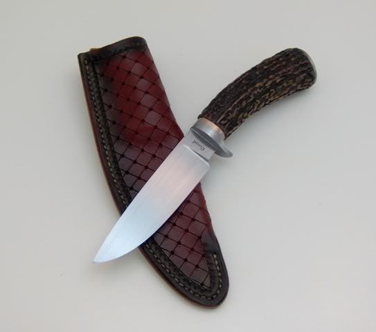

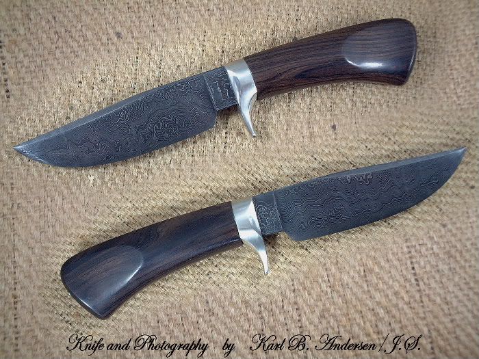

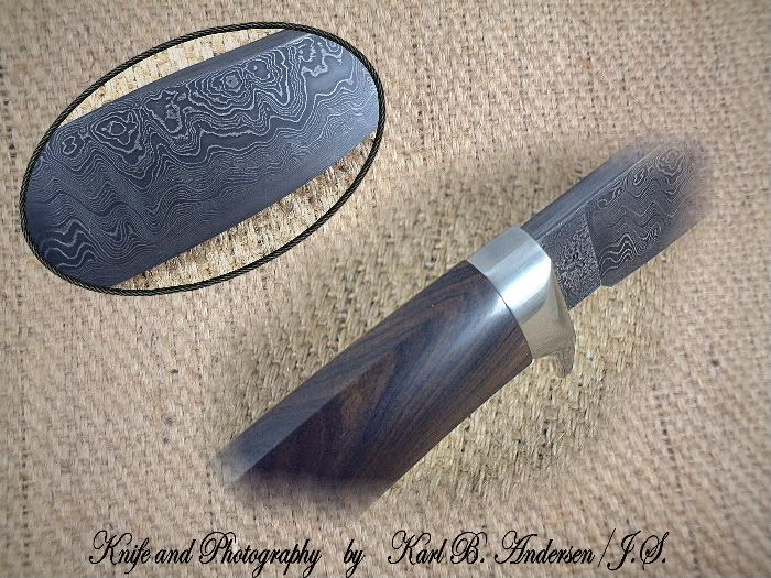

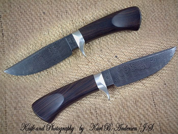

Jon, here is the first hunter Don made for me. It is 10-inch OAL (5/5) I believe. The highlighted profile image might be helpful to you? I requested the 'river-flow' damascus. Don has the ricasso size just right for my taste.
Hope this helps. Plus, keep us posted on this project as it develops over time, if you would. :thumbup:
- Joe

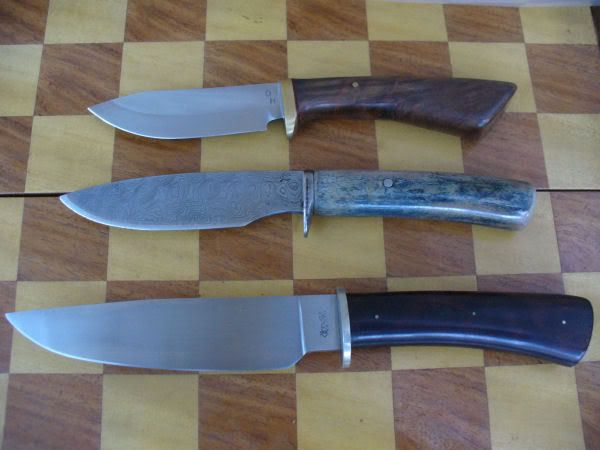

I have a great many hunters in my collection and while this one is not forged, it is the nicest of them all and one of my favorite knives. It just balances in the hand so well, sharp as can be and is a work of art also.

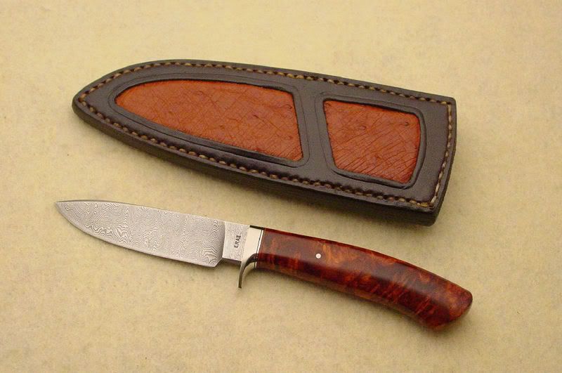

OAL 9 1/2" with 5" ATS 34 blade. nice engraving and gold embellishment and although not shown has a great sheath. It is a piece I'll not part with. Brian makes great hunters and many with damascus but this one is really something special in my opinion.

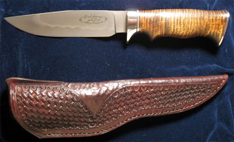

My favourite was this Paul Savage hunter, unfortunately it was also one of my wife's favourites so it's now in her collection...:o

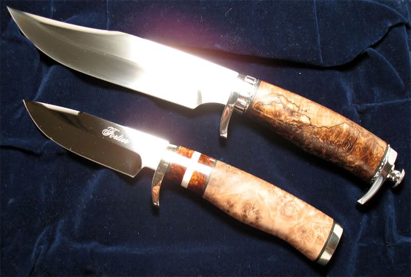

She's got some other nice ones from Paul-Aime Fortier:

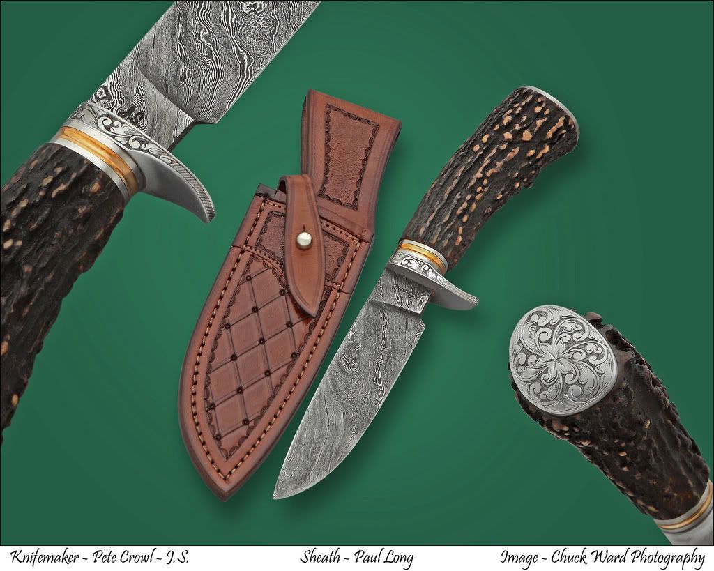

Jon, I know this is off the beaten path from your ideas, but these two would be my picks:
Bill Burke in blackhorn
David
