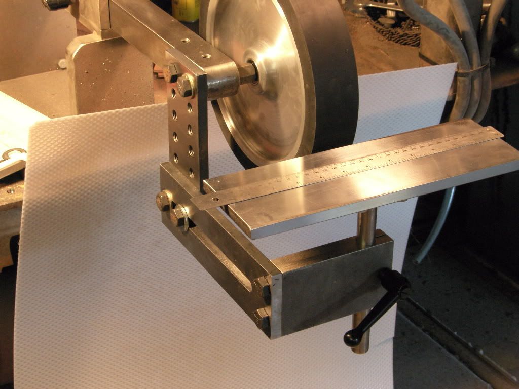

Here is some pictures. Basic idea is that you attach xy table to the MAP Arm and bolt a magnetic chuck to the x-y table.
We need to find how to keep a working surface parallel to the wheel and how to adjust how much cut will be taken.
One way to do it is to attach xy table to the Map Arm via a hinge and use a fine screw to move xy table with the work piece "to" and "from" the wheel.
I just don't know if we can find a ready made hinge without any play in the axis.
Michael, please let me know what do you think about it.

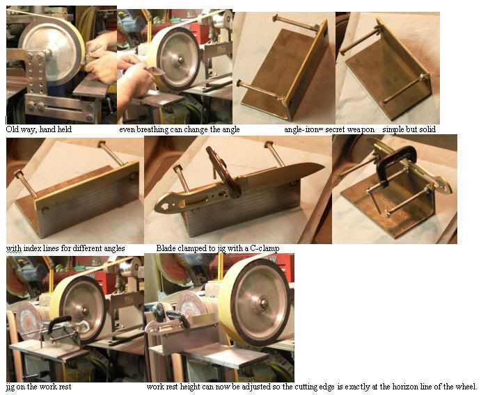

- I have a series of holes, D&T, along the vertical edges of the support jig, so that I can always adjust the angle of the blade to get proper grind line.
- To clamp the blade to the jig, instead of C-clamp, I use locking pliers. HF
stores carry them for dirt cheap .
Using that jig when grinding does make one feel less of man :rolleyes:
No but I do feel smart enough to get a perfict grind
with 75 cents of scrap steel.

Its an interesting idea. I have some ideas. I will email you in a few.
