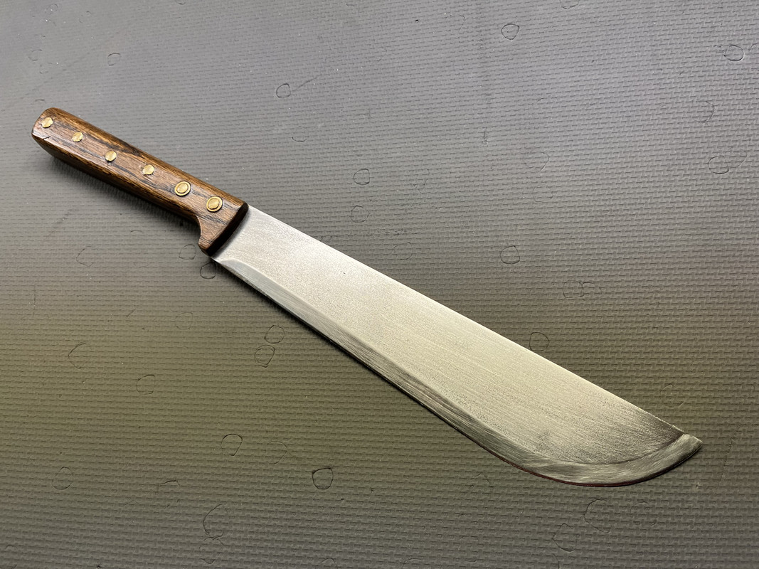

I tried to like the ontarios at one time and couldn't either. I like the tramontina 14" the best. It's ideal for what I do which is small trimming for hammocks and chopping grass or weeds back for a campsite. Also works on tough bait fish.I'm personally actually not a huge fan of the Ontario machetes. Too thick, too hard, horrible ergonomics. But they were the only USA-made machete up until they became unavailable. I carried them, but because they were the only choice for a tool meeting those features, but they were a pale comparison to the same machetes made in the 90's and earlier, which had actual full flat grinds.

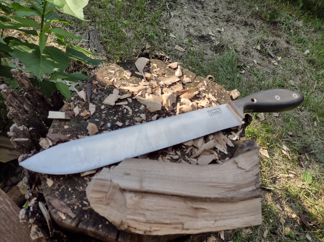

do these have a distal taper or are they just flat?Your new favorite machete is going to heat treat tomorrow. Get hyped.142 thick Z Tuff at 61-62RC. Should be one of the best performing machetes out there.
They are flat but the fuller accomplishes the same reduction in weight and improvement in balance with the added benefit of no reduction in strength.do these have a distal taper or are they just flat?
The distal taper is one of the key things I look for in a good machete.
