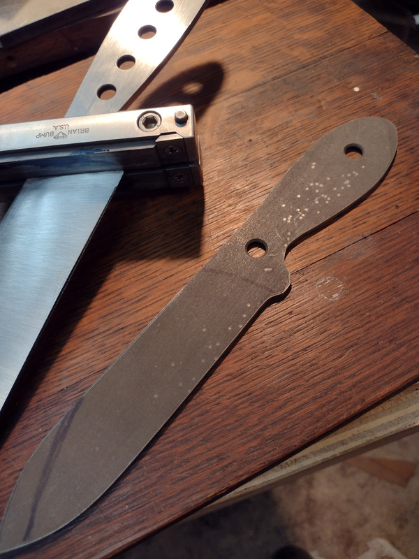

Showing a picture. Here is a blank of hardened CPM Cruwear that has been straightened. (While Hard)
It was hit/tapped with a carbide hammer. The hardened ball is kinda looking like the round ball of a ball peen hammer.
It's that small area of impact that creates such a large force (psi) the impact displaces the metal. Subtle enough, but enough and with Many of them can change the shape, straightening the blank..... Tap, Tap, Tap....
