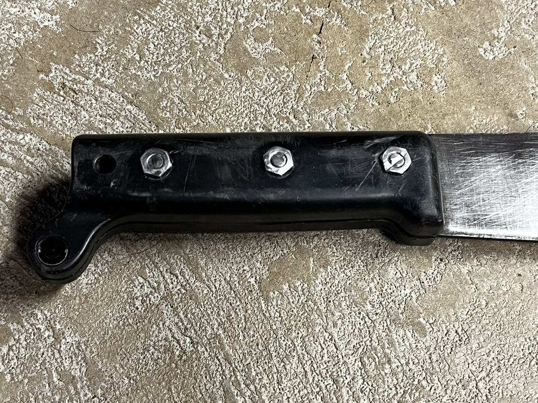

Consider using self-clinching fasteners instead! They're round and have an integrated serrated washer that keeps them from rotating. Then just either use a machine screw of correct length, or after cutting the ends you can use a deburring tool to chamfer the ends so they aren't sharp or crisp anymore.I use the old standby Ontario 12” machetes and have been pretty satisfied with them. They have a rep for handles opening up under heavy use. That does happen to some, not all.
I have one that did baton/kindling work a couple of winters and the handle rivets did start to separate, so I Beckered it. Size 10 screws I believe. Snug them down, cut the end and file smooth. Does leave some ridges but that hasn’t been an issue. I probably could have countersunk them a little more but it wasn’t that important to me.

Something like that would probably also work well, but at the time I needed it back in service and went with what I had. Did the job, so I was happy.Consider using self-clinching fasteners instead! They're round and have an integrated serrated washer that keeps them from rotating. Then just either use a machine screw of correct length, or after cutting the ends you can use a deburring tool to chamfer the ends so they aren't sharp or crisp anymore.

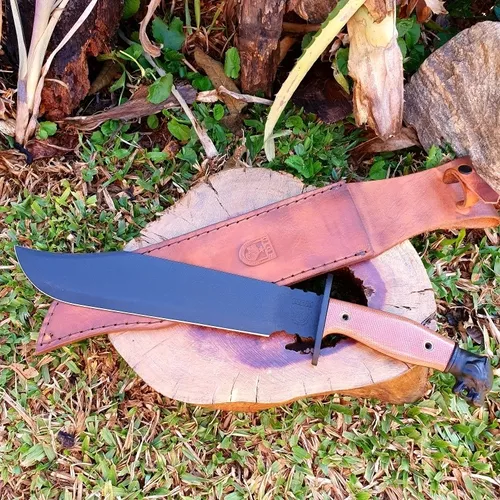

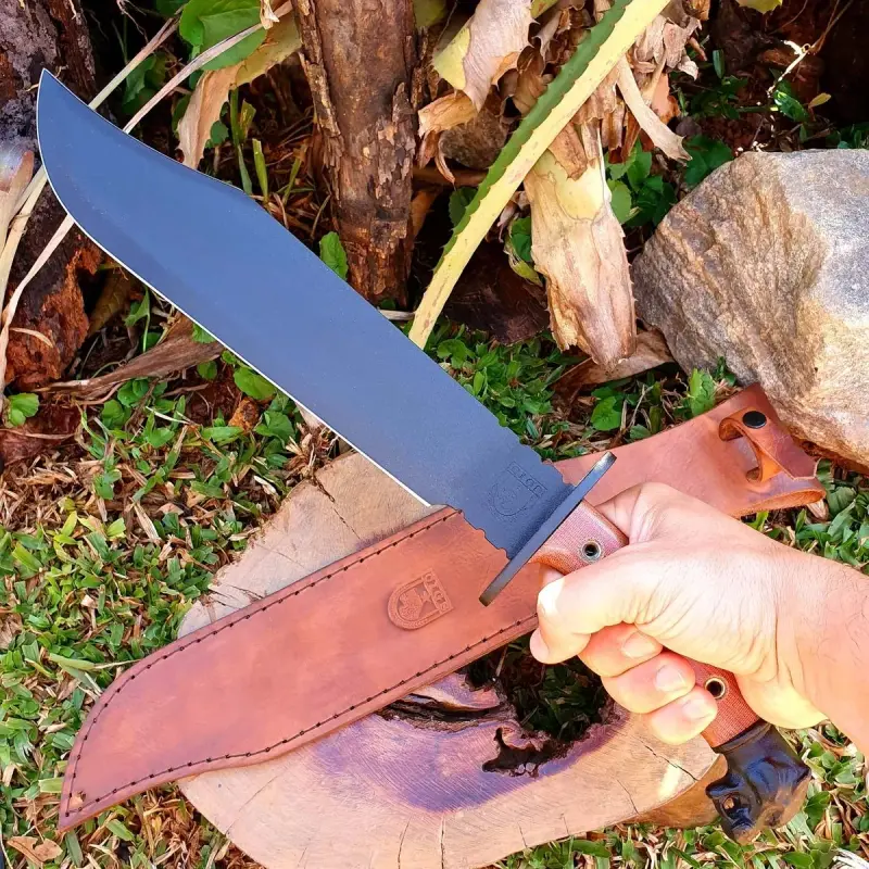

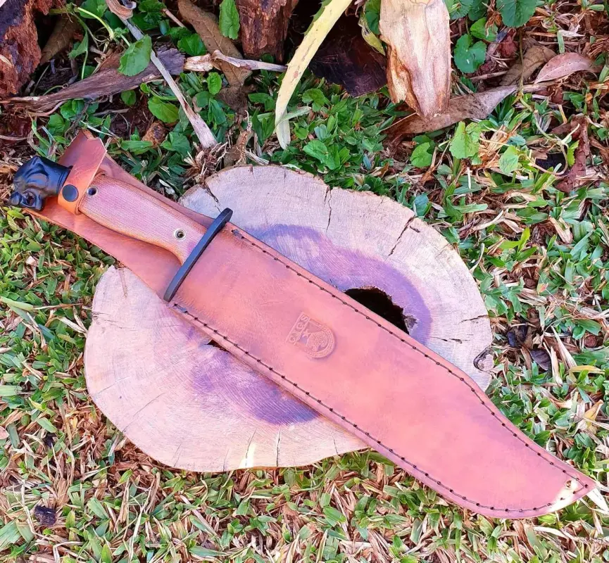

In Brazil, they are rarely found for sale. And when they are, they are expensive.Those are pretty cool.
Do you know what to search and where in order to find one , if they're actually available?
Or use Chicago screws (post screws).Consider using self-clinching fasteners instead! They're round and have an integrated serrated washer that keeps them from rotating. Then just either use a machine screw of correct length, or after cutting the ends you can use a deburring tool to chamfer the ends so they aren't sharp or crisp anymore.
