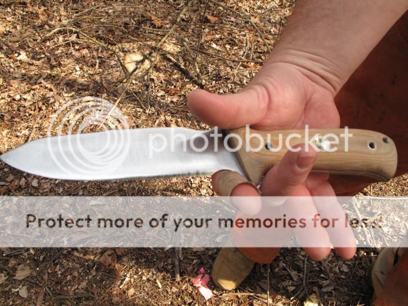

I realized that I never posted pics of my slightly altered form of Brian's SERE. Love the knife, suits my needs very well:
Use of choil:
Left hand assist push shaving- area of spine under my hand is slightly rounded to not cut my palm and batons- Area from spine choil to my hand is left sharp for scraping:
Use of spine choil for up cut:
Tapered slabs and pinch grip:
Showing where spine is rounded VS left sharp:
draw shave:
This knife may seem a bit bulky due to large/secure grip but it is a woods tool that I would feel secure in most any situation with.
