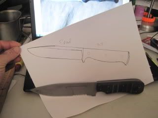

Just for fun I drew up a smaller hight wise and with a bit more belly maynard blade shap design with a what I feel is a better handle design.
The Maynard SERE knife was made from 1.5" tall metal and the one I drew specs out at 1.25" tall.
anyways, chat with you all later,
Bryan

Bryan, I am liking both blades. The green micarta is very cool. My favorite is the top one. I still like that one best. I also like the smaller version too. Good stuff.
JollyRoger3, thanks you might be a good contender for testing it out then.
The more I look at the smaller version I am liking it more and more. pair that up with a axe and or saw and what a great wood roaming combo it would make.

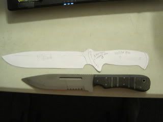

Calling Grunt Soldier, You mentioned a 7" version well here you go. It is only a drawing but in the next month or so it will be in steel. I did add just a bit more belly than what the Maynard blade has.
claymore, Since you mentioned the book by Col. Rowe I really need to get it and read it.
Bryan
I am liking the smaller one. I think in SEAR size matters if it too big it might be left behind.
Bryan
Really like the looks and the size of that one Bryan. Hope you build it and show us how it comes out.
Stop distracting Bryan with this SERE knife stuff and let him concentrate on other more important knives......Cough....Taiga !:devilish:

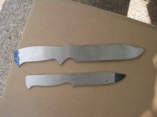

LOL, distractions!!!! You mean like this stuff?
Grunt soldier, asked about what one of the Maynard Blade shapes with the
slanted guard and handle with a birds beak pommel might look like.
Well here is what one looks like in a steel blank and then I did up a
smaller version of the knife I drew up in a steel blank also.
I love the 7" blade length. I got a little more shaping to do on it before finishing it up.

damn it I was gone for a minute and almost missed this. that looks great Bryan! I'll take it :) just let me know when she is ready to be beat on lol.
I love the design and shape. looks like it would make a great sere knife capable of handling pretty much any task thrown at it
Thanks Grunt Soldier,
I will be putting handles on that one this week. When I get it done I will post a pic of it.
